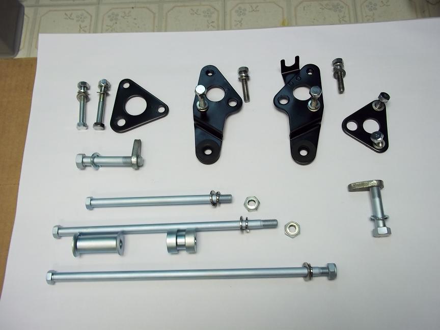

Hi, this is what you would like I presume?
I did this Z1 restoration about 2 years ago, for an ebay auction.
Got $100 from someone in Seattle
An old timer from an industrial chrome, plating business.
They are done! Retired. Gave up due to high co$t in NY State! And Gov. regulations.
But you have to soak in a phousphoric acid bath to rempve original zink,
then media blast them before they dip in fresh zinc coat. If they are not clean, they will contaminate the solution. I did the prep, it cost me coffee
Nickel would be nice also, that is alot more cost though.
Check with any chrome plating business.
