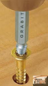

I have a grabit bits. They are ok but kinda cheap made. But will most likely work. Depends on type of screw and location you could take a die grinder and grind a flat notch in it then use a straight bit. Ive had to do that a few times before i got the best ever impact driver ive ever had, It takes out screws right away without trouble and ussally dont strip them. Its a craftsman 19.2v impact driver. Just one tip only use it while removing fastners. As far as the cleaning and polishing goes. Ive been polishing my engine, tho its out of the bike. Heres how i did it. First i sandblasted it with glass bead. Then i bought some of the big scratch pad type wheels that go in a drill or dremel. that will polish it up most of the way while removing most of the pitting. Then i touch up the needed areas with 180 grit sandpaper. Then 220 grit then finnally wet sand it with 800 grit then 1000 grit. Then finnally time to start buffing. First off i start by using white diamond polish sealant. Its a courser grit polish. It removes most of the last sanding marks. Then i clean it all off and use brakecleen to remove the residue then grab another buff wheel and go over it with some mothers mag and aluminum polish. Gives it a great polished shine. You could read off it its so shiney. Of course the more you sand the better itll shine. Ill post a couple pics in a few of how it turns out.

KD, try to grab the sides of the screw with good pliers, or cut a slot in them and use a flat head.

If using the self-back-biting type extractor bit in a hand-held impact driver, would first use a propane torch to heat the screw throughout it's entire length, and then be relatively gentle when hitting the impact driver so as not to demolish the screw-head.
By so heating, the screw will conduct heat to expand the surrounding female aluminum threads (which will expand more than the male steel screw threads), to hopefully relax the aluminum's grip onto the screw.
Heat should also break the hold of any locktite that might be on the threads.
