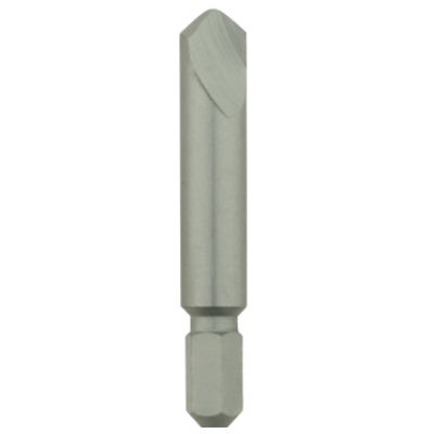

Extractor tips are available that are designed to bite into the wallowed out hole of the screw head when the tip is pressed into the wallowed out hole and turned out counter-clockwise.
Sears and other stores carry a selection of tools and bits for affording a grip onto rounded off nuts and bolt heads and onto wallowed out screw heads.
Some may look like this

09 Dec 2012 00:43Patton wrote: Extractor tips are available that are designed to bite into the wallowed out hole of the screw head when the tip is pressed into the wallowed out hole and turned out counter-clockwise.
Thanks. I'll try to find one. They closed the sears by my home.
