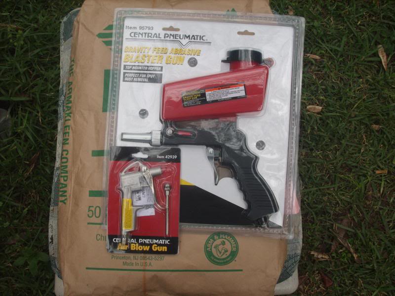

Re: Anybody Tried the "Speed Blaster"?
18 May 2012 10:04

- Topper
- Posts: 1609
- Thanks: 133
18 May 2012 10:15
Oooh... shiny!
Did you pull the carbs off? I'm a little worried what the soda will do to the holders and boots.

- Kidkawie
- I bleed premix
- Posts: 1924
- Thanks: 246
18 May 2012 11:42 - 18 May 2012 11:43Topper wrote: Oooh... shiny!
My soda blaster is only 1/2 or 3/8 tubing so you can pin point where you aim it. It's not like a fire extinguisher. lol
I sealed up the top of the airbox or any opening. It will remove some paint, so watch your frame. But you don't need to mask every single thing. Like Medina said, you'll have to wash the crap out of your bike when you're done, all in between the fins and crap. I found some a few weeks later in the header collector. lol
You can do complete wheels too. I did a bunch of MX wheels, but my Z1 rear hub is polished so no soda for that.
