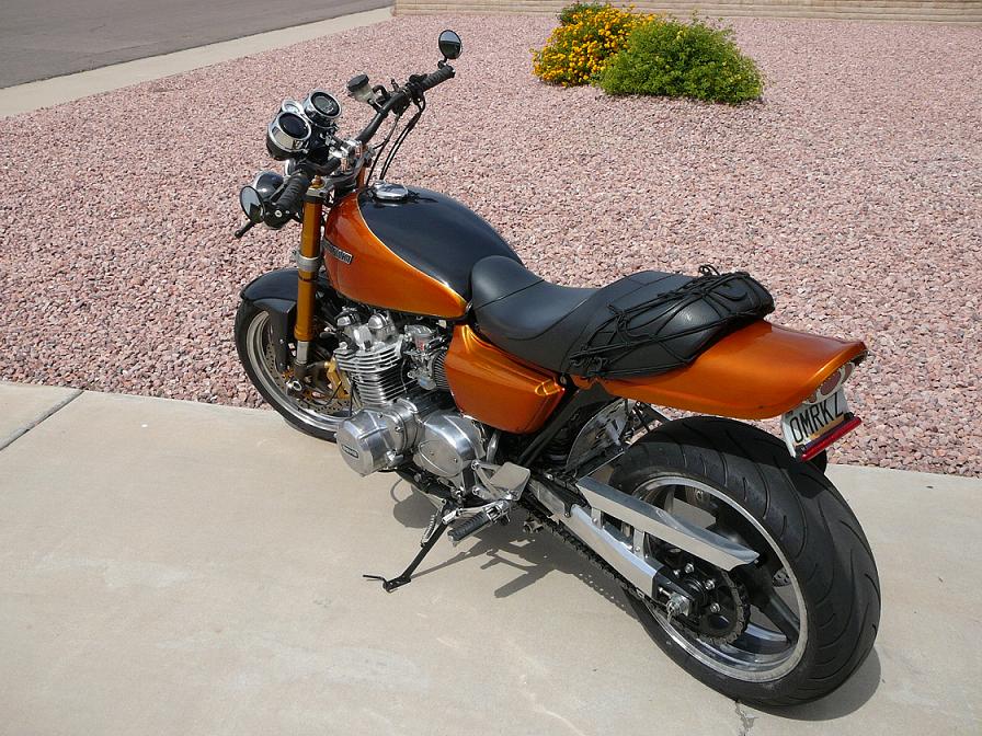

For Tank & Plastic Painting:
Here's what I followed using can paint and 2-part clear coats.... Works like a charm every time....

2 or 3 part Clear coat protects the paint (gas)...
Used can paint on my tank, still holding up 3 years later... And yes, I have spilled gas on it a time or two while filling her up... :pinch:

Looks great OMR! Like OMR said you can use can rattle can but finish it off with 2 part urethane clear so it will be protected from fuel spills. You will need to purchase an aerosol sprayer in order to do this. Home Depot has it for about $15.00. Just look at OMR's instructions on the links he gave you. Although I only painted parts (head shell, triple tree, gauges, etc) and not my body parts, I followed OMR's instructions he posted in the file base and got awesome results. Good luck.

Holly crap Kid... That came out just plain gorgeous!...
