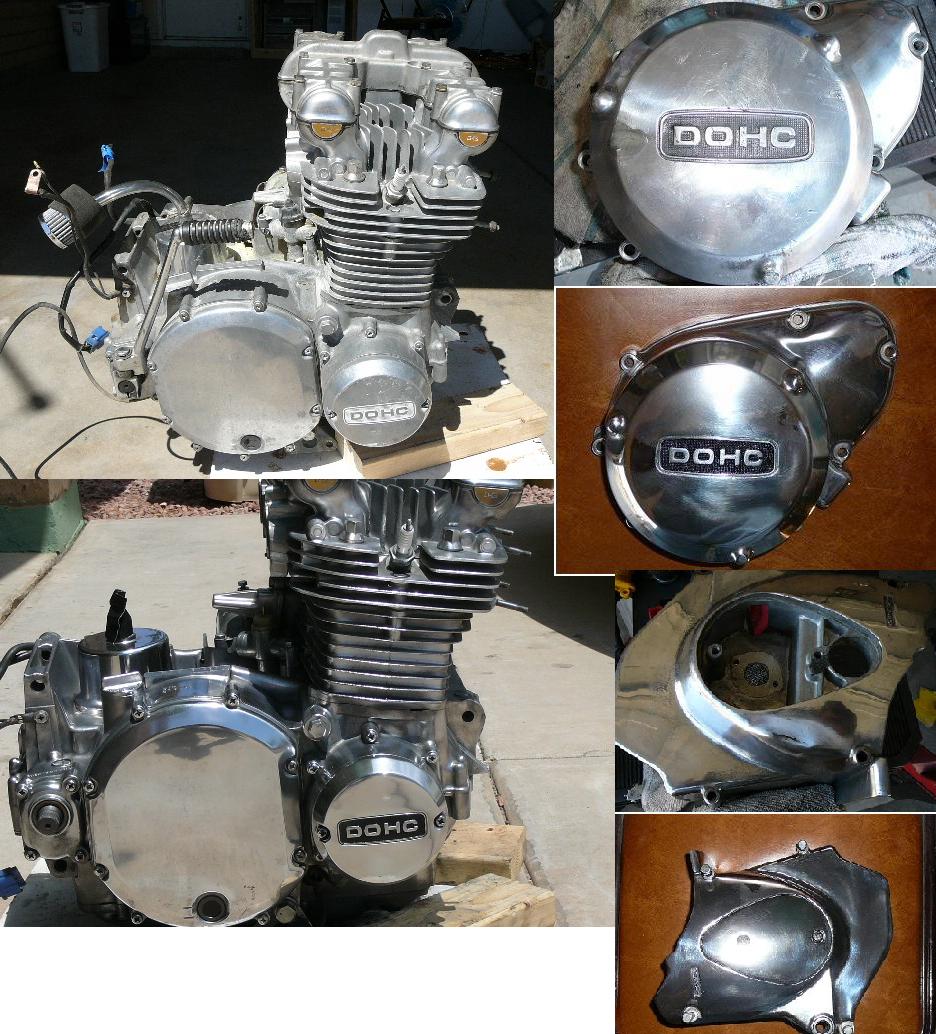

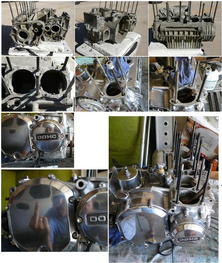

I started a rebuild project last July and have tried to polish most of the aluminum pieces I could. I did my engine covers, various parts, and just finished my carb tops, bowls, and also my forks last week. I find it to be tiring work but very rewarding when it is all done. No pain, no gain I guess (and a few beers while your polishing doesn't hurt either as long as you are careful around the buffer). Plus, it gives me some needed garage time away from the little devils (3 and 4 year olds).
I have used my dremel tool with buffing attachments for tight spots in polishing, but if you want to save a lot of time, get yourself a bench buffer. I picked one up from Harbor Freight for $39.99.
I have always used the aircraft remover for the old clear coat, wet sand with fine grit, the black, then the white polishing compound.
I'm sure the red would work just fine too. I had some pretty bad looking aluminum pieces to fix though, so that is why I used the black first.
