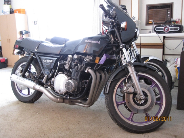

If you go to the gallery kz1000 sec page 102 image 1528 titled hibernation there is a good pic of my kerker header after 20 years of riding with a jethot coating. you can get black too.
