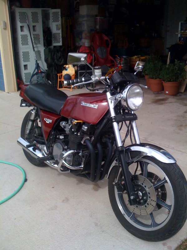

Back to the fender questions and comments. I only said that I like the look of no fender. I realize that it is not safe nor good for the rain(I ride my full dressed police Kz in the bad weather). I have the original chrome one and another in the process of being cut down as a shorty. I will post the bike with the original soon so everyone will comment on other aspects.
If I change my mind and go with a fiberglass fender will I still have a problem with flex as if having no fender? Will I need to brace the fender over the fiberglass?
Here is a before pic of the fender for the bike!

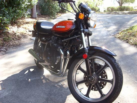

KZ-RAGE
Nice shafty!
Did you cut down that fender?
It looks like the original only a bit shorter. How did you prep for paint?
It seems we have the same ideas about how these bikes should look.
Good job!!!!!!!!!

Thanks! I got the idea from a friend that showed me how to do it the easy way. Used a stick-on grinder sanding pad as the guide. I think it was a 5" or 6" but not so sure now, anyway stuck it on the fender back about 4-5" from the end and then used it as a template to mark the fender as to where to cut. This gives you a nice radius to follow and keeps it even side to side. Took a cutoff wheel and followed the mark around the fender. Did this on both ends, afterward just hit the cut-off ends against a belt grinder to smooth up the edge.
I used a very fine grit sandblasting booth to rough up the chrome to the point it looked like dull aluminum mostly with some copper/nickel showing then had my paint buddy shoot it with etching primer, the paint is a GM black automotive with clear coat. Has held up just fine now for 4 years.
I have a couple of stock ST front fenders in the shop that I can measure compared to the one on the bike to give you the exacts on the cut-off lengths if you like, just let me know. (I'll be out of town until next Wednesday though).
As for using a fiberglass fender, I don't see why not but adding a fork brace would be wise if you ride'em like I do through the twisties!The stock fender adds some stiffness to the forks but it is just stamped metal so a brace would really firm it up. I'm working with another bud on having him machine up a custom fork brace for mine this summer, I'll post something about it when that gets going.
Oh and if you want to see a massive improvement in the bikes brakes get a set of Hel SS brake lines, biggest single improvement in the bike that I've ever made!

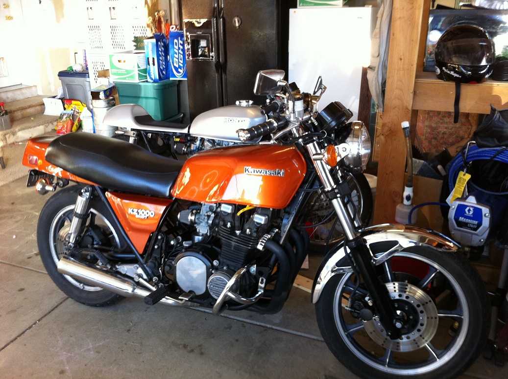

25 May 2011 18:24 - 25 May 2011 18:28Imo, the fiberglass fender will offer relatively little front end stability in comparison to a stock steel fender.
Here's a version with the chrome fender painted, and repositioned slightly higher above the tire.

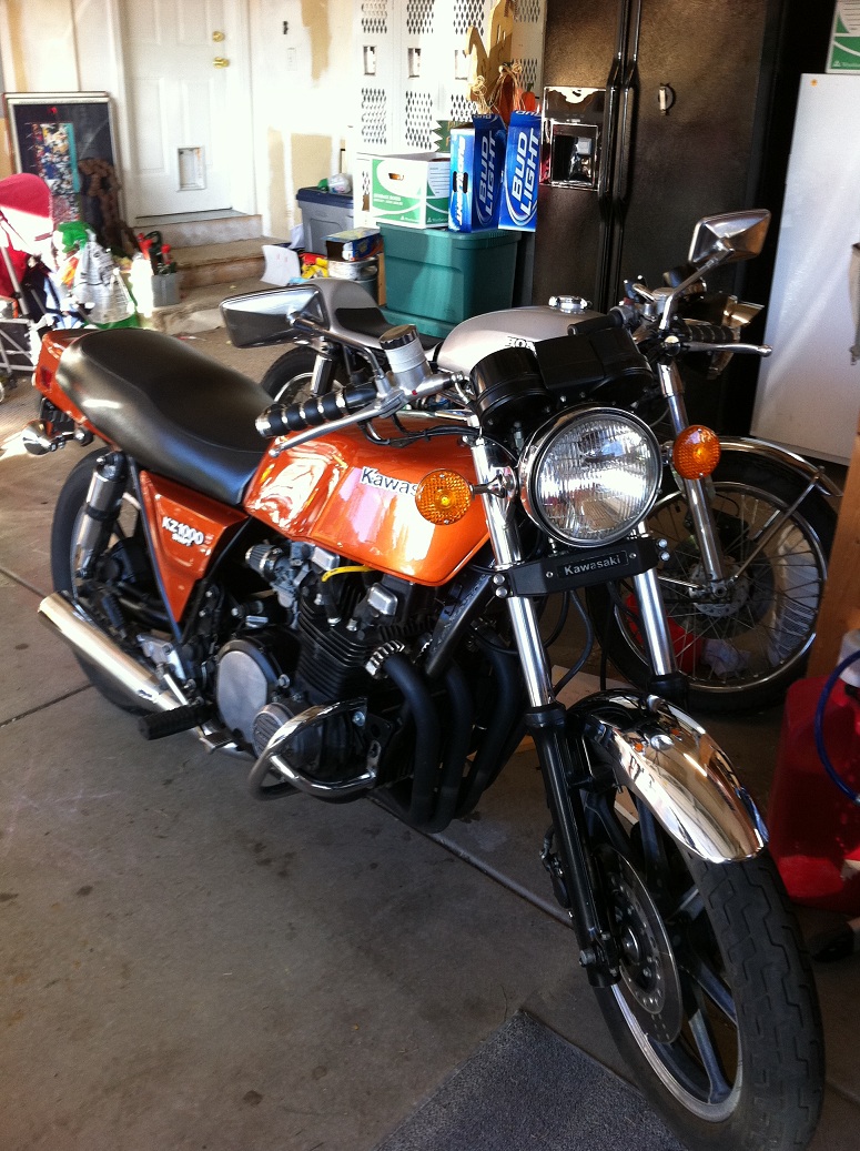

I put the original back on for now, but will be modifying my spare to be smaller and black or even the body color like a Z1R.
Here is a couple of pictures.

What do the masses think of the case savers. Should they stay or go? I have never dropped a street bike,but know its going to happen sometime. I am not saying that I am perfect. I am truly far from but I have been riding street and motocross for twenty years and have save the many(hundreds) wipe-outs to dirt.I am either very lucky or stupid for thinking I may not crash on pavement!

they serve a good purpose.
but they do look bulky.
thats my .02,

your bike looks great with the new paint!!! and i like the chrome front fender also....
