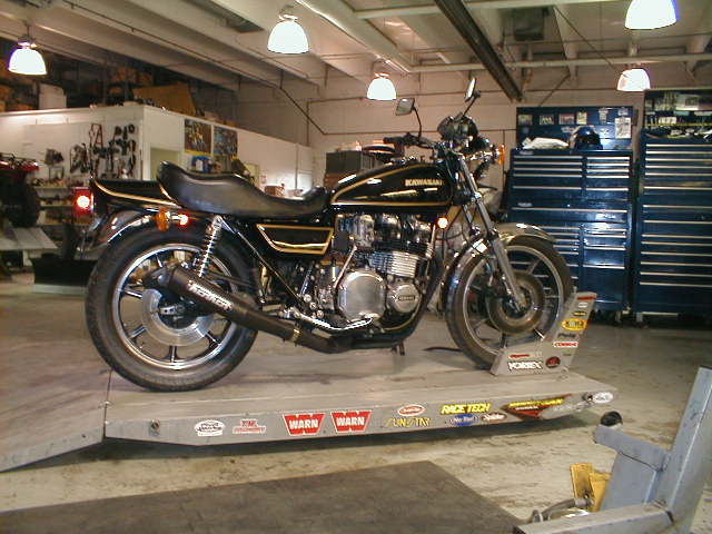

Getting restoration going on my black 80 model A4.
Trying to decide on the gold pinstripe or not.
It's not completely original. Superbike bars and Kerker header main difference.
I like the look of the pinstripe, but also think it would look good plain black.
Thoughts?

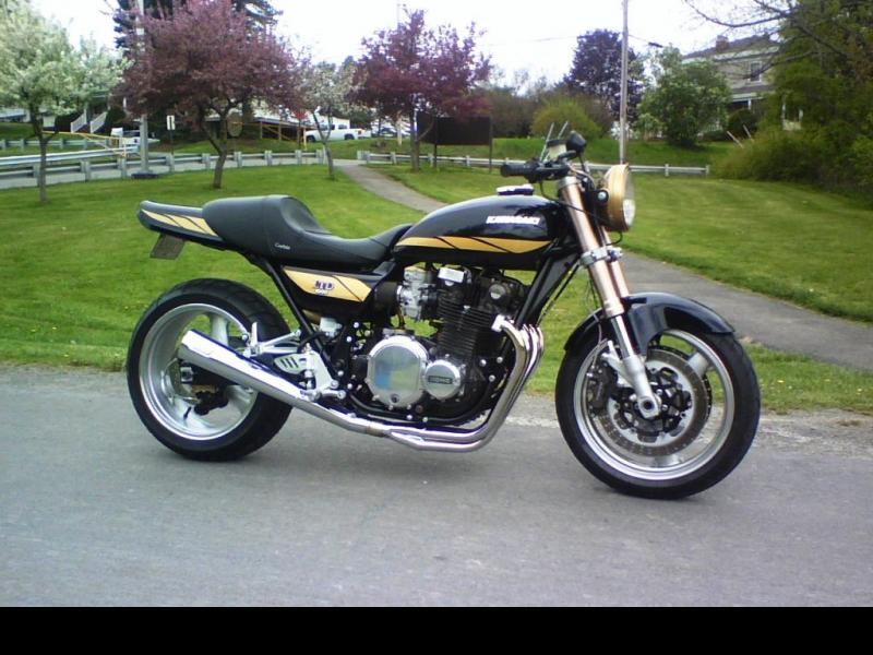

Like Ron & Leon, feel that the gold pinstripe is the icing on the cake... 3M offers a pinstripe tape labled as 3M Scotchcal (TM) in 25 & 50 ft rolls which is avail in Gold (love it) red, blue & silver. & possibly variations..... it's 2 stripes ( a major @ 2mm & a minor @ 1mm ) side by side with a common peel off base, and a clear (peel-off) top strip... The last time I purchaced the 50' roll was @ 23 bucks. This allows you to "mess up" or toy with whatever suits your' fancy, repeatedly.. just do your playing on "cured" paint.. I settled on a pretty close copy of stock. You might give it a try... After I've decided, I clear coat over stripes to keep "em intact" & from crawling.. Like most endevours it requires some practice to achieve 1, consistancy, & 2 smooth lines in tight radius bends. I've used "activated" Polyeurathane clears over a variety of bases, & (knock wood) have yet to have em fight. If you try, play w/ samples 1st, you never know, "paint"s pricy, & prep work sucks. luck g
[img][/img] 1977 KZ1000A1

is that your bike gane?
wowzers :woohoo: !
that thing is perfect,i really like this bike.

Thank-you Leon, Yes, this is a pic before the Ohlines & GS swingarm. asside from your' spacers & the boring of cyls it's all my work. nothing special, but everything works well & gives me a lot of pleasure. G

gane,it makes me very happy to have a small part in helping you get that bike the way that you want it.
i would like to see a pic with the shocks and swinger on it.
very well done,you should be proud.
