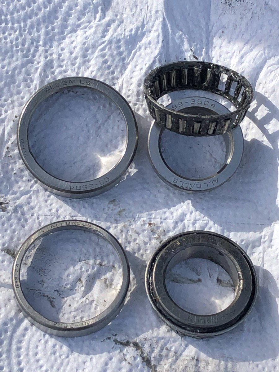

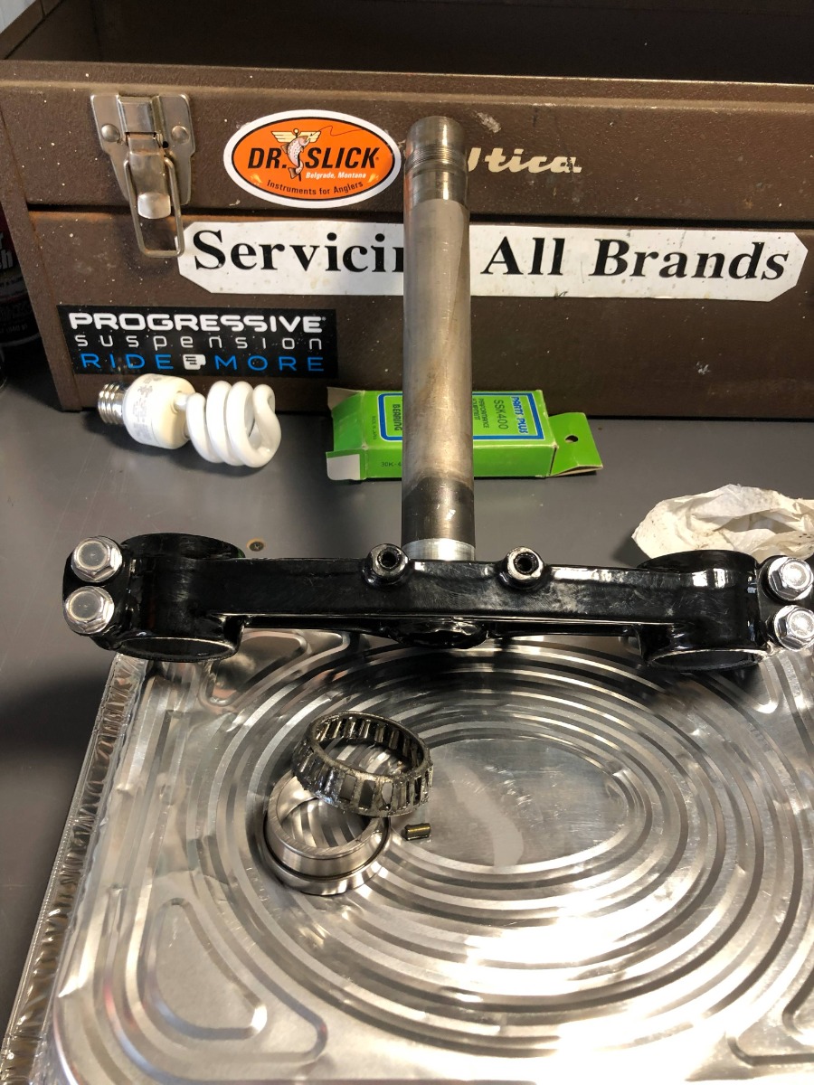

Disassembled the steering stem assembly and found the the lower All Ball outer race cage separated as shown. The top All Ball bearing (Lt) is not damaged and spins smooth. I installed both Upper & Lower All Ball bearing and it was not in this condition when assembled. During the disassembly process, I checked for steering stem movement with the front wheel installed and later with just the forks installed in the triple tree. I did not feel any movement. Have removed the lower All Ball bearing from the steering stem and awaiting a couple of parts from Partszilla.
1981 KZ550 D1
Last edit: 31 Dec 2025 16:38 by srsupertrap.
- Posts: 6640
- Thanks: 4191
Re: 1981 GPz550 Steering Stem Tapered Needle Bearings Source 2025?
31 Dec 2025 18:45
If the bearings weren’t adjusted correctly then a bumpy road would have a “jack hammer” effect on the lower bearing which would break the cage

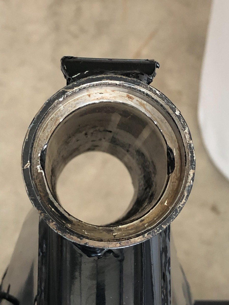

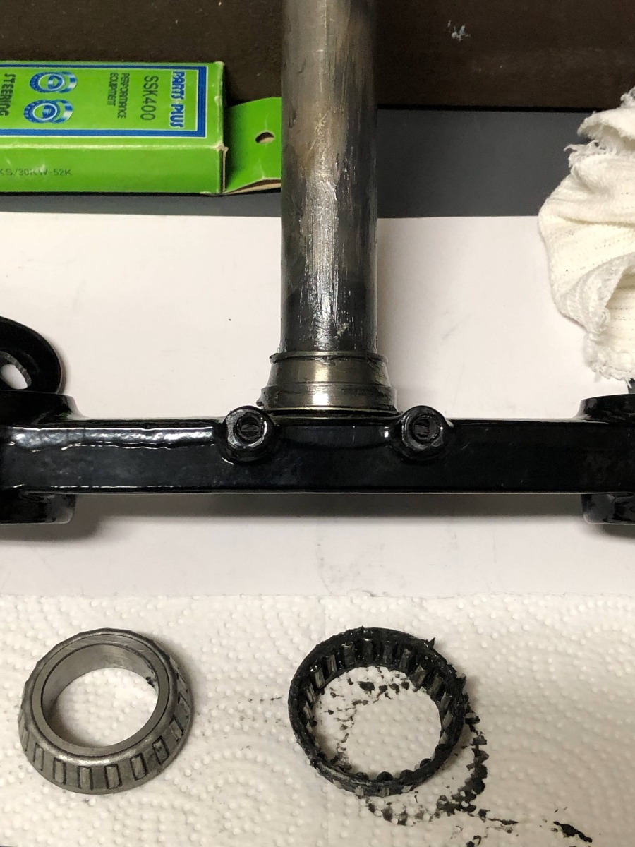

No one asked but I was actually questioning if I forgot to install All Ball bearing upper & lower races back in 2013. If I had left the stock Kawasaki ball bearing races installed and just installed All Bearing Needle Bearings that would explain why the lower All Ball bearing cage separated. This Saturday I removed the steering stem upper & lower races with the trusty Dremel, drift and hammer. Both races removed were marked All Ball Bearing. All the parts were All Ball bearing components.
Why did the lower Bearing race cage separate/fail? I am sorta stumped. If the lower bearing cage was damaged during install I would have noticed the roller cage had separated. The All Ball upper & lower races were fully seated and square in the frame. I have installed many bearings and like you know the mechanical sound of metal contact. During the 2013 assembly, I tightened and snugged the steering stem nut with a 5" spanner wrench, not with a torque wrench and spanner socket. Once the GPz 550 was road worthy, I was not practicing wheelies and it was not ridden on bumpy or construction dirt road.
Here is a photo of the steering stem notches I made to ease disassembly next time.
Next weekend reassembly.

I’m confused, are you saying you installed taper inners to “ball race” outers ????
- srsupertrap
- Posts: 49
- Thanks: 13
12 Jan 2026 05:04
I was stating another possibility that could result in the lower bearing failure. The pictures show all the removed inner & outer bearings were All Ball marked parts. So much for that theory
1981 KZ550 D1
- Posts: 6640
- Thanks: 4191
12 Jan 2026 05:12
So as previously mentioned, if there is play in the bearings every bump in the road will hammer the bearing rollers against their "stop". I guess 12 years of that was enough for it hence the broken cage. To be honest these are simple parts that either "work" or they "don't" in this application I would expect them to last a very long time if adjusted correctly (cars use this set up for wheel bearings and go for years without issue)
