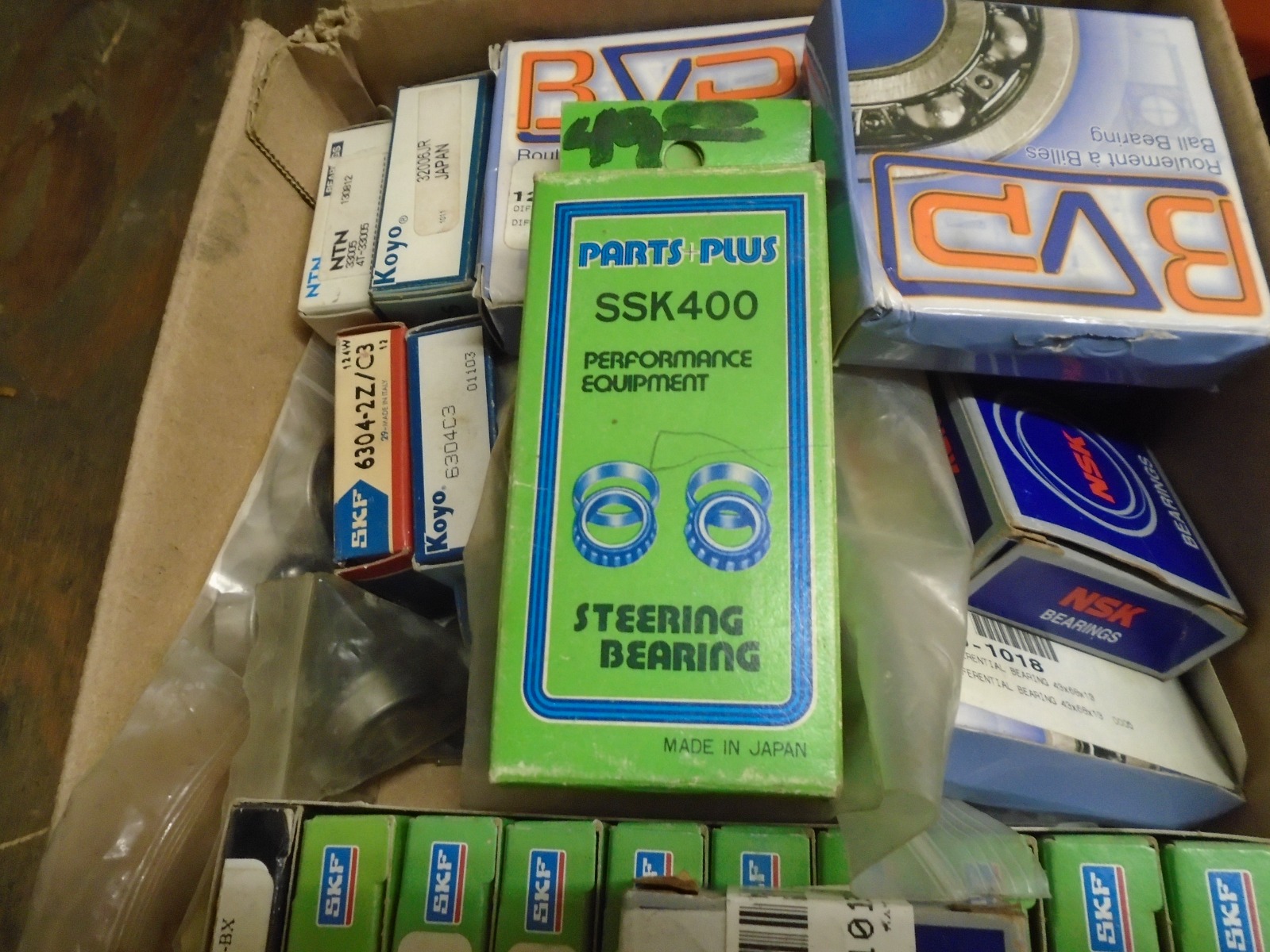

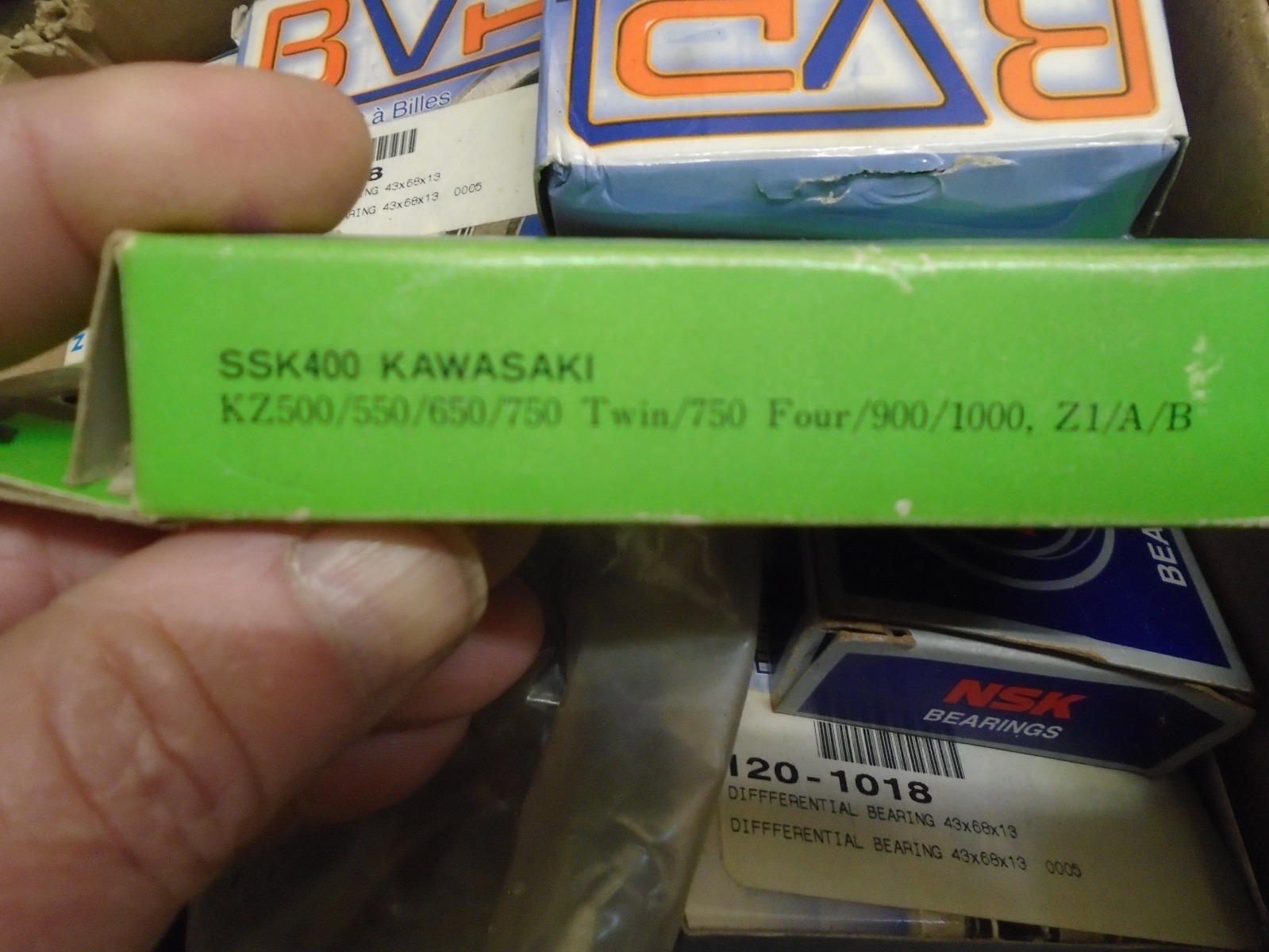

I've never used them on a 550, only the Z1/KZ. Note the photo print of application on the SSK package. But all the aftermarket tapered bearings resulted in a slightly taller stacked height resulting in sloppy headlight ears, have to shim them Not removal of any material. But don't think your 550 has such arrangement? You might have a bracket, don't know would have to look that one up.
