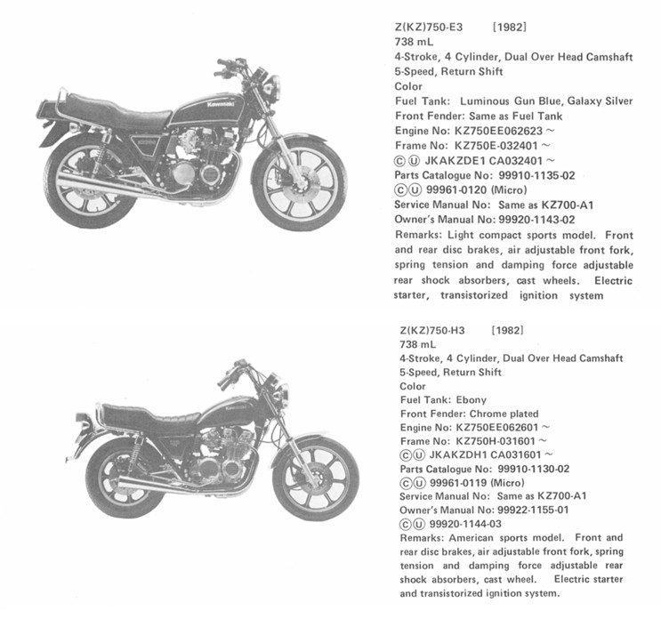

16 Aug 2025 14:02 - 16 Aug 2025 14:06Is this for the bike in your avatar (looks like a "KZ750H" not an "E" as per the thread title ? I believe somebody else here put an "E" tank on a "H" but if I remember it wasn't straightforward (had to change the triples etc as the forks were hitting the "E" tank)with how bad the inside is, im thinking that that wouldnt work

The identifier would be the vin correct?

16 Aug 2025 14:35Indeed it wouldThe identifier would be the vin correct?

Well then all the guns on the bike say KZ750E

16 Aug 2025 14:50Not trying to be a dick, just trying to help you so you don't order/buy parts for the wrong bike (your signature says it's a Ltd)Well then all the guns on the bike say KZ750E

The H3 in the pics is what I have, I'm just really confused then, thank you

This may be a needless question, but are you looking at the engine number and not the frame number on the steering neck?

if it's a 750H Ltd. then any of those should physically fit. 1980-83. plus the 81-83 650H CSR which have the same frame. caution: pay attention to the location of the petcock bung. on some tanks it's more rearward. if not the same as yours, the petcock may contact the carburetor. possible fix for that is a different petcock or fuel valve. one that's more squat. yamaha has some. but then petcock bolt hole spacing is another consideration.

LTD tanks are way easier to find than E tanks. The confusion comes in though, because Kawasaki made N models, F models, H, and maybe others that were basically LTD type. I'm not sure, but I suspect some are similar, but how to know? And what I mean, are some mount the same, have the petcock in the same place, but again, how to know?
