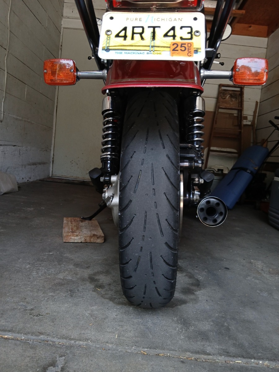

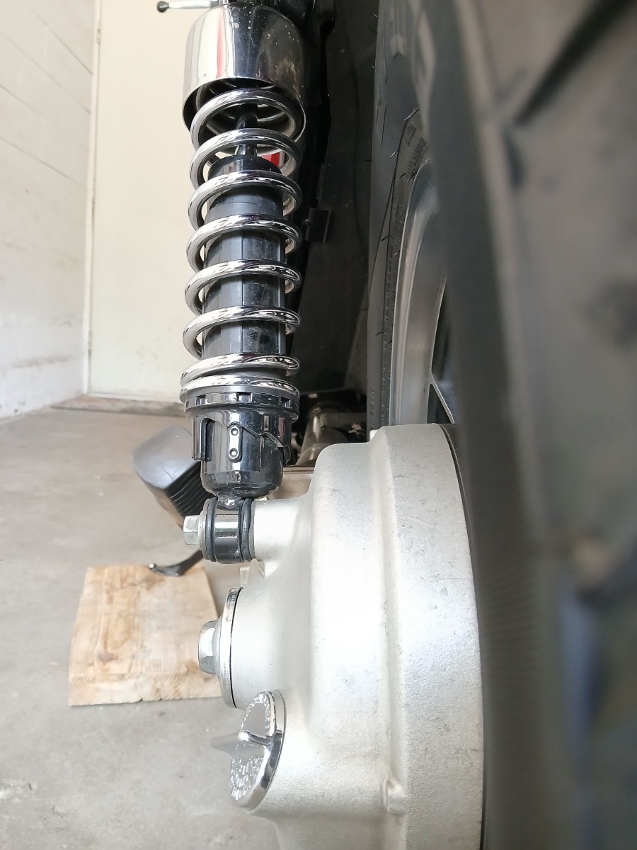

Received the 2820's...two problems: 1) From talking with Hagon sales & tech peeps (great people), one of the shocks had a defective dampening adjuster, it was only supposed to rotate ~3.25 turns lock-to-lock, and this one rotated 5+ turns.
The second issue was that the 2820 design is kinda upside-down, in that the spring is down low on the shock, with the unsprung length on the top. This in itself created an interference with the chain guard on the left side, pushing it into contact with the chain. And these shocks were the recommended p/n’s from their ordering spec pages.
Long story short, Hagon sent me a new set of 2820 shocks gratis, and these were built in a "custom" style that they had done previously in some cases i.e. the non-spring area was on the bottom, with the adjuster on top, and they fit perfectly. Prior to deciding to do this, the person that was helping me at Hagon (Dave D.) sent me a photo of the custom 2820 style installed on an H2 (he also owns an H2...cool!).
So that's it, just a little shock saga and props for a suspension company that stands behind their product and application specs. Cheers.

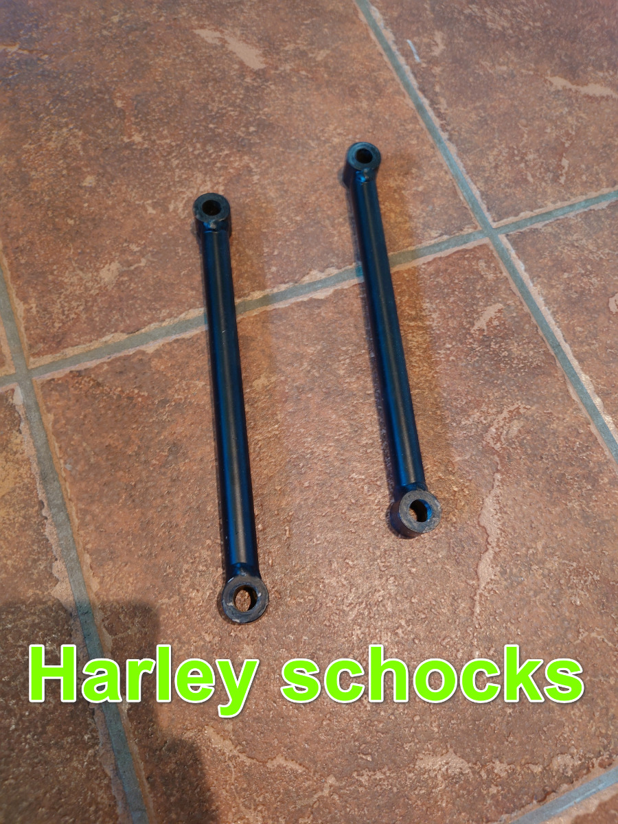

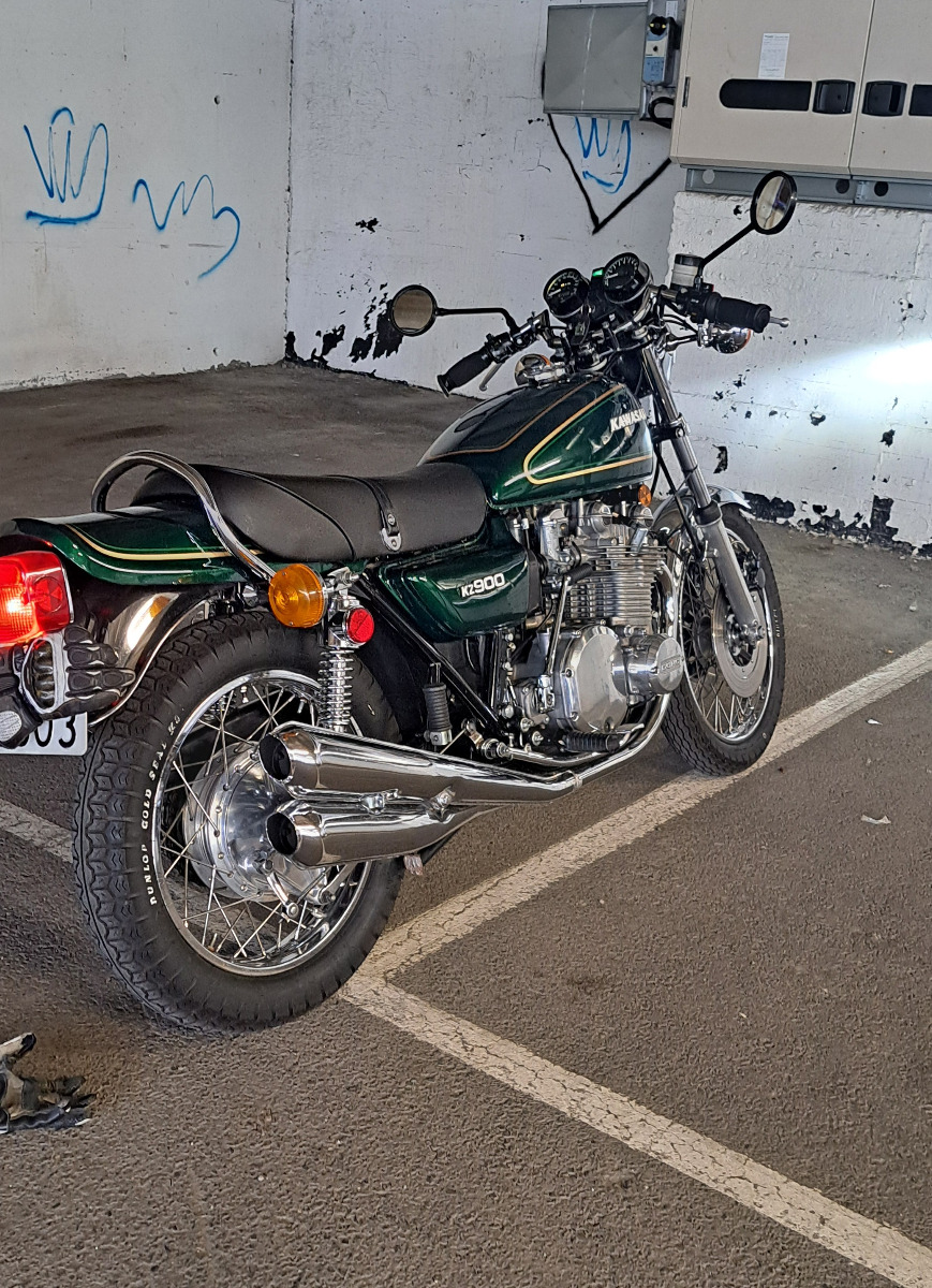

I installed these "Z1" "shocks" bought in UK .I think there is something wrong with them they are stiff as solid steelrods. I might as well install the harley shocks i found for sale look at last picture!.
It is said that they will soften up after 1000 miles ,but mine are still like solid steelrods . My yamaha FJ1200 is like riding on soft pillows compared to the kawa. I have bad backpain after riding the kawa so
i have been experimenting by putting on some clubman handlebars to get the riding posistion more like on the FJ. also changed the forkoil to 5W to soften up things.It is better now no backpain after todays ride !!,but will try to find some Hagons or put the oem shocks back on.
