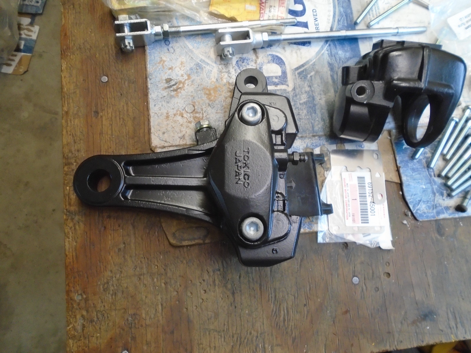

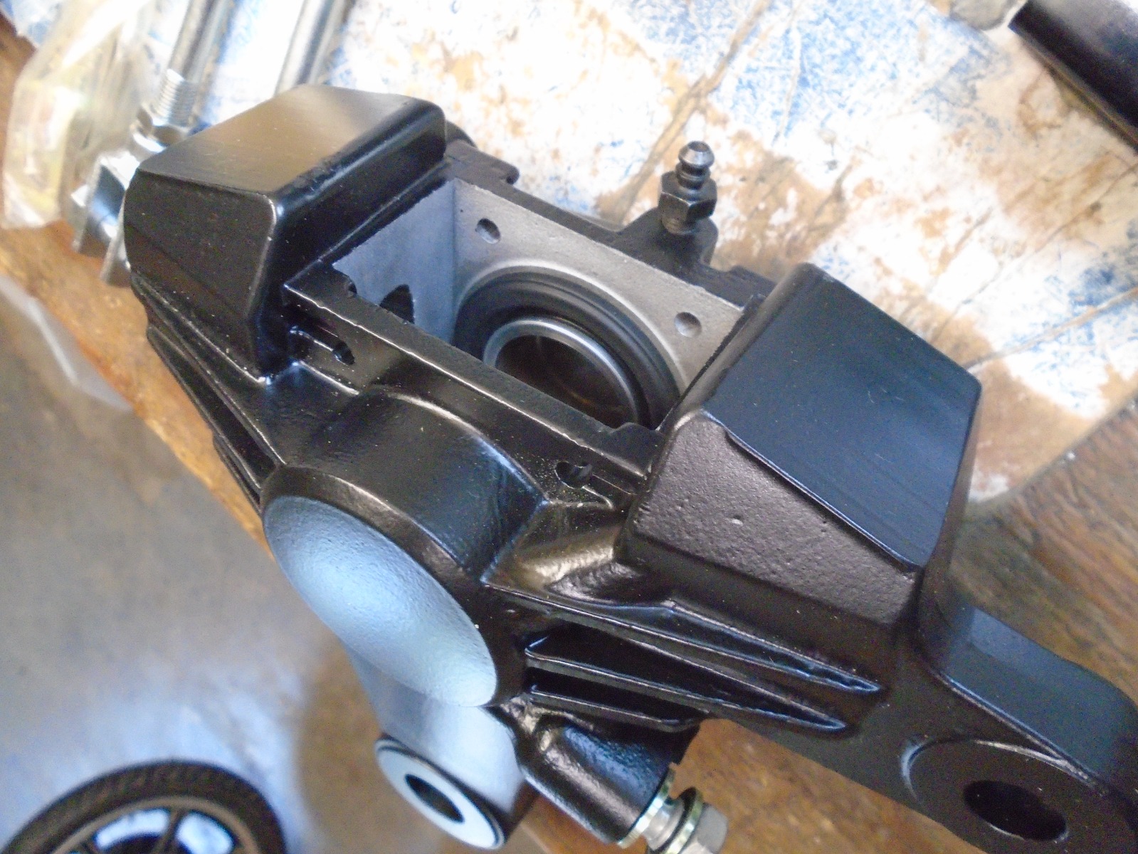

A couple pics. Here's the two different "styles" of Rear Calipers used on the 1977-78 KZ1000 models. Your Bigger style is for the A model and single piston style was slated for the B or LTD model. As Wookie mentioned Don't resort to grabbing the piston with vicegrips!! Another "subcategory" of the Bigger A model used phenolic inset pucks on the Z1R 1978 pistons, still 43mm diameter though but
didn't use the shim plates. Note in picture those "labeled Suzuki" pad shim plates X2. This is where Suzuki shared the same DNA with Kawasaki during this era. Kawasaki part number would be 43076-004 for this shim. Pins/pin retaining clips and brake pads interchanged too. Only thing that didn't was the flat "ring seal" between the halves, Suzuki was smaller.
