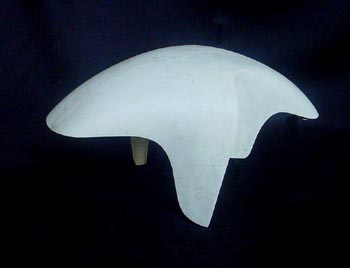

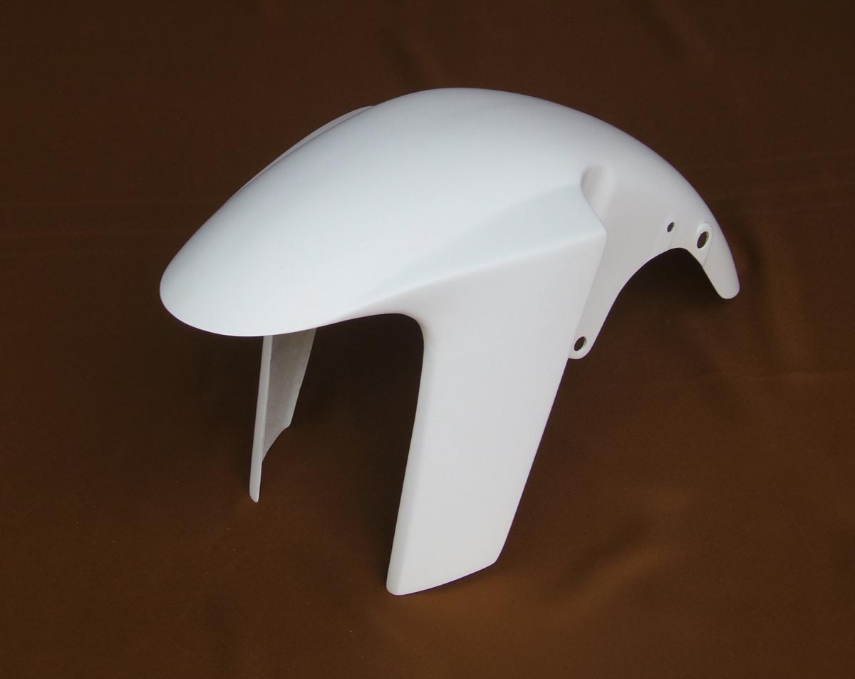

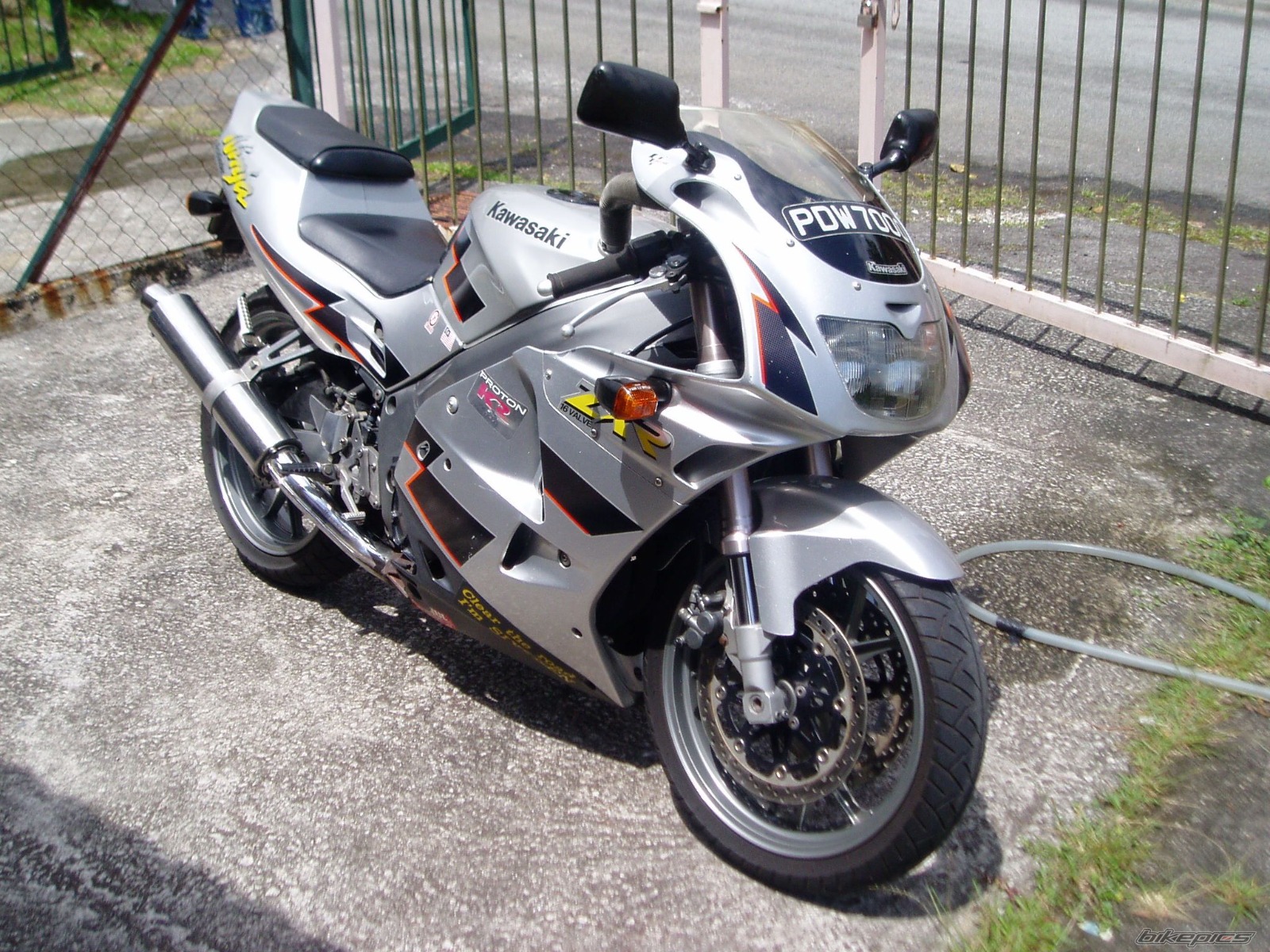

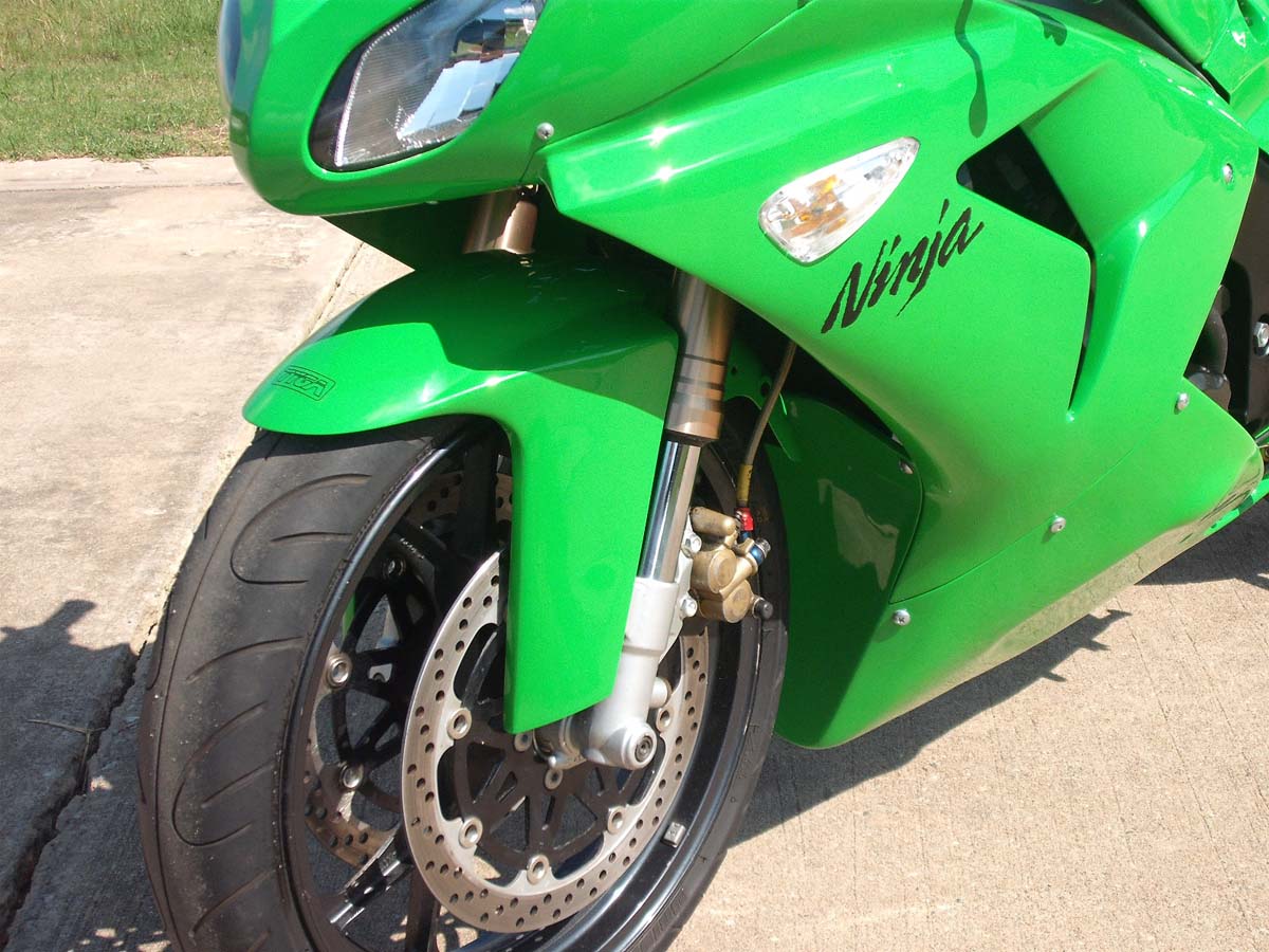

As some of you might know, I have been working on doing a USD fork conversion on my '90 Zephyr 550. I will spare you all the details here, but things are going well, and I've turned my attention to the front fender. I have found two fenders that I think will work great for the project, both are made by Tyga Performance. The only thing is, I can't decide which one I want to get!
Both fenders are designed for the ZXR250 which works for me because that bike has the same size front wheel and tire as my bike (I'm keeping the stock wheel in the conversion), and is designed for upside down forks. The two styles are a stock/original style ZXR250, and the other one is a "GP Ninja" style. Here's some photos:
Stock/original style ( tyga-performance.com/product_info.php?products_id=463 ):
"GP Ninja" style ( tyga-performance.com/product_info.php?products_id=1524 ):

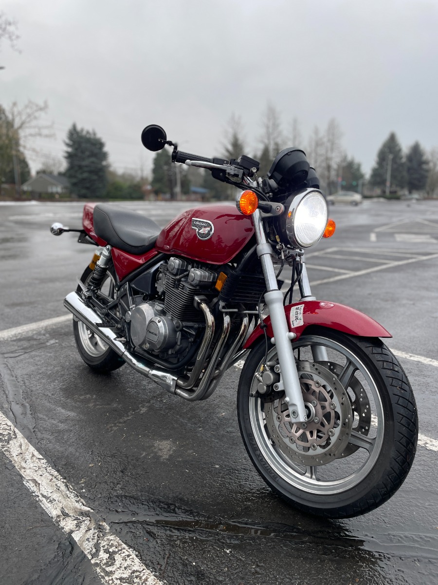

I tried to attach a poll to this post so you guys can vote. And here's a picture of the bike it's going on.

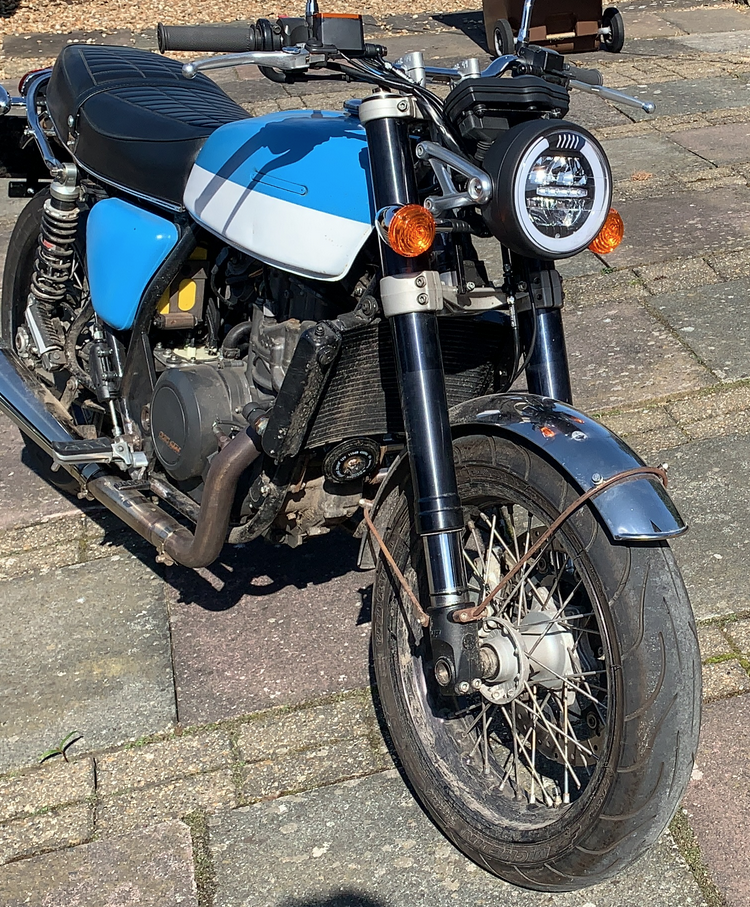

My 2 cents - i think those chunky fenders typically only look good on fully faired bikes. On a UJM they put too much visual mass on the front wheel without anything to balance it out. Why not come up with some custom mounts to reuse your OEM fender since you are using the OEM wheel? You can do some really slick mounts with some 1/4" bar/tube and some bushings. Either that or you need a 3/4 fairing.
not my bike but you get the idea.

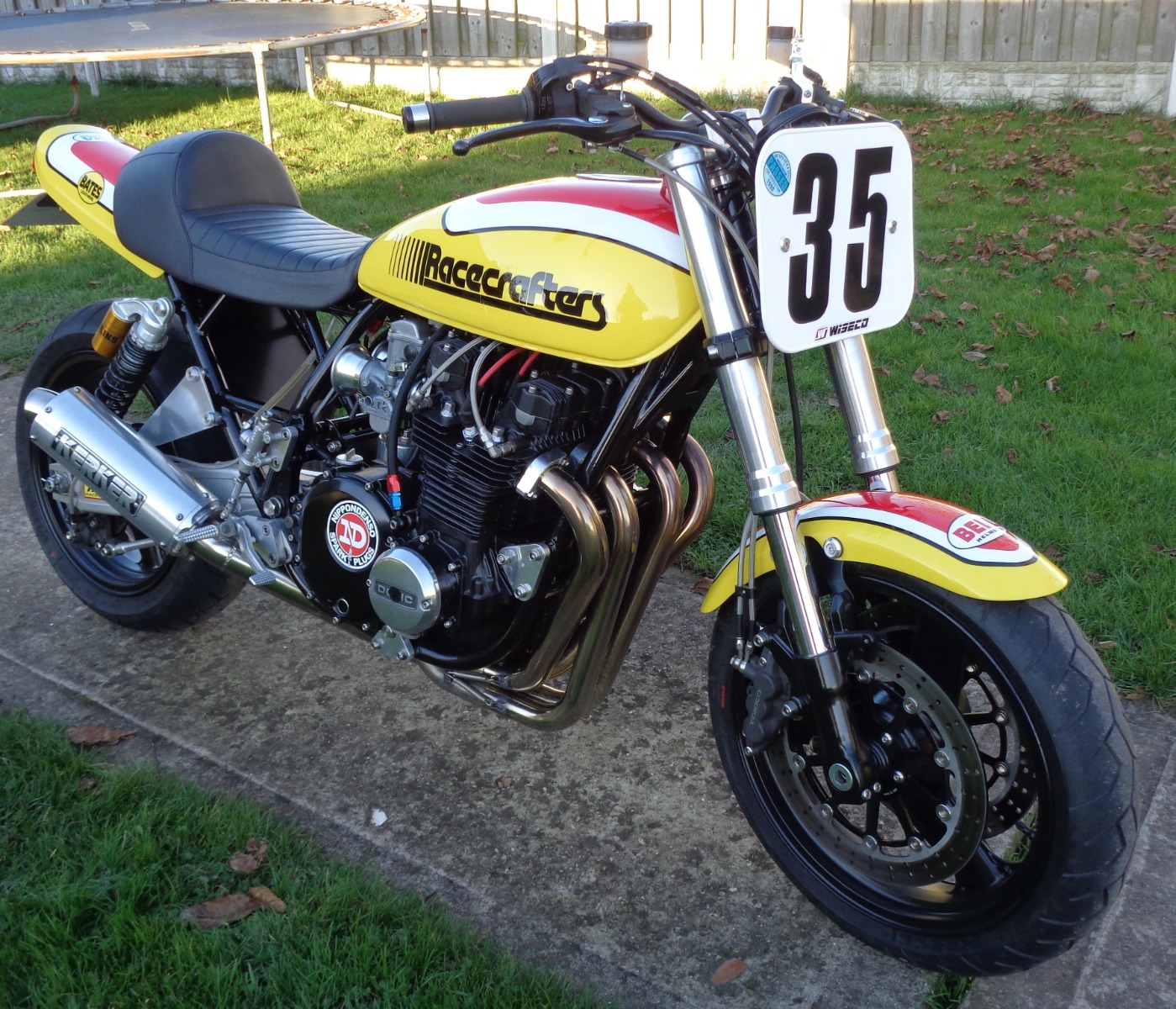

Some flat track style carbon guards for sliders and racecraft style guard as above gets my vote. i am going to try fab a real slim /minimal carbon guard i reckon.

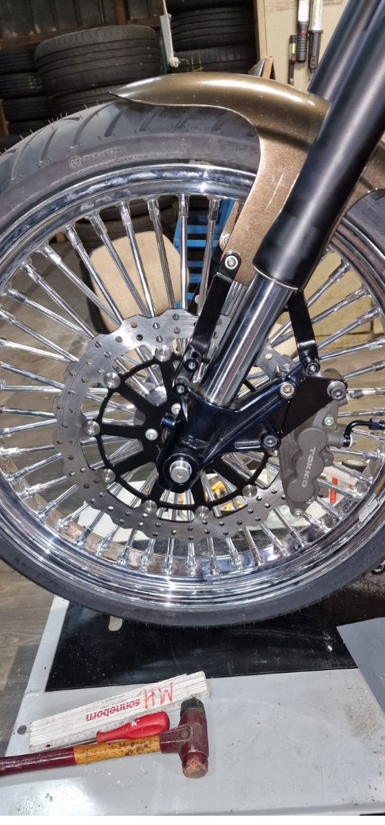

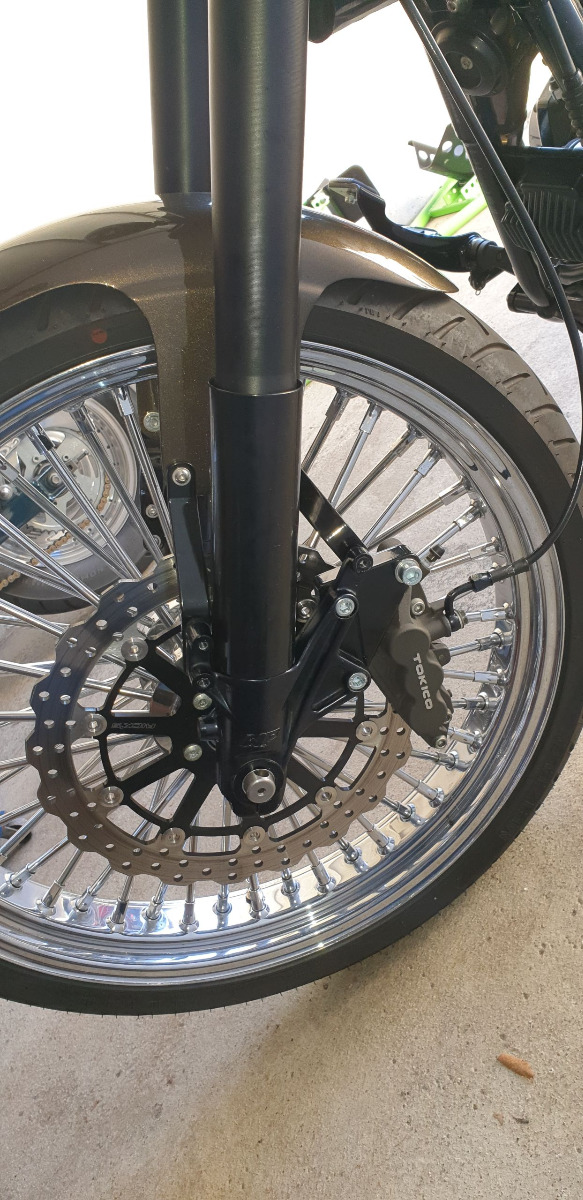

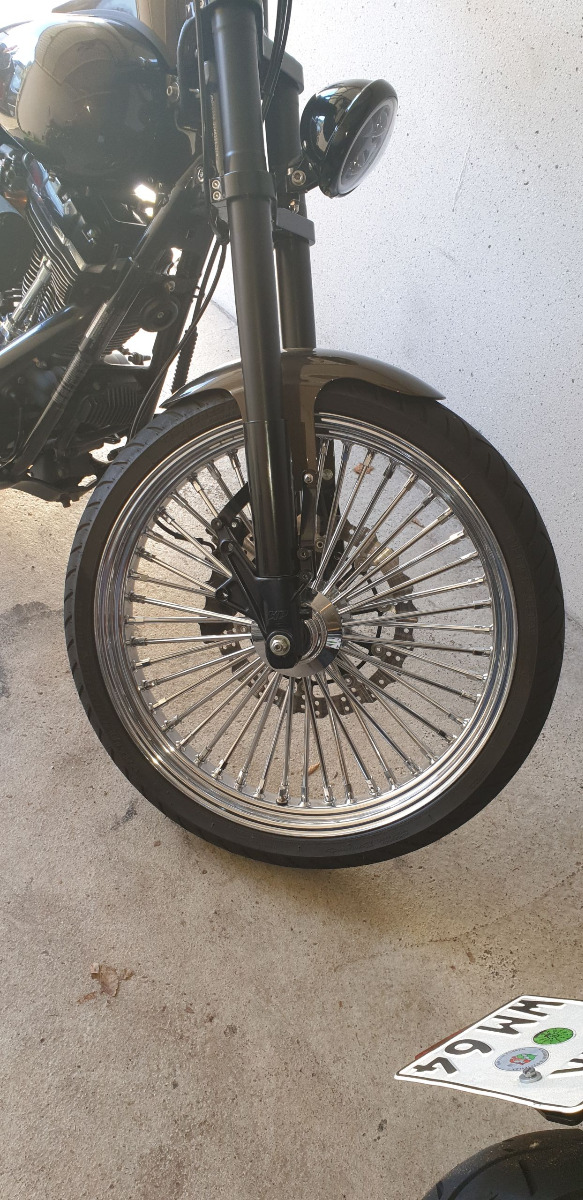

I made a press fit aluminum cover sleve for a friends Harley Dyna FXDWG with a KTM 640 Duke WP USD fork conversion i did last year..
The outer fork tube have a teflon tape slider in case of surface contact, works perfect. The sleeves have water drain holes on bottom site.
