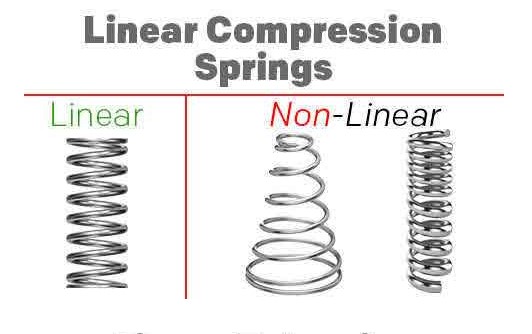

Re: 1977 kz1000a1 front fork rebuild
27 Feb 2025 03:25Hopefully the below helpsthank you sir !
What exactly are you referring to when you say “Linear Rate Springs” ?
Linear springs: equal size coils and equal spacing between coil so "rate" remains constant throughout spring compression
Progressive: Unequal size or spacing of coils so "rate" increases as the spring is compressed

27 Feb 2025 04:10
A liner spring absorbs energy at a constant rate per inch of compression. The formula is: energy = 1/2kx^2 where k is a constant for the spring in question and x is the spring displacement. A non-linear spring absorbs energy at a variable rate depending on how far the spring has already been compressed.
Shock absorbers or forks also include fluid to dampen any spring rebound when it is compressed. Most use oil. Usually the manufacturer will recommend a certain oil weight for best performance, but you can use lighter of heavier weights to vary the "stiffness" of the shock.
There is a third factor, which is the weight being applied to the shock, but I won't get into that, as it normally doesn't change much unless different sized riders are using the bike.
