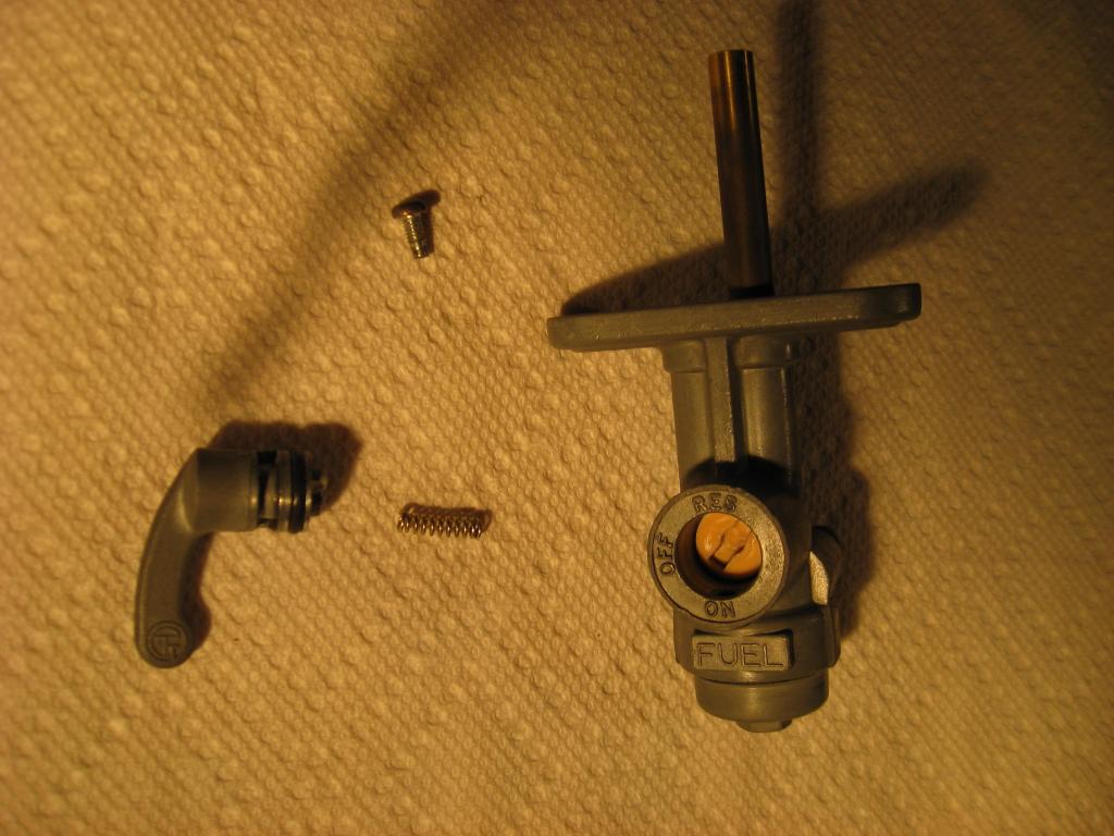

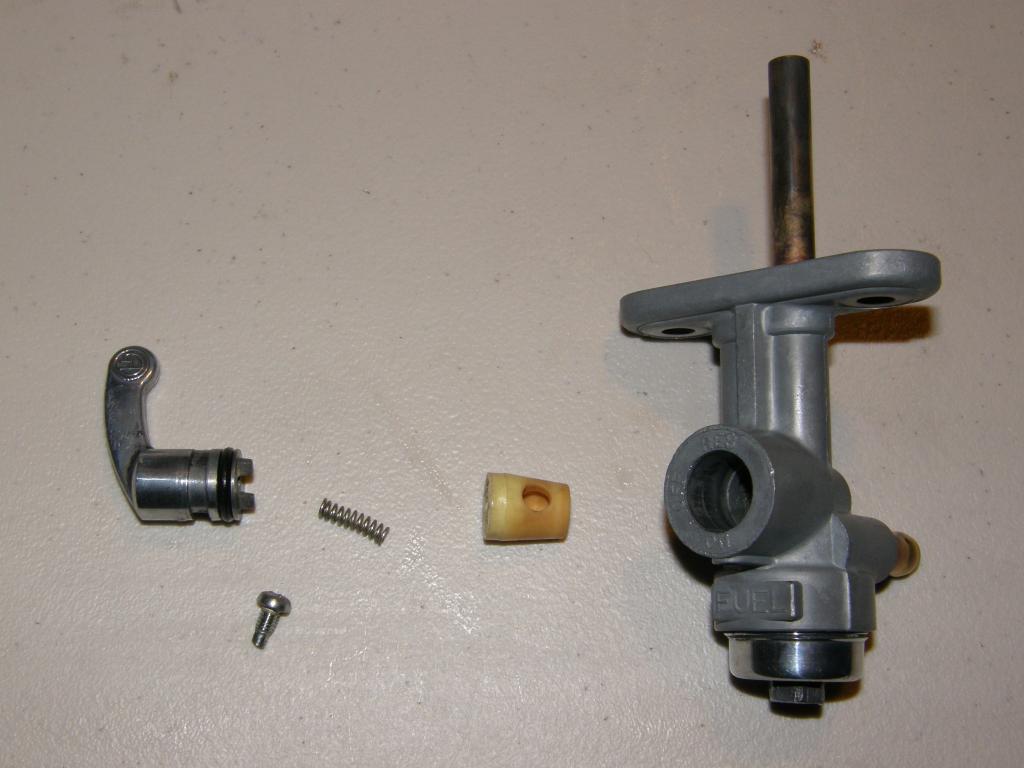

Yes there is an o-ring on it and a set screw to locate it and allow for movement.
The pics I have are for a some what like petcock from a 77 KZ650 which shows these.

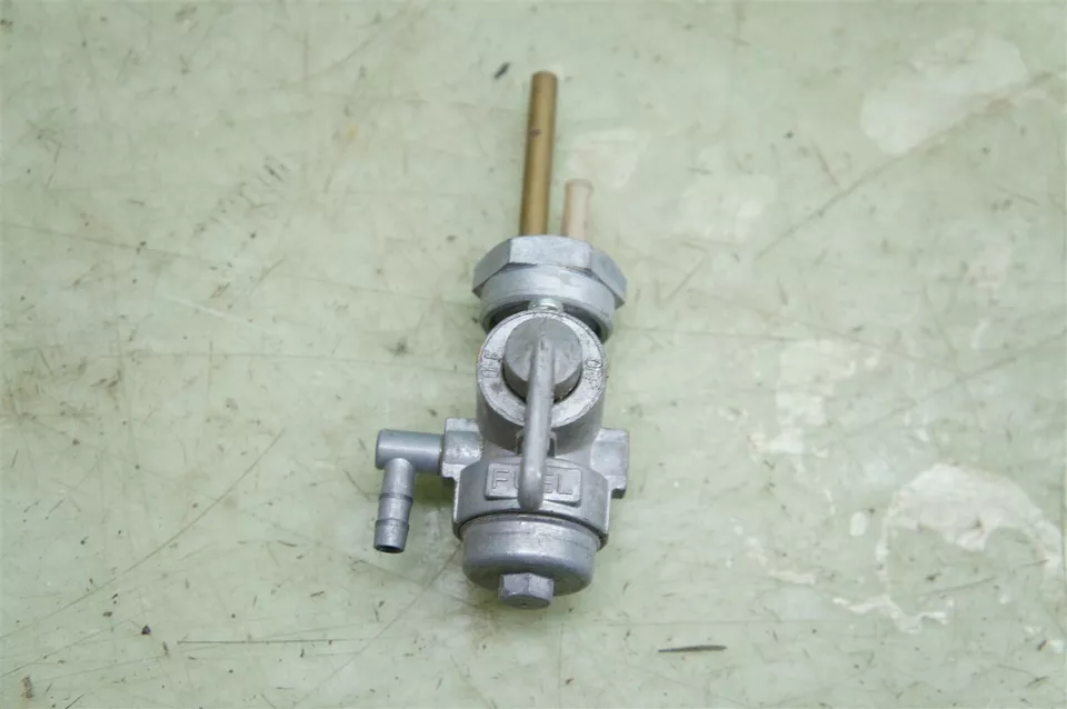

Hello,
thank you for your reply but tit don't leak from the lever but from the spigot (on the left on the picture)

It should be a tight fit. A few light taps with a hammer might do it. If not I used a smear of JB weld to seal them. Taking a sharp punch in a few places around it could tighten it up too. I did both.
