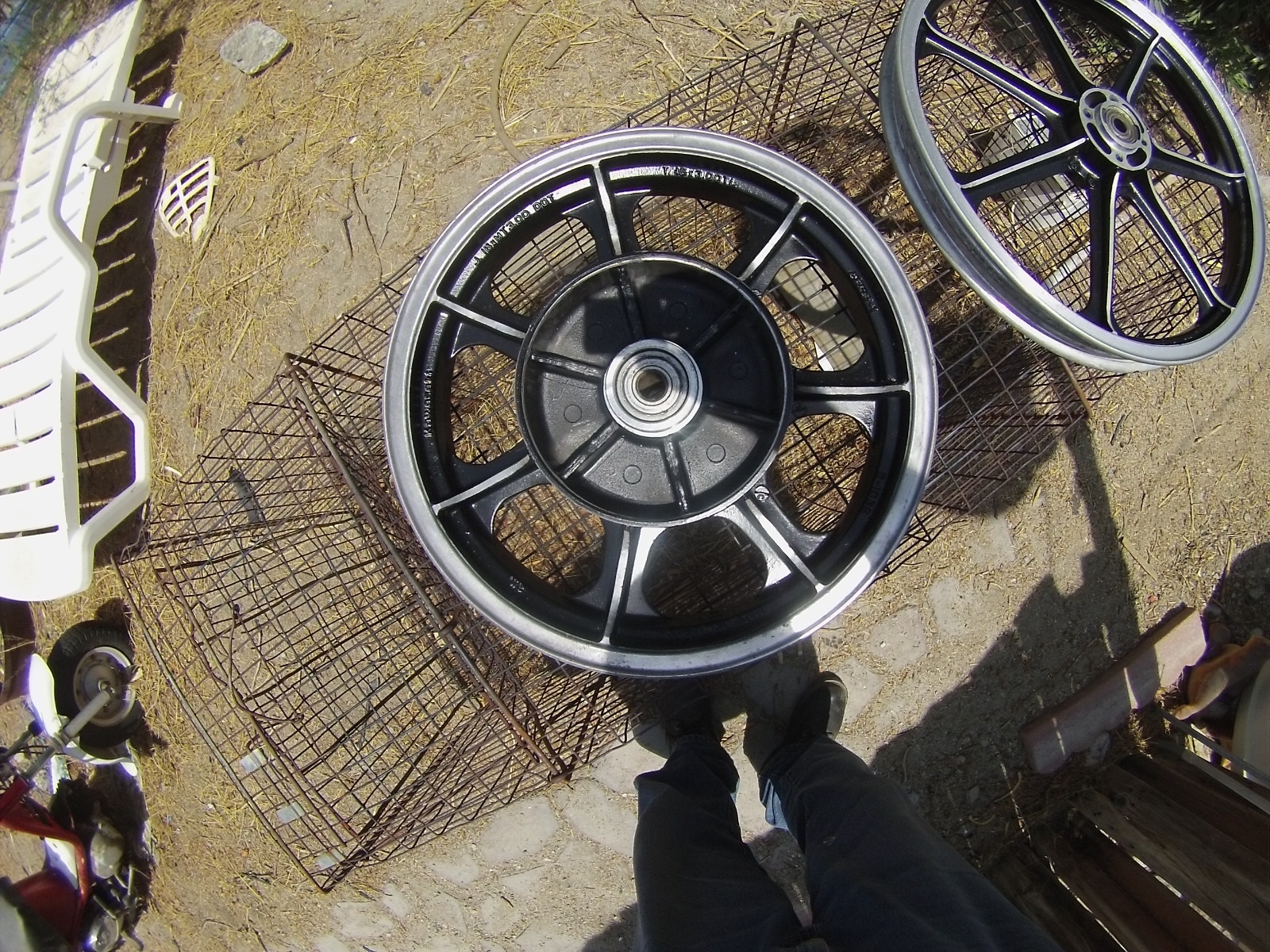

Yes, it's got the ribs to help retain the tire beads

If the wheel is "tubeless", somewhere on the outside of the wheel it will state as much.
KZ750 G1 bikes came with tubes. I doubt the wheels are designed to be tubeless. That said, lots of guys convert, and I've yet to hear of anyone doing so experiencing problems.
