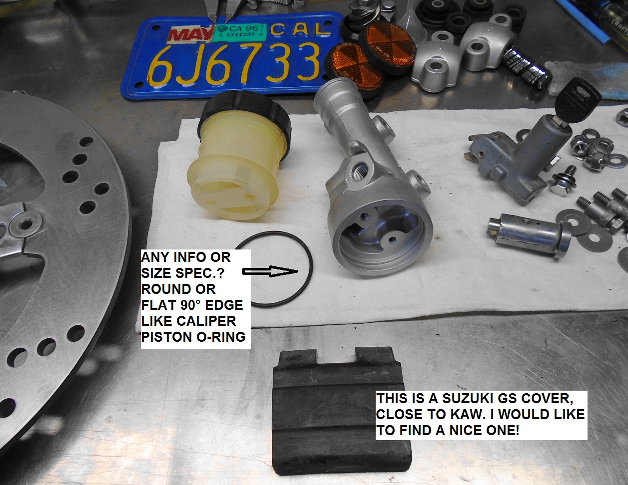

Hello, looking for info on the O-ring that is for the white plastic reservoir & aluminum body for the rear caliper from KZ1000 77-78 A model. Or there all the same.
Partszilla does not show a diagram on this particular one?
My bearing & seal guy can come up with one most likely.
The lip in the bore looks like a caliper piston O-ring groove with the square edge's
Just wondering if the Kaw Dealer might have one? I have never looked for one of these.
But I'm doing an all out resto of the master cyl. & caliper. Need a new O-ring / seal / whatever?

ALSO: Looking for a nice plastic dust cover for brake pads on the caliper? Like the 2, I sold over last 3-4 years.
One in Picture is from a GS Suzuki.

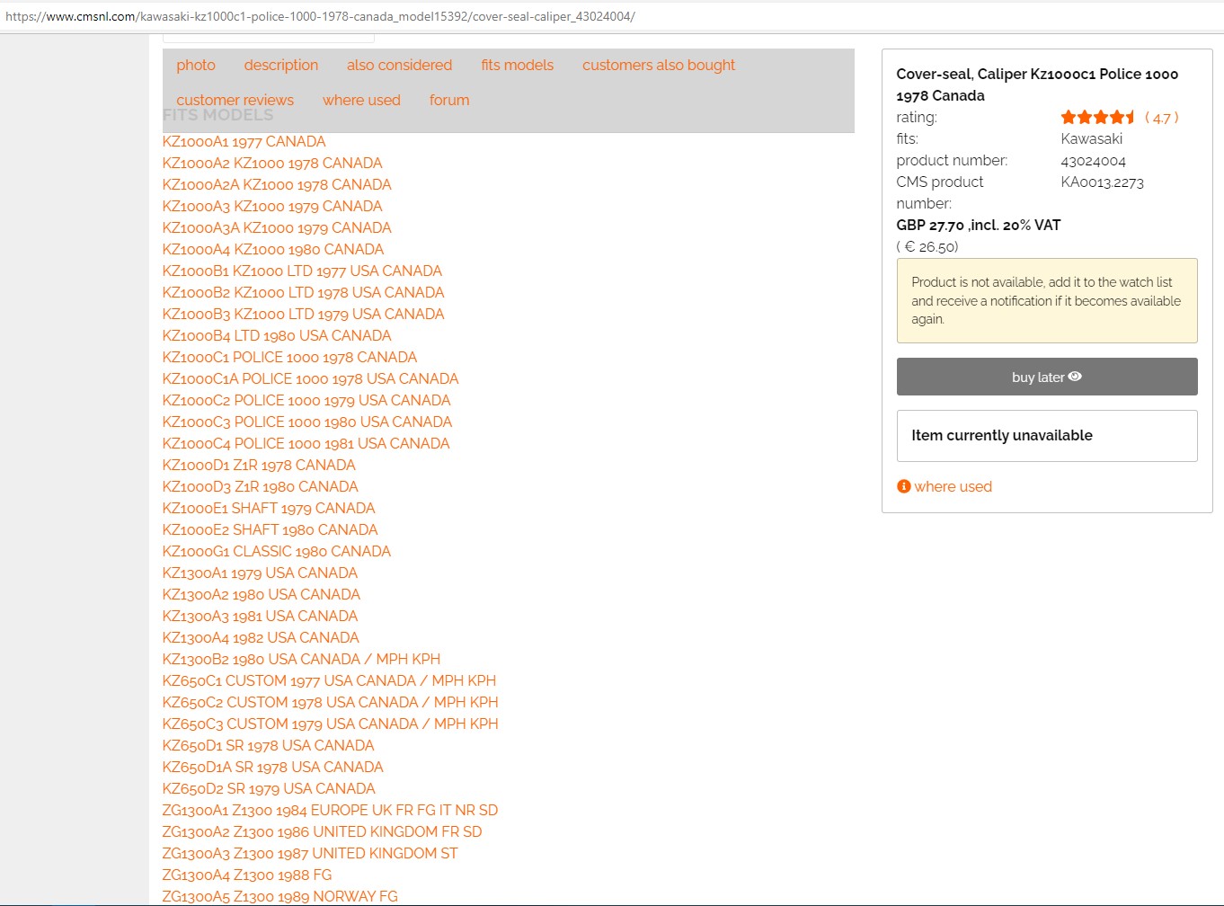

Hi Marty, CMNSL don't show the seal as a replacement part (so no part number) the cover looks pretty generic. There is a guy advertising one in Germany but I guess it depends how bad you want it

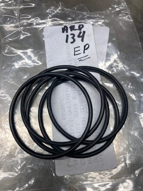

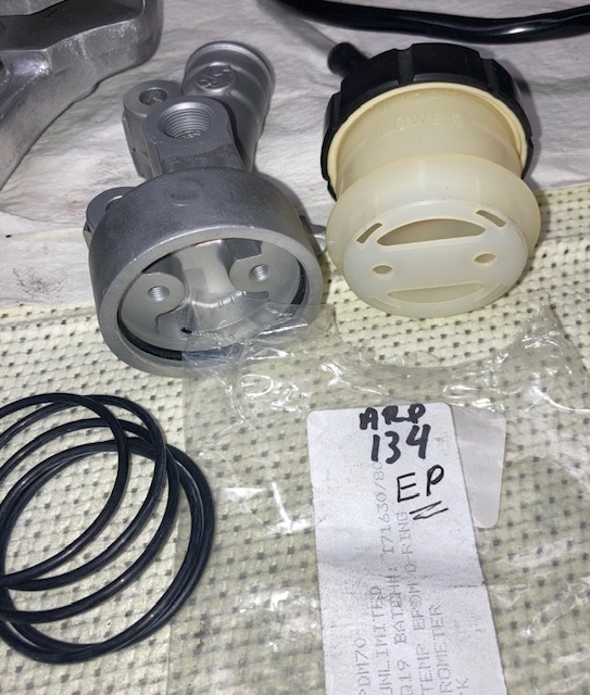

But, I ordered these O-rings. And I have extras to help others.

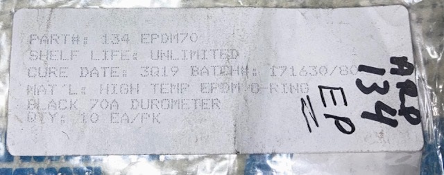

Back to the O-rings. ordered These: for the chemists out there, and the safety officers needing a MSDS sheet.WHAT IS EPDM?An EPDM O ring is made from ethylene-propylene diene monomer [M-class] rubber, a type of synthetic terpolymer. Apart from its durability and resistance against numerous environmental factors, this pliable material is very flexible in low temperatures, which can be as low as -60°F/-51°C. It can also easily resist hot water and steam with temperatures up to 300°F/150°C.
Or a plumbing O-ring from Home Orange might work too.
And I have 5 extra, as I had to order a bag of 10!

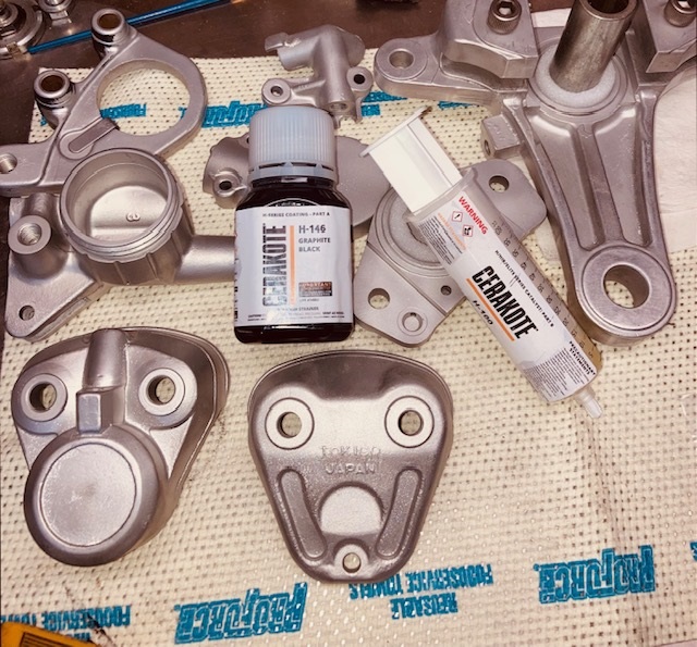

Plus for the cerakote info? I purchased some. I have not used it yet. I have all sorts of things going on.

That CERAKOTE hardener / catalyst tube looks like my epidural injections I get every 4 months in my spine!
Thanks to WOOKIE for making me think of trying cerakote! I wish I had started this stuff 15 years ago!.
