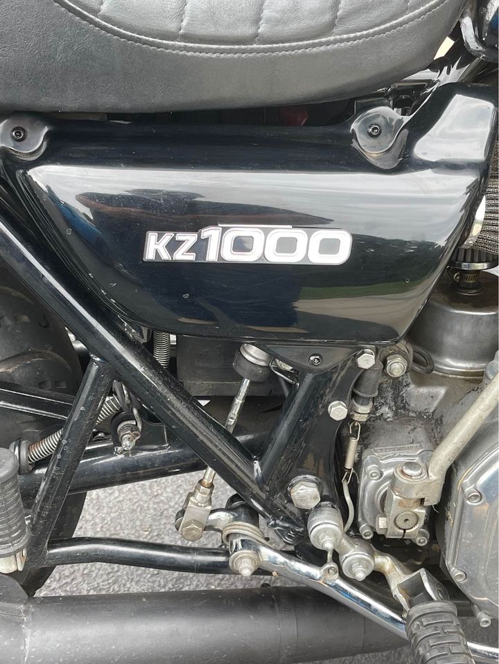

Oh yeah, mine doesn't have anything like that, it just has things like line up for an inline spring. What year is your bike?

Not mine it's a 79 on KZMarket $4200.
www.facebook.com/commerce/listing/150656...ref=share_attachment

The J-engined 1000 LTDs (1981 - 1982) have a completely different rear brake pedal, bracket and master cylinder setup than the earlier LTDs.
