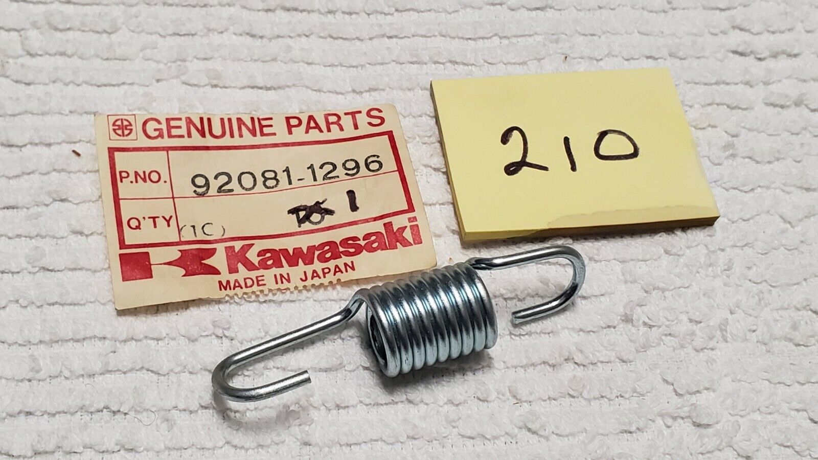

SPRING,BRAKE PEDAL RETURN PN  92081-1296
This is the part you were missing.  It's on the OEM Kawasaki parts fishe under "Rear Brake / Torque Link.

Thanks for the update. Yes, here is supposed to be a return spring.Part number 92081-1296.
www.partzilla.com/catalog/kawasaki/motor...ke-pedal-torque-link

The spring usually wraps around the brake lever pivot. Ed's right about that little hole. A little crud and it won't vent.

This one is different.

@Nessism -- I saw that spring on the parts diagram, but the way they positioned it in the picture makes it look like they are showing the spring which goes to the brake light switch.  My switch spring is very lightweight but has the U-shaped ends like shown, so I ignored that one.  However the other end of the V-shaped brake lever has a slot in it, and the place where I though the other end of the spring attached to is this shaft on the back side of the pedal plate which doesn't go to anything else but has a grove near the end in like with the V lever.  I simply got a spring with a full loop on each end.

@SWest -- wow that thing is way more massive than the spring I picked up.  OK gives me a better idea of what I'm supposed to be looking around for at least.  Does it actually attach to that shaft on the back side of the pedal plate, or is there another spot I'm supposed to hook it to?

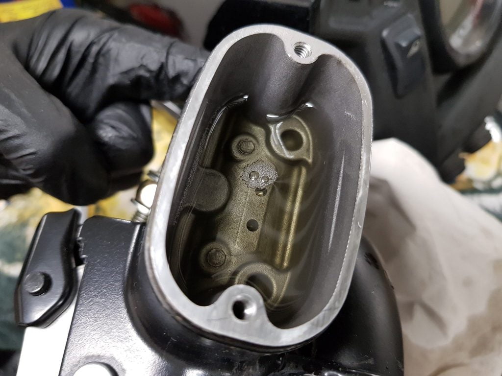

  • TexasKZ
  • TexasKZ's Avatar
  • Platinum Member
  • Platinum Member
  • Posts: 8142
  • Thanks: 2647
Re: Long-term rear brake issue -- possibly resolved?
14 Aug 2023 16:45
#888267
This is the least bad picture I could find. Obviously, it is for front brakes or a hydraulic clutch. Never the less, you can see in the bottom an obvious fluid port. Just above that, under that area of bubbles, you can see what looks like a depression where somebody started to drill, and then changed their mind. In reality, at the bottom of that depression is a tiny little hole that is necessary to relieve pressure in the system. If it is clogged, pressure will keep building up until the pads are firmly against the disc and the pedal or handle can no longer be depressed.
The hole is easy to overlook and it is easily clogged.
