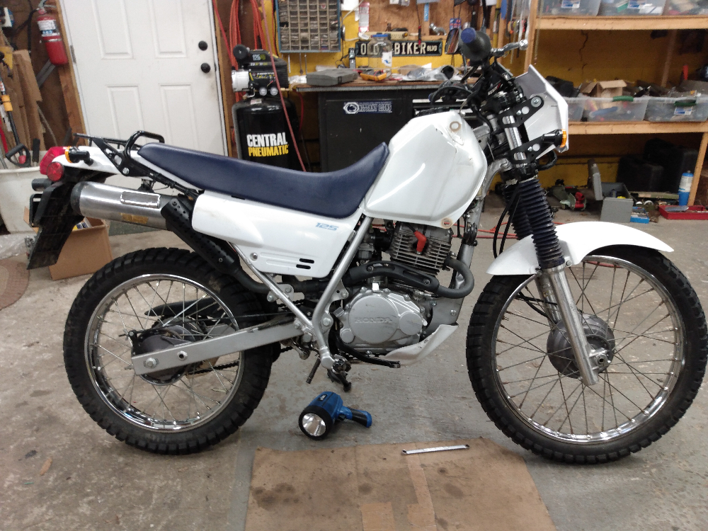

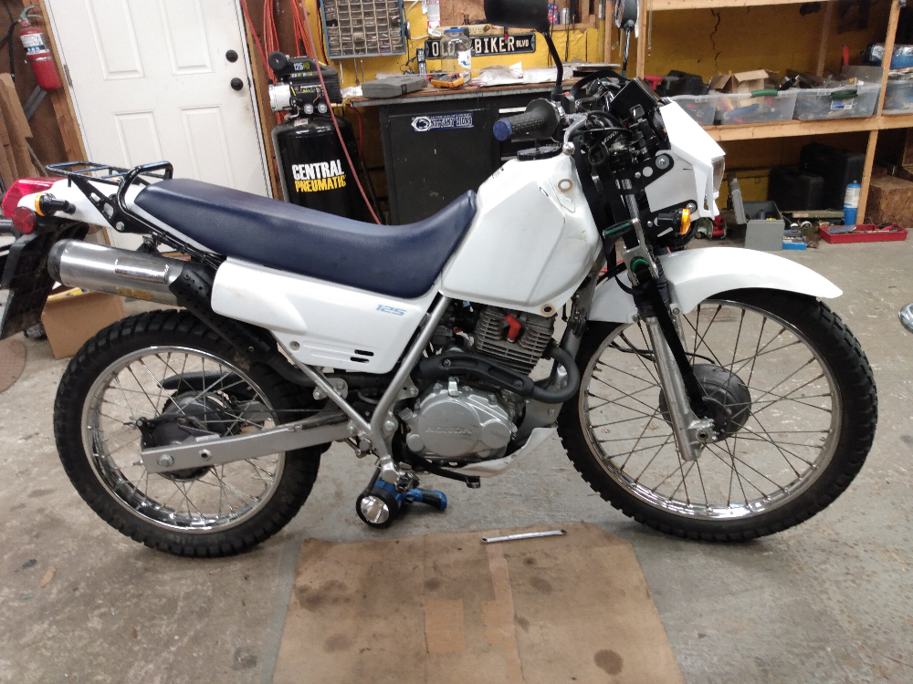

This is another progect in the garage. NT125. The fork tubes are straight. But when forks are compressed,the tire hits the down tube. Manual lists wheel base to be 52" but I measure 49.5".I don't know the history of this bike, but it think it took a front end hit sometime.Am I screwed.

The angle of the forks look to be steeper than the head stock.
It's clearly had a front end shunt and at the least the bottom yoke has been bent /pushed back and likely the forks too.
Re: Tire hitting down tube
05 Aug 2023 18:23
The frame/head stock area is bend!!!

Is it just me or the down tube coming out from the steering head looks bent? Or welded.
I thought on most bikes, that part of the frame is straight...................
Could be my eyes. I'm getting old....................

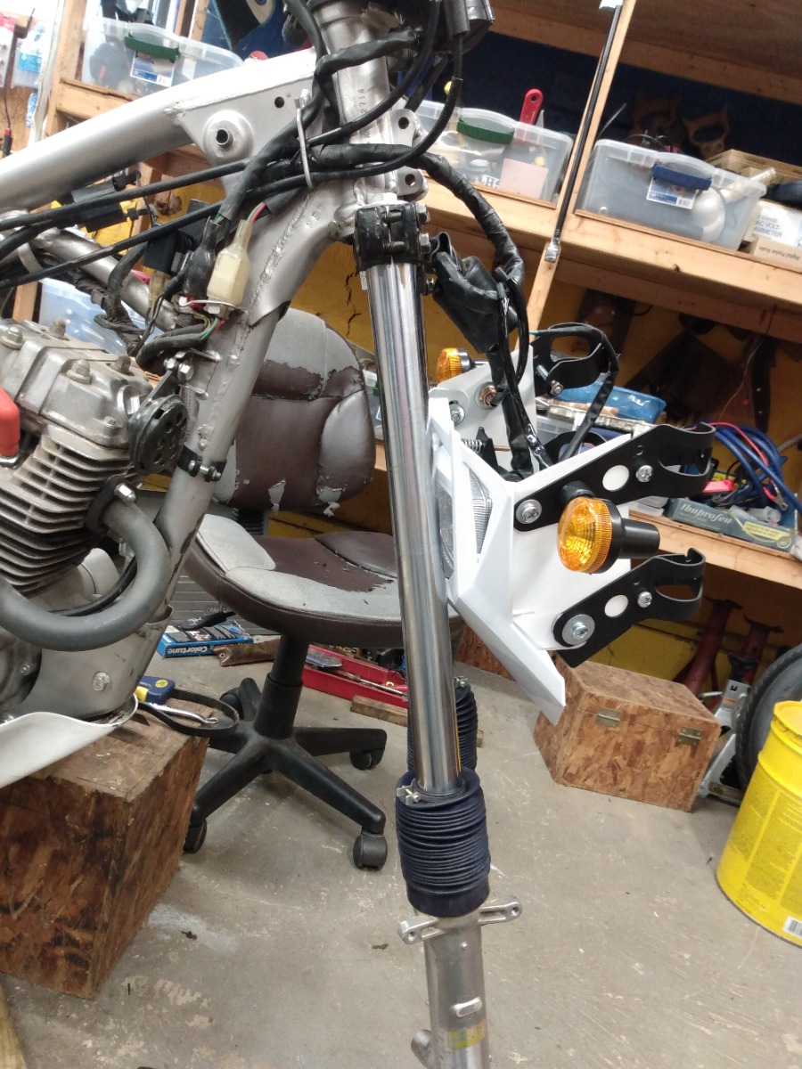

I'm tearing the front down now. I may get lucky and just need to replace the tripple tree. I lowered the tubes and clamped them in the bottom clamps. see pic.
Can't see how you can bend the tripple tree without bending the tubes. PO must have just replaced the tubes and didn't fix the tripple tree. Tubes are newish looking.

Looks like everything has a slight bend to them.

Frame is bent at the neck.
Top tube should be straight but is arched upward and the downtube is bent rearwards with the headstock bracing distorted and splayed behind the bottom bearing too.
Cross brace above the engine looks to be bent upwards also.
Those forks have been replaced after the event.
Probably thought it was just the forks that were bent until the new/repaired ones were fitted..
- ckahleer
- Posts: 555
- Thanks: 195
06 Aug 2023 17:58Sounds like a bent tripple tree is the least of my problems. Thanks all for the help. Not sure how I'll procede. I'll think on it awhile.Frame is bent at the neck.
