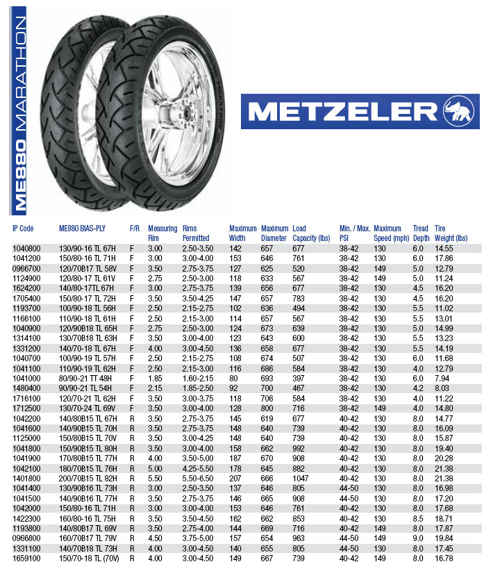

Over doing the tyre size will cause weaving and instability, the below chart shows permissible and ideal tyre/rim combinations
