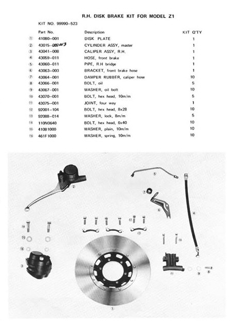

Simple job.
Undo the two screws that hold on the chrome hub cover on the rh side.
Bolt on another disc, ( 4 bolts, lock tabs and disc)
Mount a r/h caliper with two bolts. The calipers are handed so you'll need a rh one making sure it has the bleed nipple central if front of leg mounted caliper. (2 bolts and rh caliper).
Add additional lower hose, and twin outlet Splitter. (lower hose and twin outlet Splitter)
You'll also need a 5/8th dia master cylinder as opposed to the 1/2in dia single disc version you already have.( 5/8th master).
Items in brackets is your shopping list plus (fluid and pads) of course.
To make it a really effective upgrade swop all hoses for new braided versions.

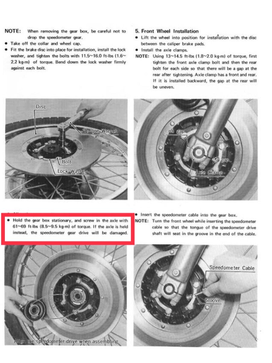

Scirocco, thank you. I was just looking for the axle torque last weekend at the Zukey Lake outing. It’s not noted in any of the Z1 manuals I have.

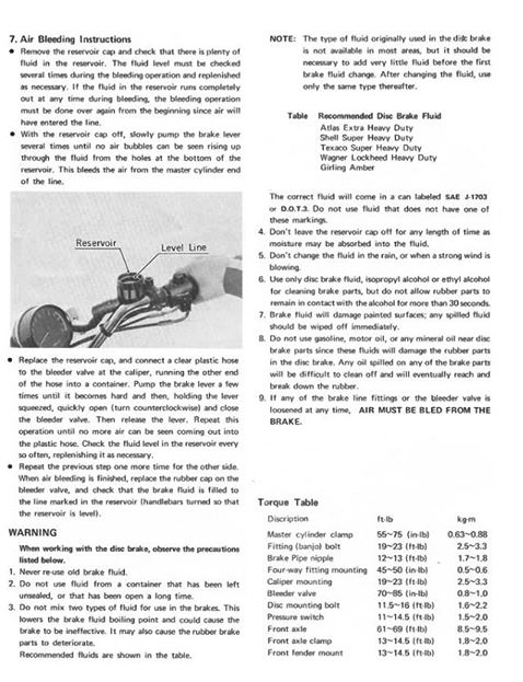

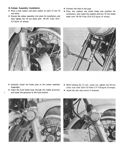

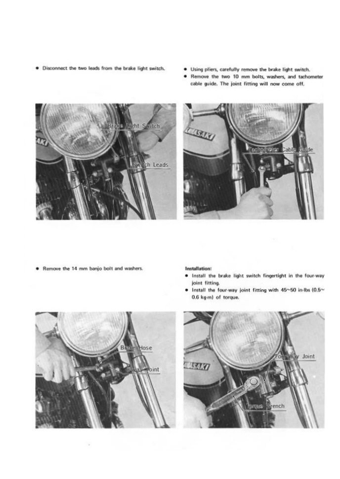

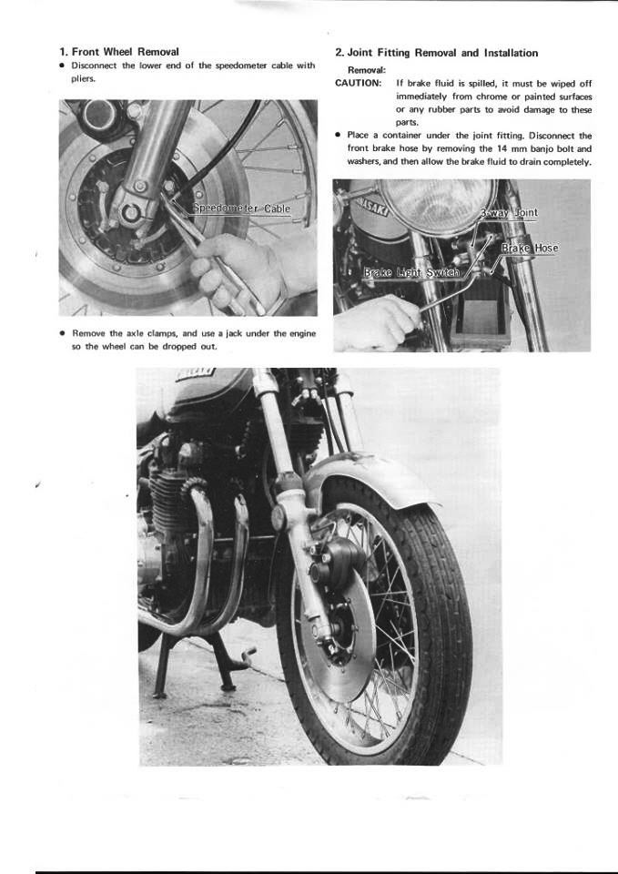

I copied this down from a post on the now no longer working kz650.info site. In looking at the file it appears I did so in 2012 so take it with that knowledge.
