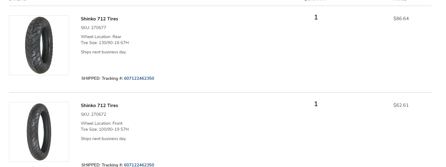

Got these on my 81 KZ750H. Cycle gear gives me a vet discount plus they were on sale. $161 for the set. I took the wheels up to cycle gear to get them mounted....I think it was $25 a tire.
www.cyclegear.com/tires/shinko-712-tires
