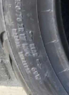

Pic of the tread V and direction arrow. Both have the point in the direction of rotation.

Tires  do usually have the arrow  to let you know which way to install them
 Some tires have 2 arrows to show which way a tire is mounted depending on if it is for the front or rear wheel

The “V” is called a chevron. It, in my experience always points in the direction of rotation. Unless it’s a pattern designed to be bidirectional. In that case follow the rotation arrows printed on the tire, keeping in mind the rotation arrow is subject to tire position, aka front or rear.
