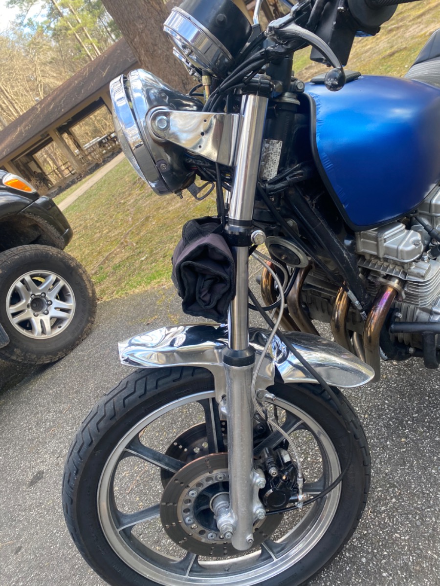

I’ve done this EXACT swap. Everything said here is true, need E steering stems to clear the wider E tank. I’ll be honest with you, there is no steering difference using the H fork lowers. Maybe on paper but it’s absolutely negligible behind the bars.
