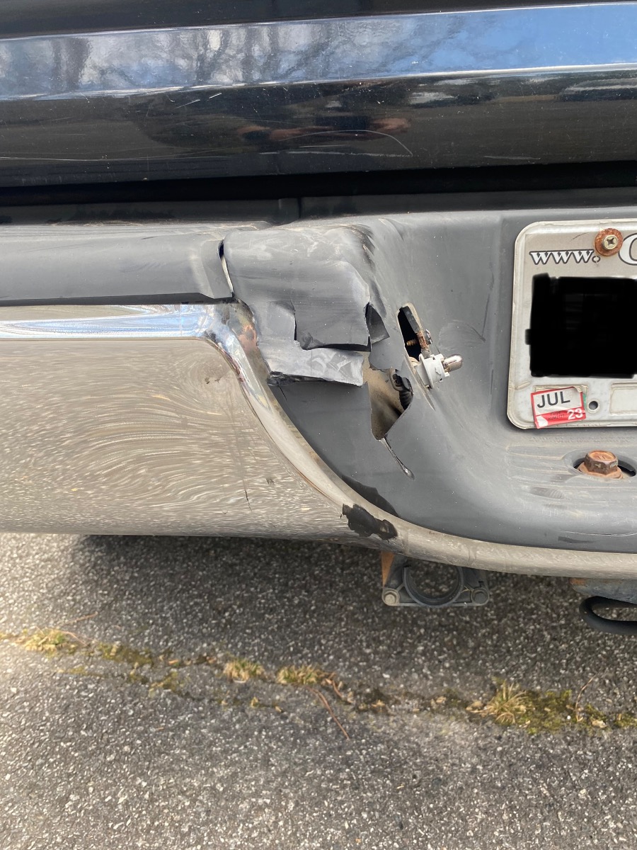

I’m fine, getting sore this morning but to be expected. Yes the worst of it is going to be the fork tubes, some of the small bits got bent like the clutch lever and the bars, broke a turn signal cover, need a new grip and a fender. I ended up riding it back home after the police report was filed. I rebuild the forks not long ago so I’m going to replace the uppers and put it back on the road with the lowers. I’ve got progressive suspension fork springs, new seals, fork oil, and a polish job in the lowers so I’m not going to throw it away.

The other truck is even under $100 to fix too. He’s actually a good friend of mine and knows how mechanical inclined I am so he accepted my offer that I just buy the parts and fix it myself without getting insurance involved so it’s pretty much the best worst thing that could have happened. This is it for him.

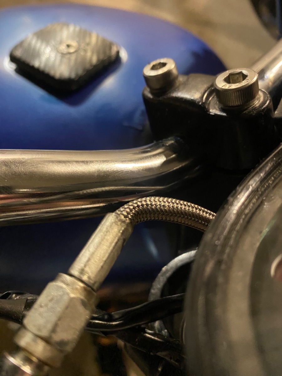

On the bright side, I may have found my issue to the brakes locking up issue in another thread. When installing the new handlebars and reinstalling the brake master cylinder, I saw that the line was sorta kinked, possibly causing fluid to push through and not allow it to return. I will change the banjo fitting to one that allows more clearance for the bars and a better routing.

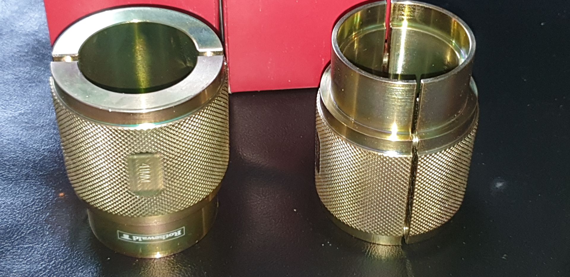

I will order the fork seal driver, I have good experience with the motion pro, very sturdy and well made as far as tolerances and finish. Little pricey but definitely worth its weight to avoid any problems come time to reassemble.

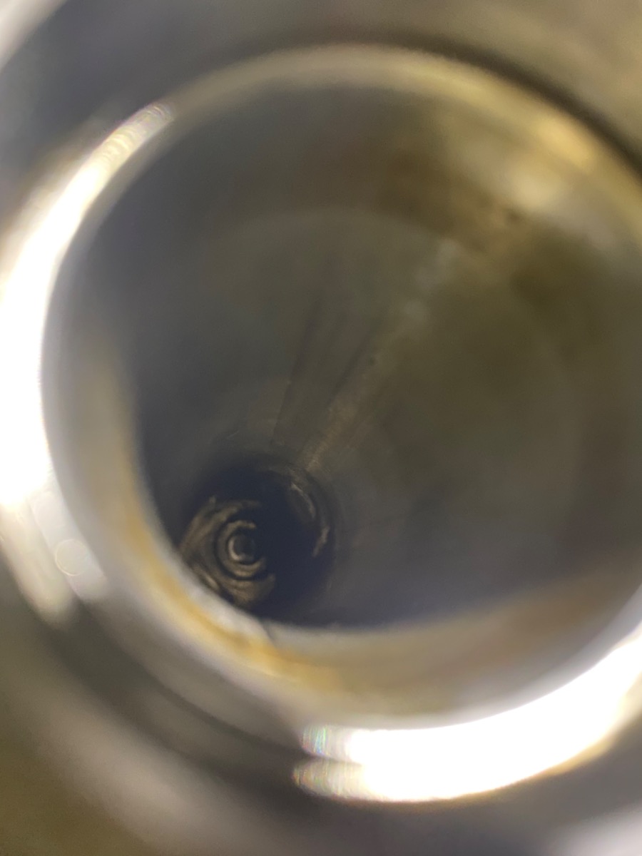

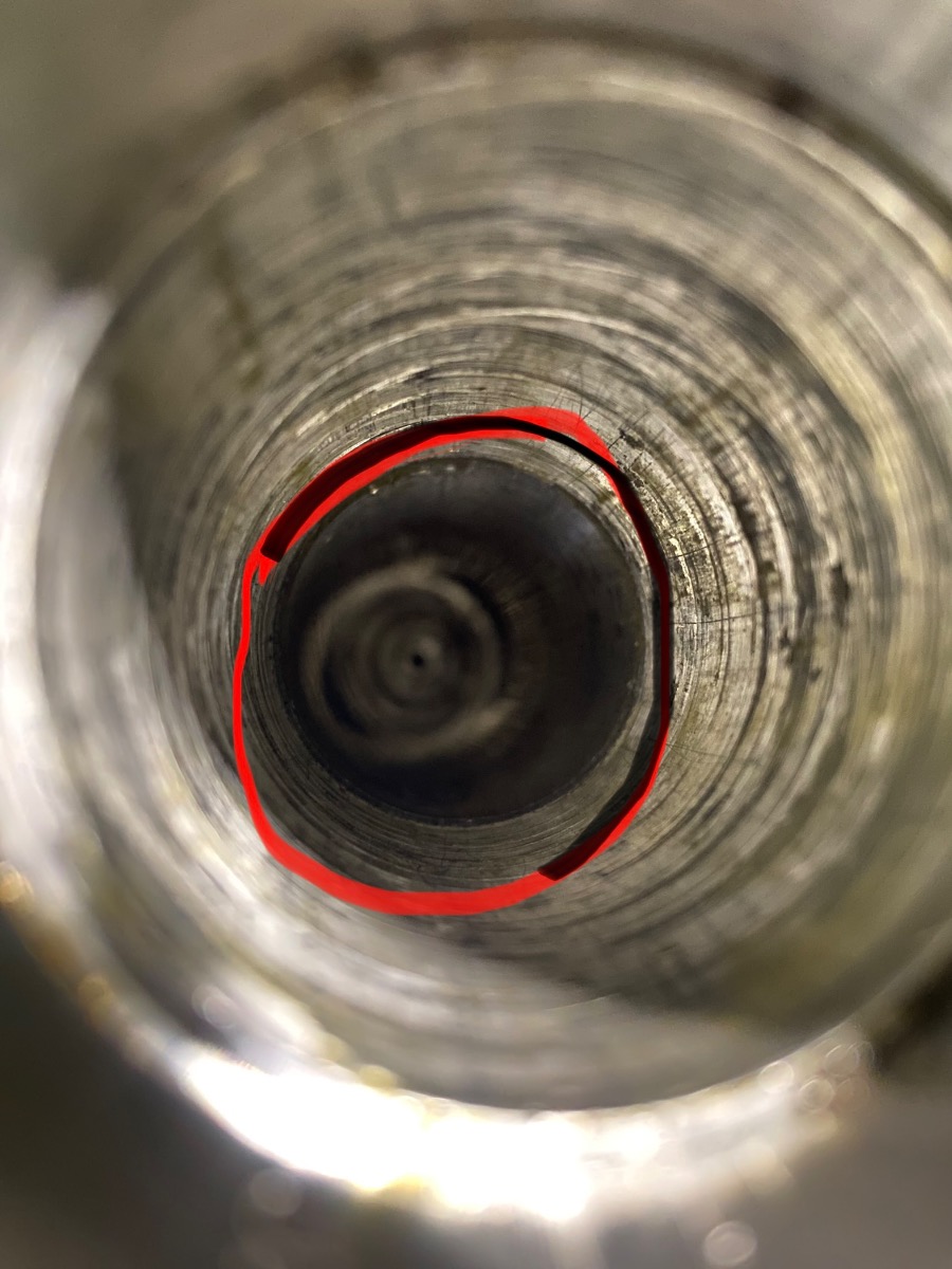

New steering stem arrived today as well as the seal driver. Disassembled the forks not for the last time. I hit another snag and I’ve pretty much made up my mind as to what to do with these forks. But I want everyone else’s ideas.

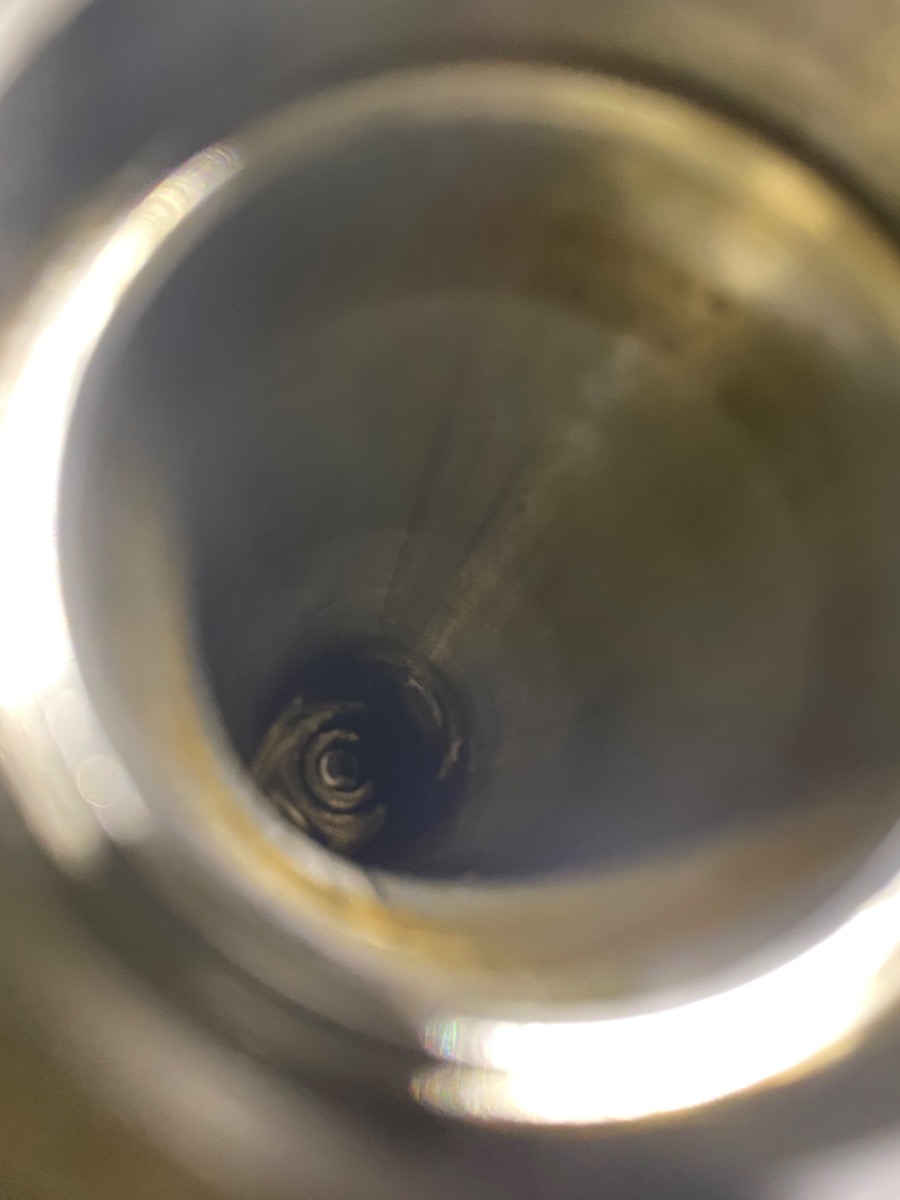

The the bushings from the donor forks pressed into the original fork lowers and now the bushing on the tube can go past it, however there is a lip on the inside of the fork where the tube bushing does not slide. Here is a photo of the lip in the original fork lowers.
Here is a photo of the donor fork lowers and you can see there is no lip.
what will happen if I assemble the forks without the tube bushing? It still does have the lower bushing that I fought out and then reinstalled. What does everyone run for fork oil as far as weight? What does it affect? Will a higher weight oil make the fork rebound slower?
