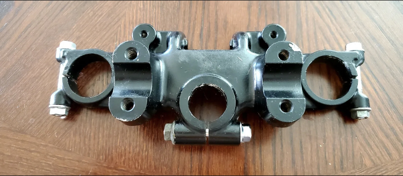

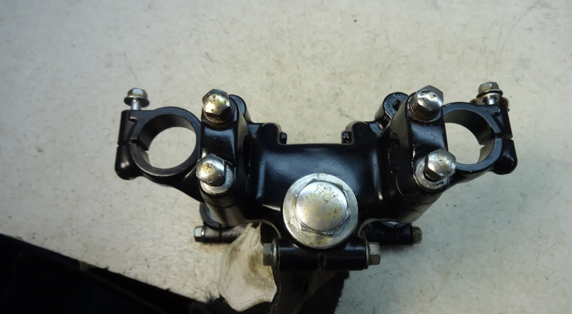

Wookie, I am not sure what you mean by leading but I believe the E has the leading forks. The forks seals are the same as well as the fork caps.
this is the H steering stem that is currently on my LTD.
This is the E steering stem.
- Posts: 6939
- Thanks: 4354
Re: KZ750E vs H

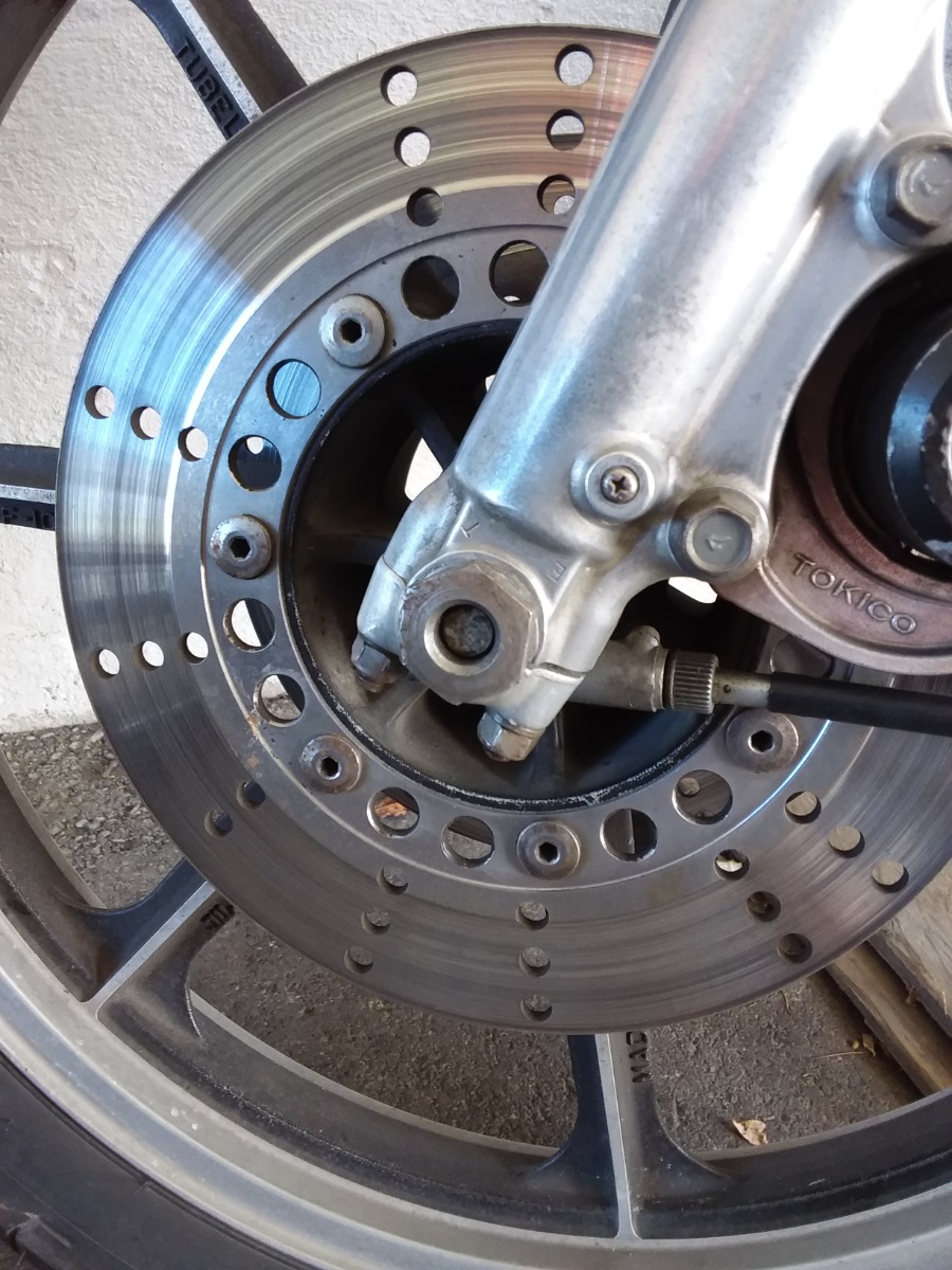

08 Sep 2022 06:28 - 08 Sep 2022 07:10On the Ltd the front axle is in front of the vertical axis of the fork leg (leading) the "E" has the forks on the same axis as the fork leg. using "E" trees with "leading" forks will push the wheel even further forward increasing the "offset" which I believe will slow the steering even more than a stock Ltd (very stable in a straight line though) I guess you need to decide what you want from the bike
It may be possible to use your "H" top tubes in "E" lowers with an "E" axle to maintain current height without increasing the offset with the "E" trees

Re: KZ750E vs H
08 Sep 2022 07:43
Wookie, so if I am understanding you correctly, the H forks bottoms will slow the steering at low speeds but increase stability in a straight line while the E forks will maintain the angles and continue to steer like stock.
My steering is so limited right now that even with the slower steering at slow speeds but increased turning radius it would be worth it to change over the stems in order to regain the steering angle. I’ll post a picture tonight of full lock with the E tank and H stem.
