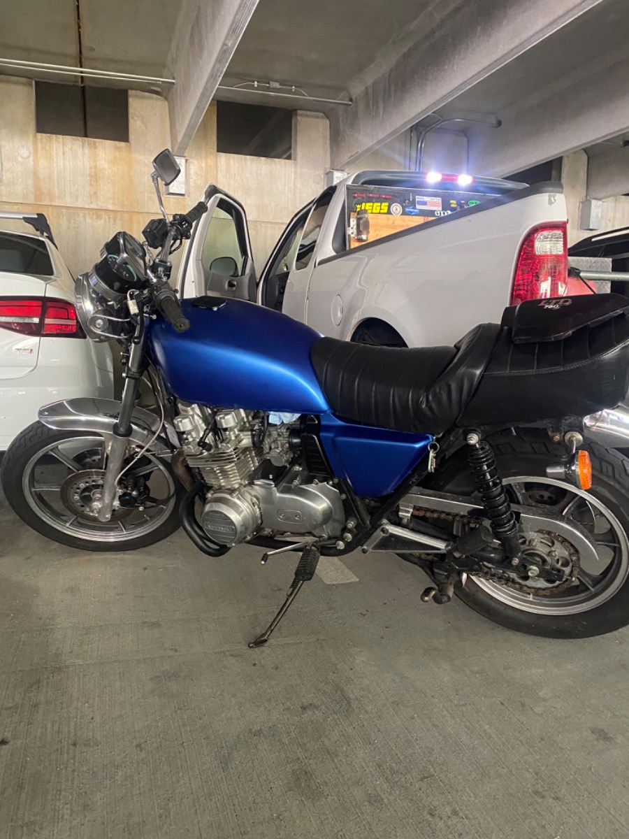

I really apologize for taking so long to reply here. Honestly no excuse except being lazy and not having any pictures.
Here it is on the final install. The rear of the tank does push up further which does push the front of the seat back a bit. This does lead to the wrinkles you see on the side. Honestly it doesn’t bother me, maybe one of these days I will recover it with some supportive foam lol.
The following user(s) said Thank You: Michel3007

03 Feb 2023 10:12
Cheers Elfarm, that's completely alright, I was in no hurry
From what I can see, it seems that you haven't changed the headlight bracket in the end, no ? is it not necessary then ?

03 Feb 2023 20:40

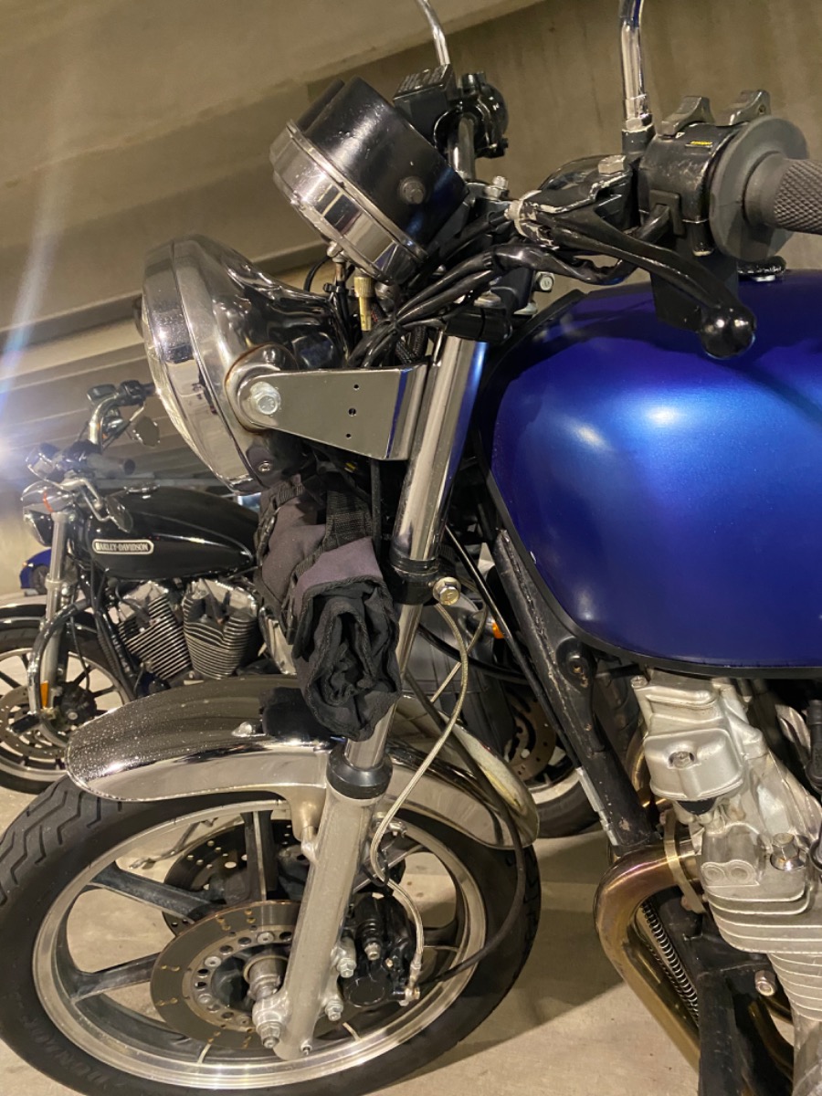

Well being completely honest that photo was from the tank mock-up the very first time it was installed. Heck in that photo it had no gasoline in the tank. I did end up installing the different headlight mount however I would not recommend the one I used. Granted I believe it looks better than the factory 750E mount however with this one you lose the ability to lock the headlight adjustment into place. How tight you get the side mounting bolts for the headlight dome is how much you lock it in place.
another reason I do not recommend it is because it does not fit tightly onto the forks. The forks are 36mm and the mounting holes are 38mm so it does rattle if you do not take up the slack. The way I chose to do it was to stick 2 zip ties vertically up the shaft of the tube and this provides enough support for the bracket to become solid. You still have the issue of it not being tall enough to fit between the lower stem and upper stem so I turned again to zip ties to take up the slack. It’s really a solid mount and the zip ties are not noticeable at all. However like I said I would not recommend it to anyone looking to make the swap.

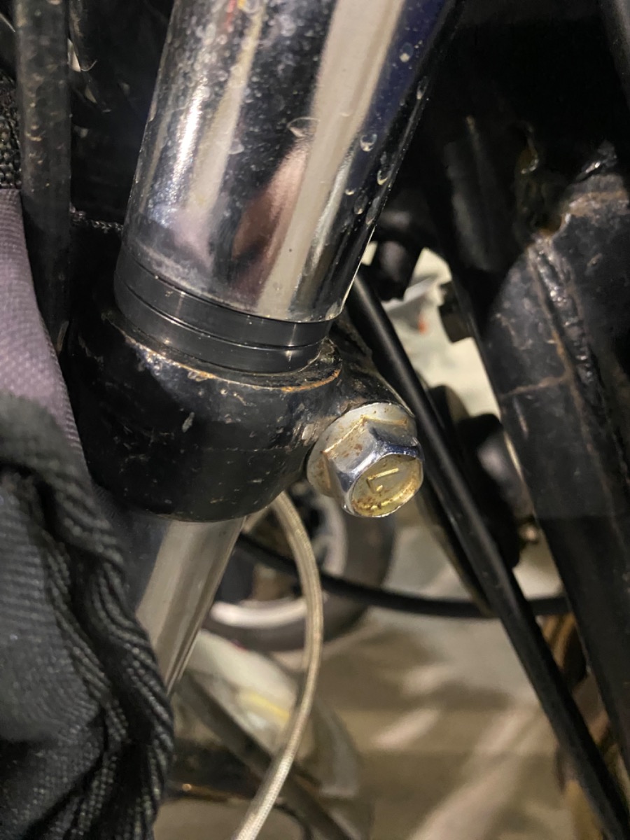

Here is a photo of the zip ties on the bottom side of the mount. As you can see it’s not really noticeable.

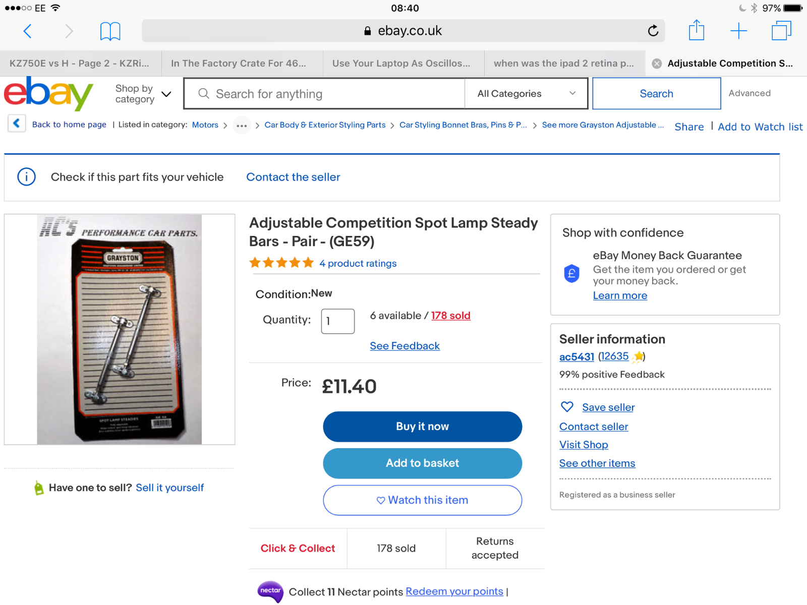

Elfarm if you want to fix your headlight position you could use something like this (fog light stabilisers for rally car)
- Posts: 7994
