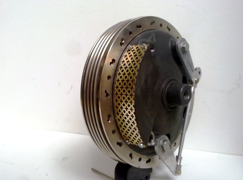

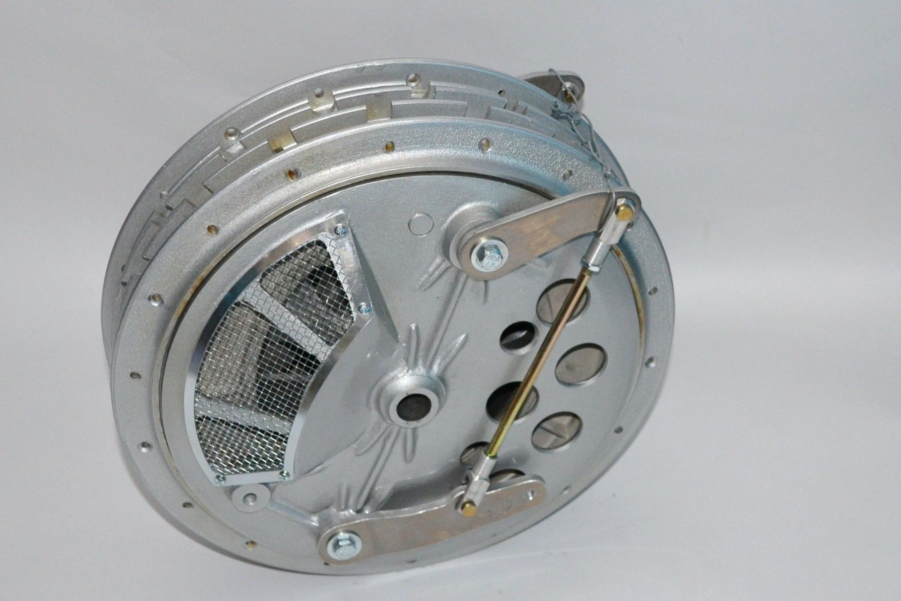

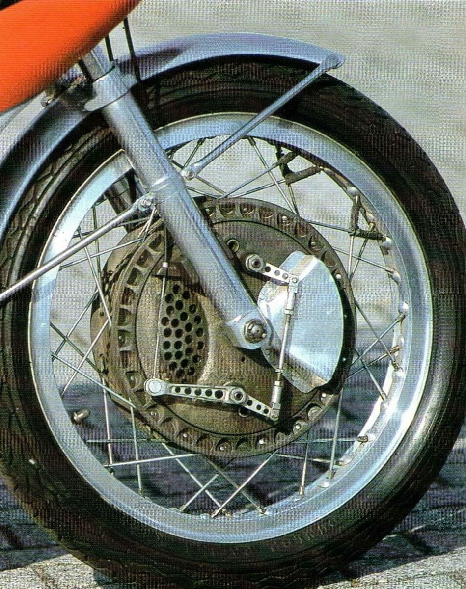

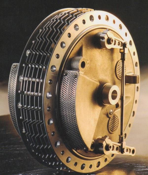

22 Apr 2022 21:44 - 22 Apr 2022 21:45I don't know. Some of them look pretty cool. I still don't want one, but the vents and fins and external linkages look neat.

22 Apr 2022 21:59Haha - fair enough I do see what you mean. I do find the one on the 400 a little... boring? It's so personal I'm not even sure why I think that because it's not like I see them often.I don't know. Some of them look pretty cool. I still don't want one, but the vents and fins and external linkages look neat.
I think if there weren't quite so many cons to drums I'd have considered keeping them just because they're different. I can see the look growing on me over time if not for that.
