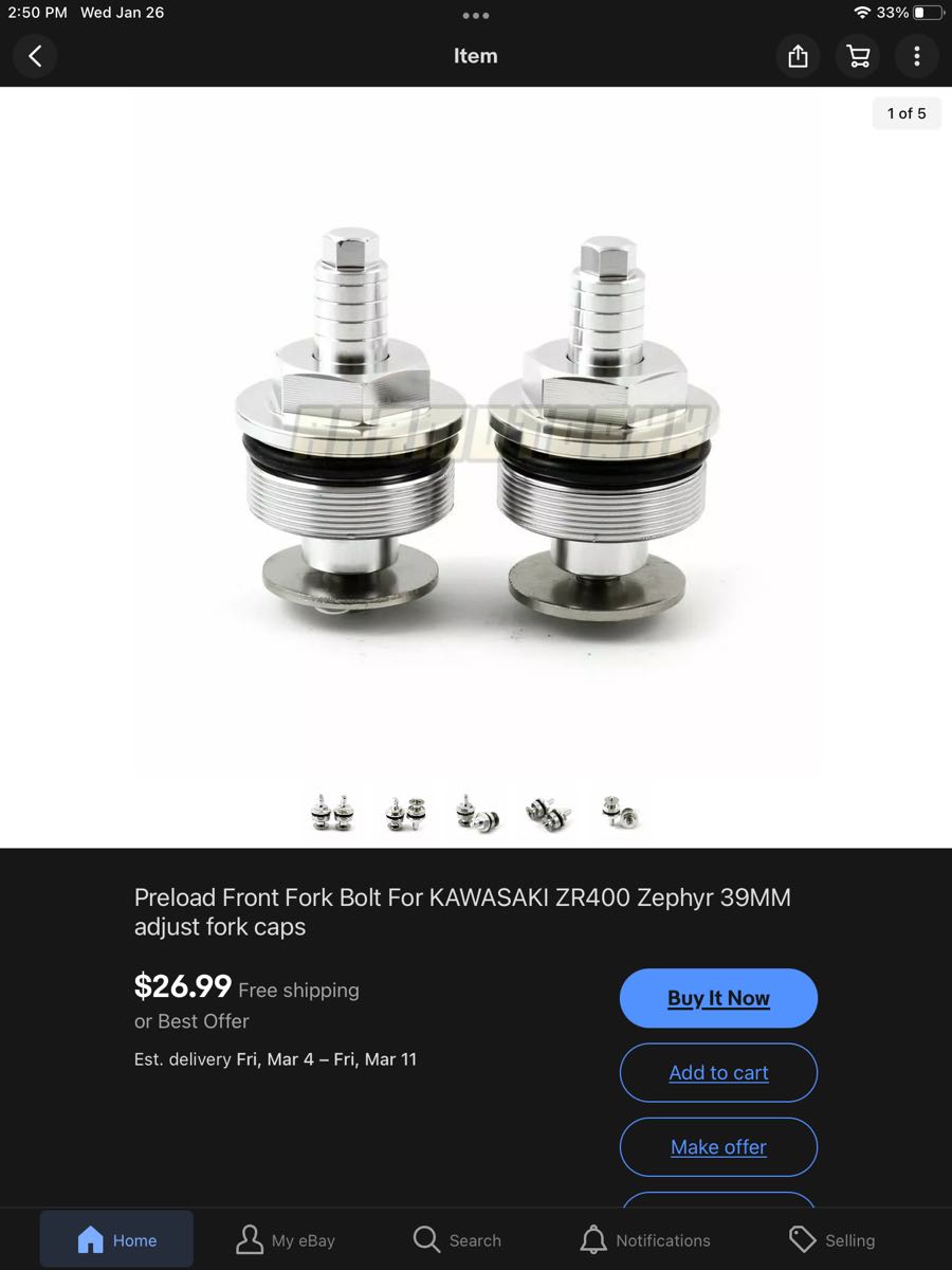

Turning my nice original 81 1100 shaft into a daily driver with ordering shocks, cartridge emulators, fork springs and a Sargent seats job to give the seat a ZRX look.
I’m thinking of fitting fork preload adjusters and getting rid of the air valve. Does anyone know of compatible fork preload adjusters such as the following link? I’m half assuming someone here’s done it already.
711-127632-2357-0
thanks if there’s info to share.

Are your forks 38 or 39mm? Why wont the ones in the link work?

I think the Z1100 has 39mm. The eBay listing, iirc, said the item has 34mm threads. Fitment parameters would be thread diameter, pitch and depth and hence the question…..

I just checked and the forks are 38mm. Does anyone know if the 82 or 83 went to 39mm?

27 Jan 2022 09:51I’m thinking of fitting fork preload adjusters and getting rid of the air valve. Does anyone know of compatible fork preload adjusters such as the following link? I’m half assuming someone here’s done it already.
There are several past discussions here where Nessism brought up the fact that the air-fork equipped bikes came with much lower fork spring rates than non-air-fork models. Based on numbers in the factory manuals, the air-spring rate was about 1/2 of what you really want. Adding preload adjusters is not going to correct for the low spring rate. Preload adjusters only set the static height when you are sitting at a stop sign on the bike. Preload adjusters can be useful, but they are not going to make up for the low spring rate without air pressure.
