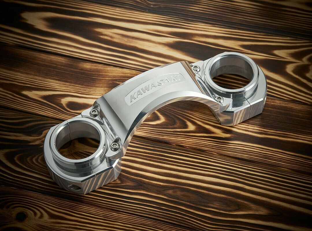

No eBay APP ID and/or Cert ID defined in Kunena configurationNothing listed for a Z!. I got this one. A little pricy but it looks sexy.

No. Contact the ebay seller and see if they have one for your bike.
264461637661

07 May 2022 04:42Gotcha...and that is one gorgeous piece of motoporn!No. Contact the ebay seller and see if they have one for your bike.
264461637661
