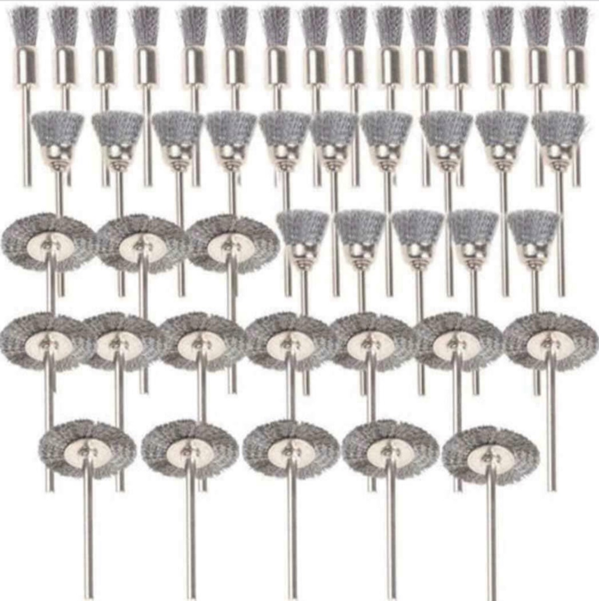

01 Nov 2021 13:05Paul, the first soak was in Berrymens carb dip. It really didn’t do a lot. Just knocked down some of the funk. CLR is what took out the rust from the bore and 90% of the corrosion. Small stainless wire brushes in a dremel are priceless.This looks great. I am about a month behind you with my 1981 GPz and my situation is almost exactly the same so I'd like if you could confirm exactly what you did?Anything else ?

Re: 1980 Kz750E Front Master Cylinder
01 Nov 2021 13:29
I got a set like this from Evilbay. I’m sure there are other sources. They are indispensable, and my first go to for everything I clean or polish.
