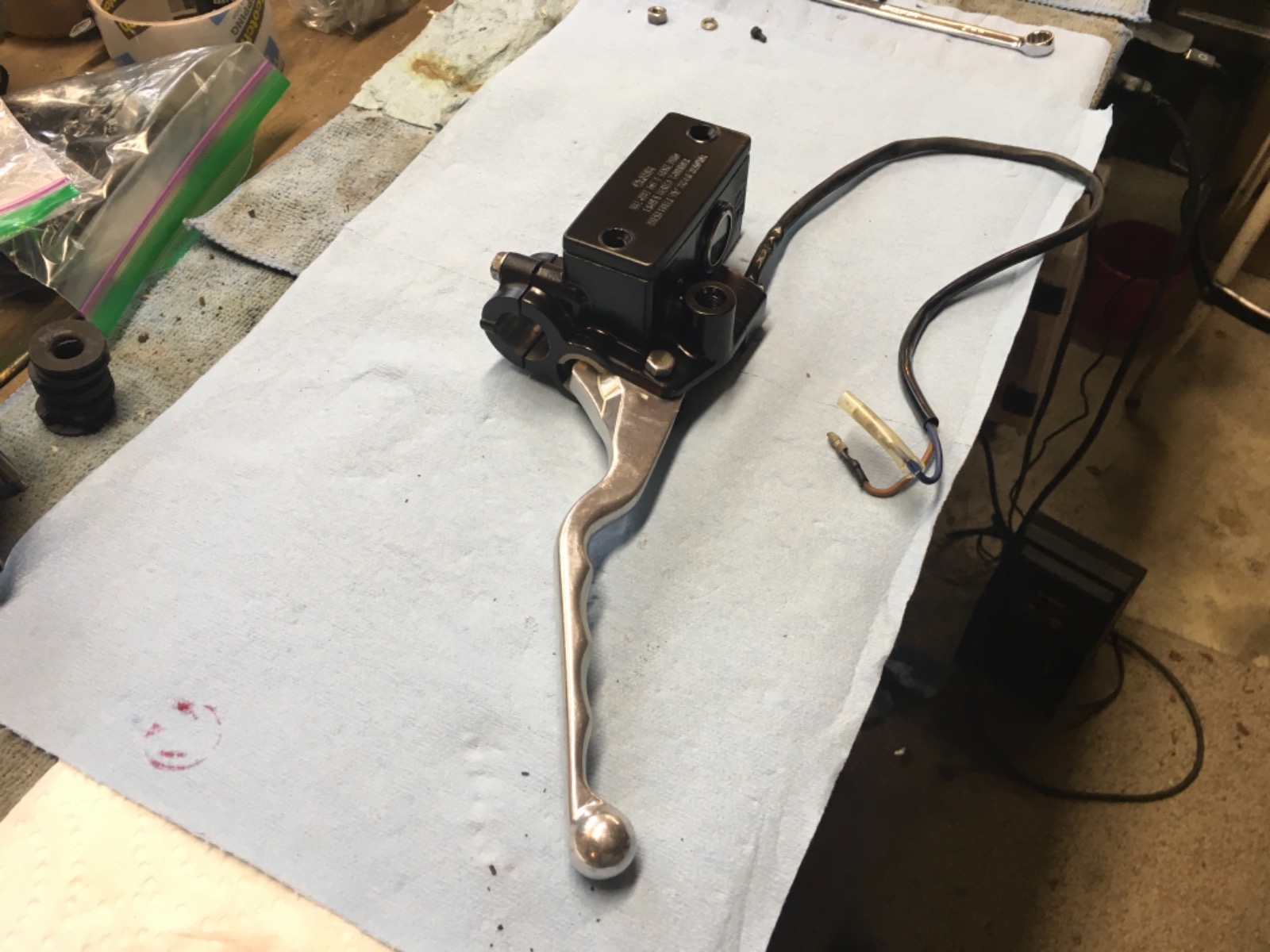

You must be way more picky than I am Matt. That M/C looks very nice to me.

05 Oct 2021 18:40Thanks Rick.You must be way more picky than I am Matt. That M/C looks very nice to me.

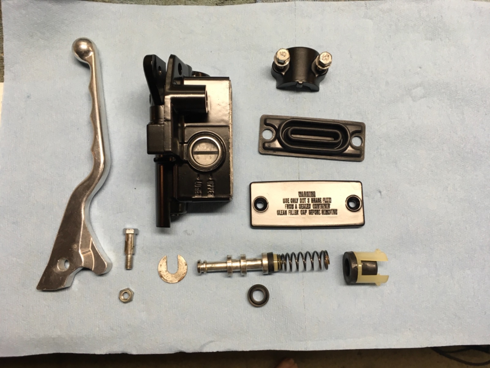

I'd say it looks 99.9% better. hee. That m/c is kind of a poor design & has a tendency to leak at the cap, maybe consider using a sealant of some sort on the diaphragm. I refurbished mine a few years back, cleaned the grooves thoroughly & installed a new diaphragm. used an awl to scrape off the hardened crud & hit the groove w brass wire wheels. but it still leaked within a year. At the time I thought about using a sealant. probably should've done. Here's a pic from an old clymer manual.

Martin_csr. Thanks for posting the link to your M/C restoration. I was thinking of baking the M/C but was worried about the site glass. I was thinking the glass and seal should handle a temp at least if not higher than the boiling point of the fluid. Just a guess. I’m going to bake it similar. I fit the diaphragm yesterday and it seamed shrunk up. I like the idea of getting a NOS.

That diaphragm is NLA & probably pricy on EB. Honestly, I would consider reusing the old one & install w a very light bead of sealant. It's kind of the pits to go thru all the trouble, get it all nice n pretty, install a new diaphragm, then still have it ruin the paint.

Thanks to martin_csr for the confidence to oven cure the M/C. First cure was about 145 of 30 minutes. Second was 200 for 45. All turned out great. Assembly tomorrow and then on to the front calipers.
