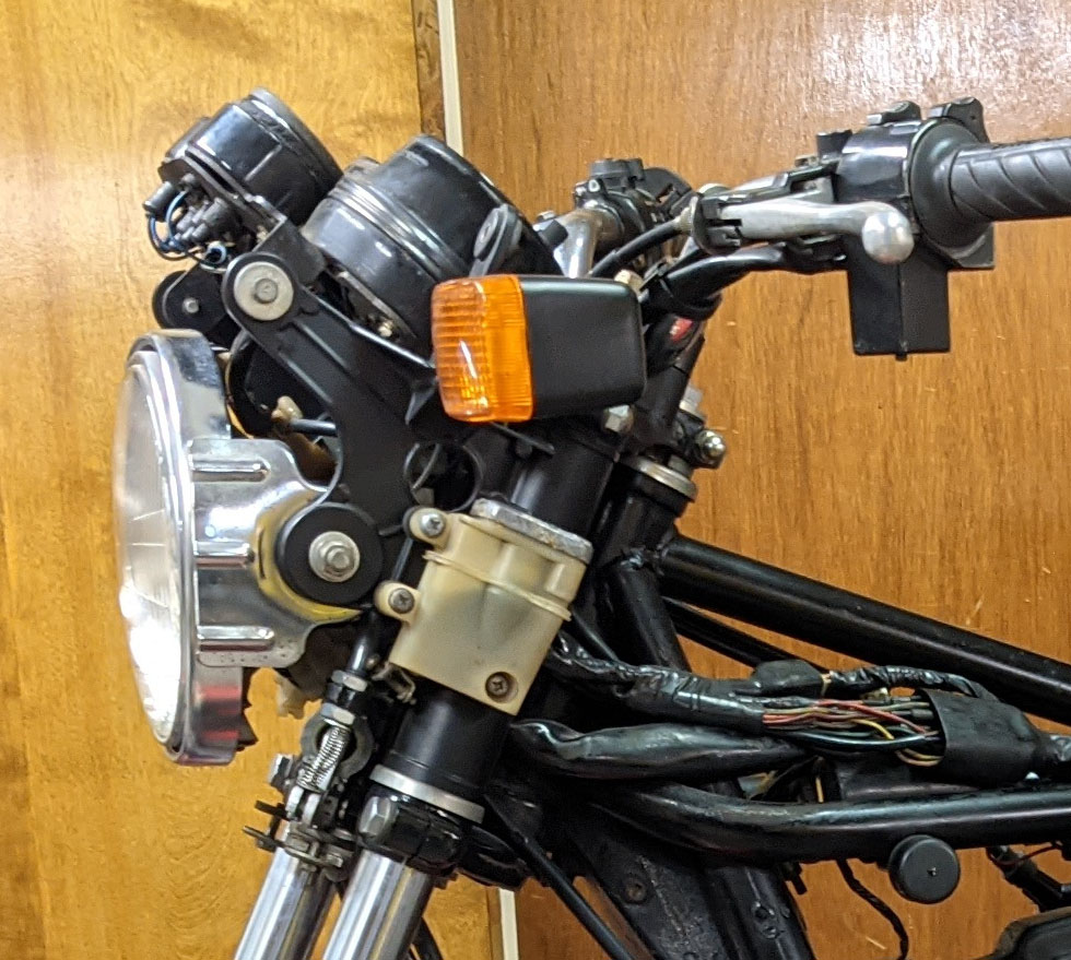

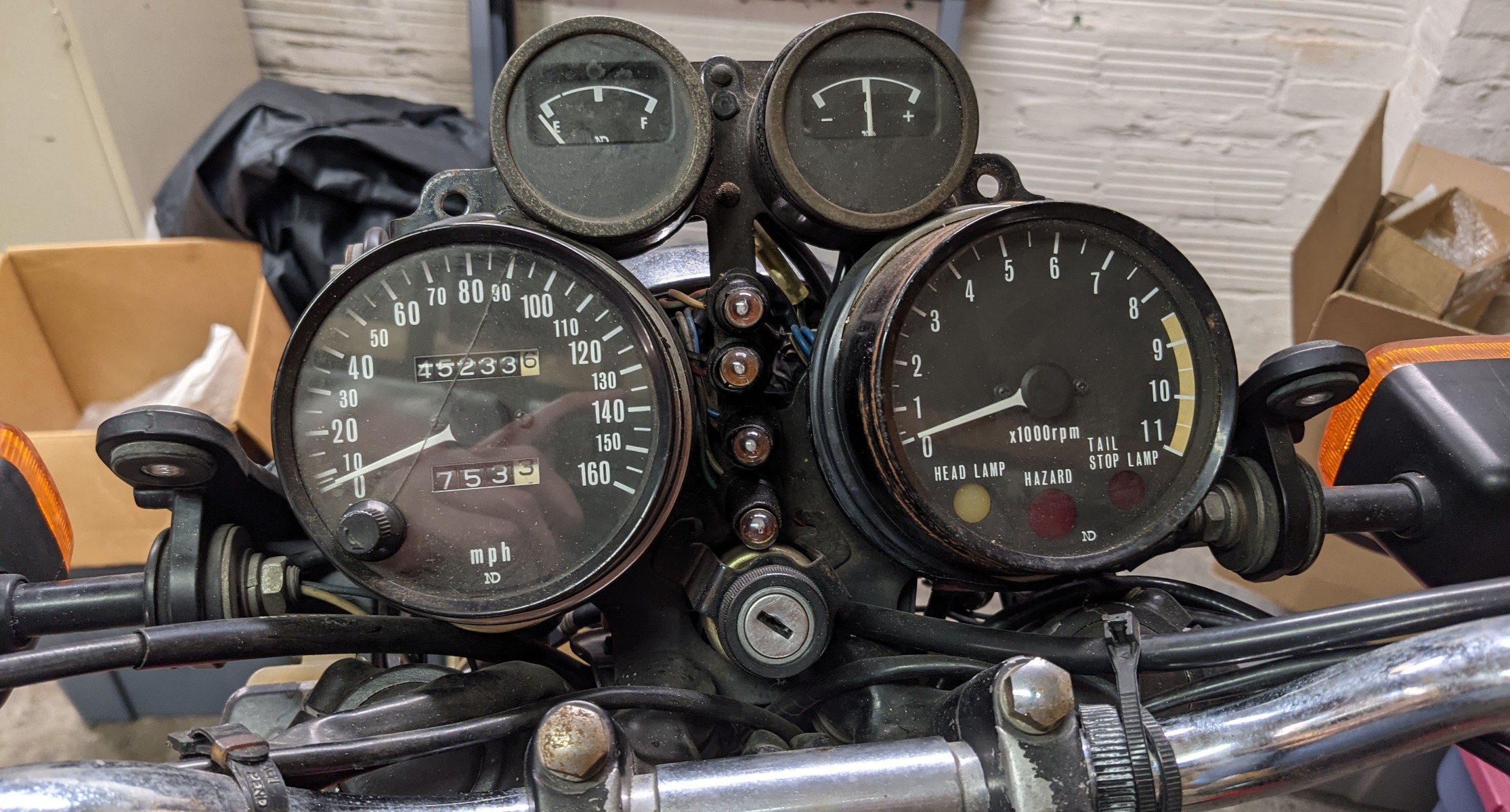

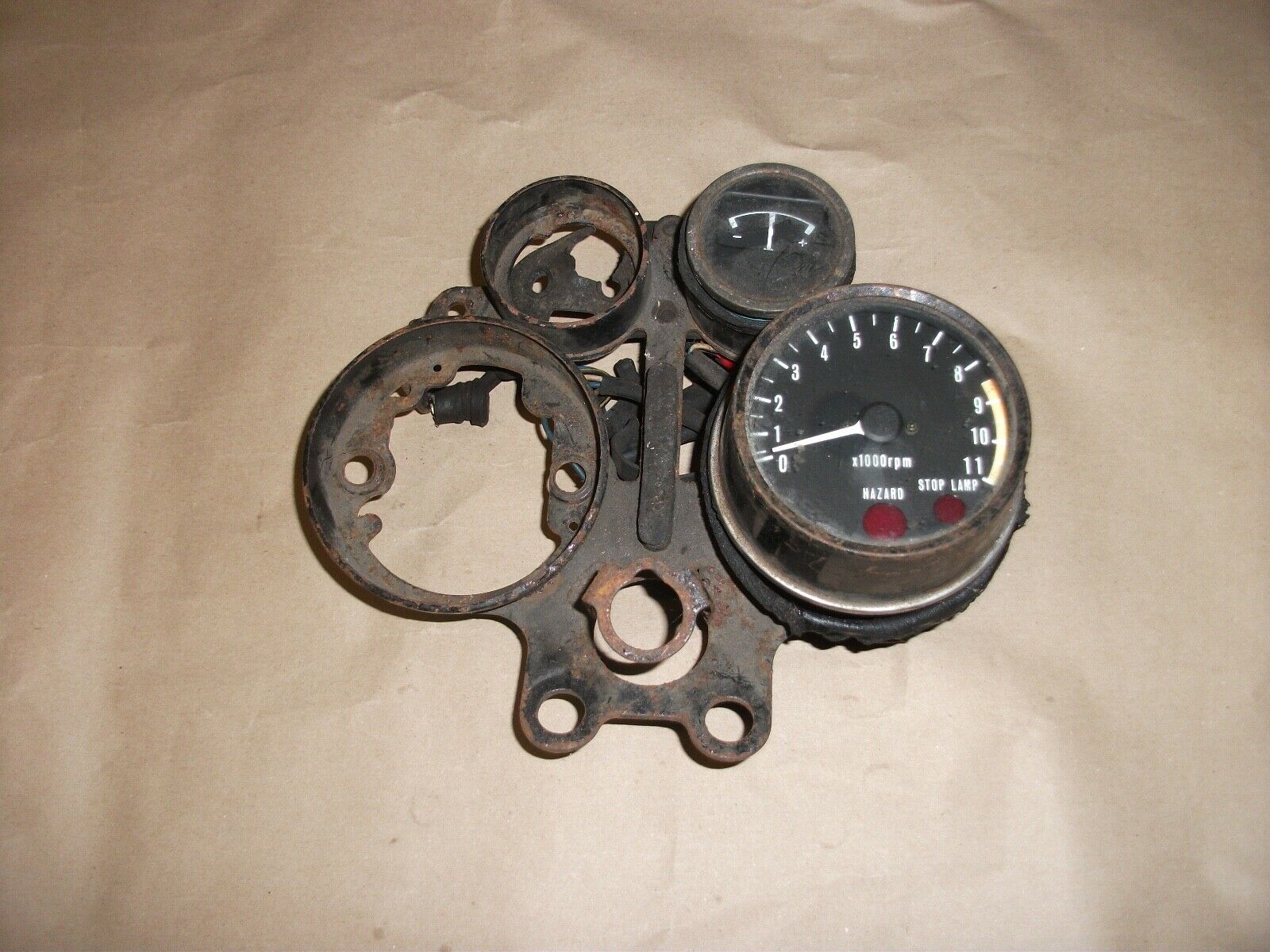

Doremi makes a reproduction of the dash panel, so that should be pretty straightforward to find. Original Z1R gauges might be hard to come by, but if you're making a custom bracket you could probably adapt stock KZ gauges to line up with the dash cutouts for the tach/speedo.

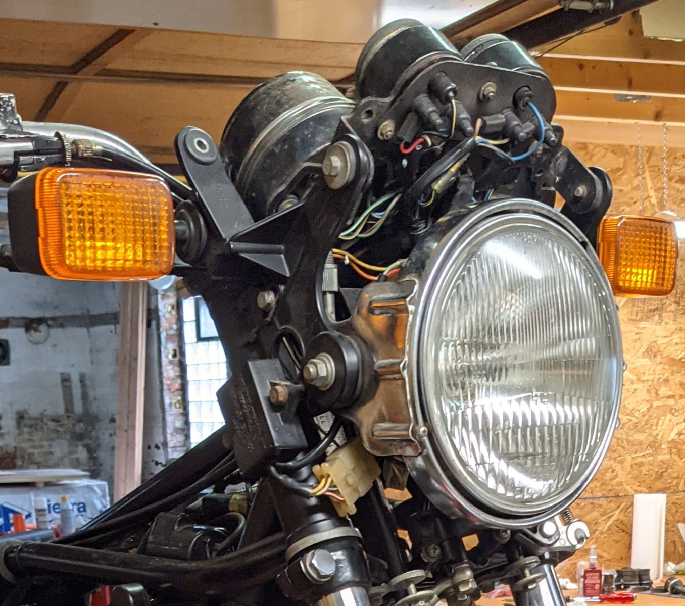

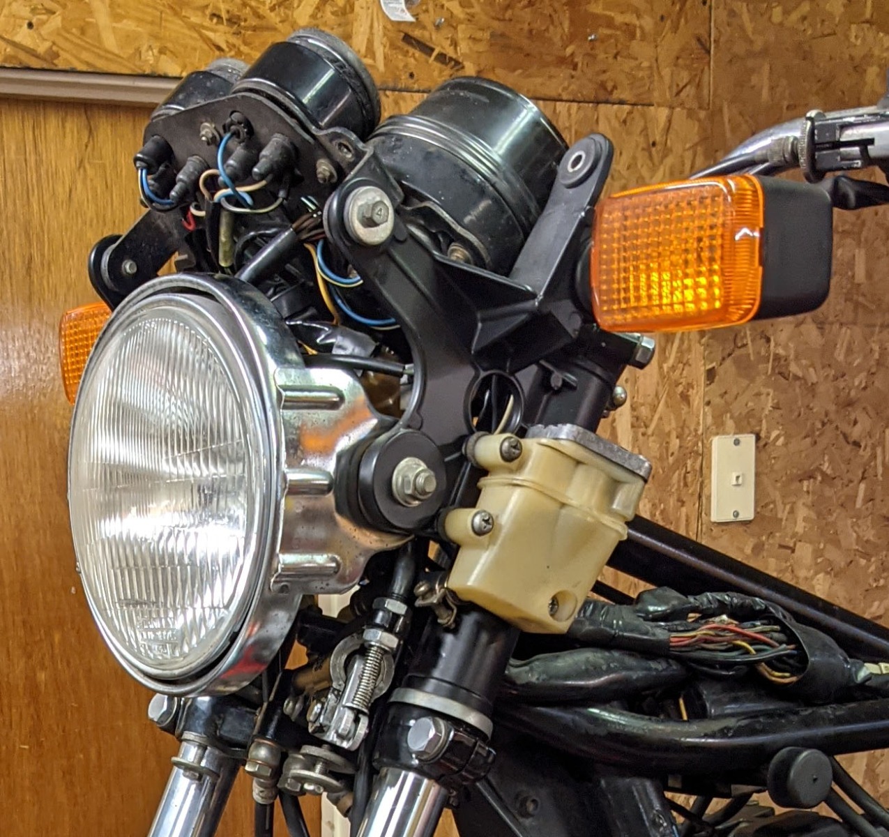

Another thing to note is that the Z1R top triple clamp has different gauge mounts than a KZ. It's threaded from the underside to bolt to the sheet metal gauge bracket, and does not have the rubber grommet holes of the standard KZ.
Also, the Z1R bottom triple clamp has threaded holes for brackets that support the fairing. The fairing has two mounting bolts on the top (one on each ear), and then two on the bottom that connect to the bottom triple clamp.
I can get better pics, but here are some crops of photos I already had.

Ah my friend things make a lot more sence now, those kinda photos just do no exist on the Internet, Iv been trying to piece together how it all works in my head. I will be having a triple tree clamp made especially as im using 45mm showa forks, so i will design in the mounting holes. My a pieces will be cut from 5mm mild steel and welded onto 2mm tube with a 46mm i.d. The gauges are bought the cost a good bit but i want the real thing and yes i saw that Webike had a reproduction shroud for the gauges and ill ask Santa for that... i still have to make the final bracket for the cowl mount and turn signals but with your photos that makes the job a little easier. thanks!
