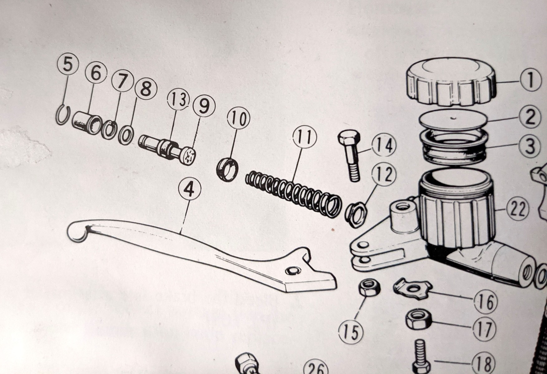

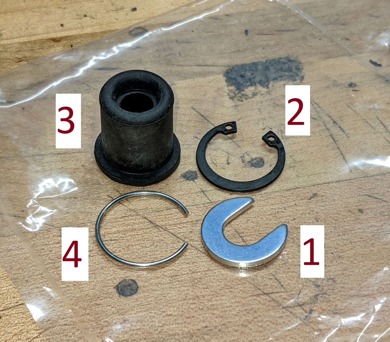

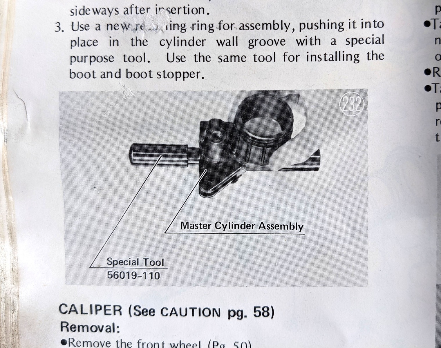

I'm working on assembling a 1974 Z1 front master cylinder. I wanted to make sure I install the various retaining rings in the correct order. Also, the manual shows a special tool for this purpose. Any advice on a substitute for this tool?

Here are the parts. I have labeled them with my best guess as to the order of assembly.
Here are the other images from the manual:

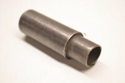

17 Jun 2021 15:15 - 17 Jun 2021 15:16The order of assembly is correct and the tool #56019-110 is nothing more like a tube with a handle grib to push/press the snap rings into the MC bore.I'm working on assembling a 1974 Z1 front master cylinder. I wanted to make sure I install the various retaining rings in the correct order. Also, the manual shows a special tool for this purpose. Any advice on a substitute for this tool?

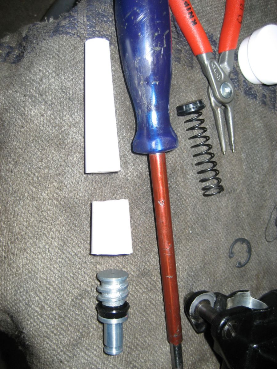

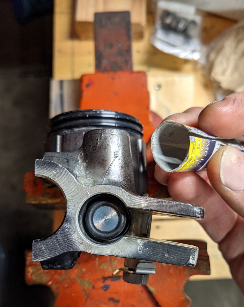

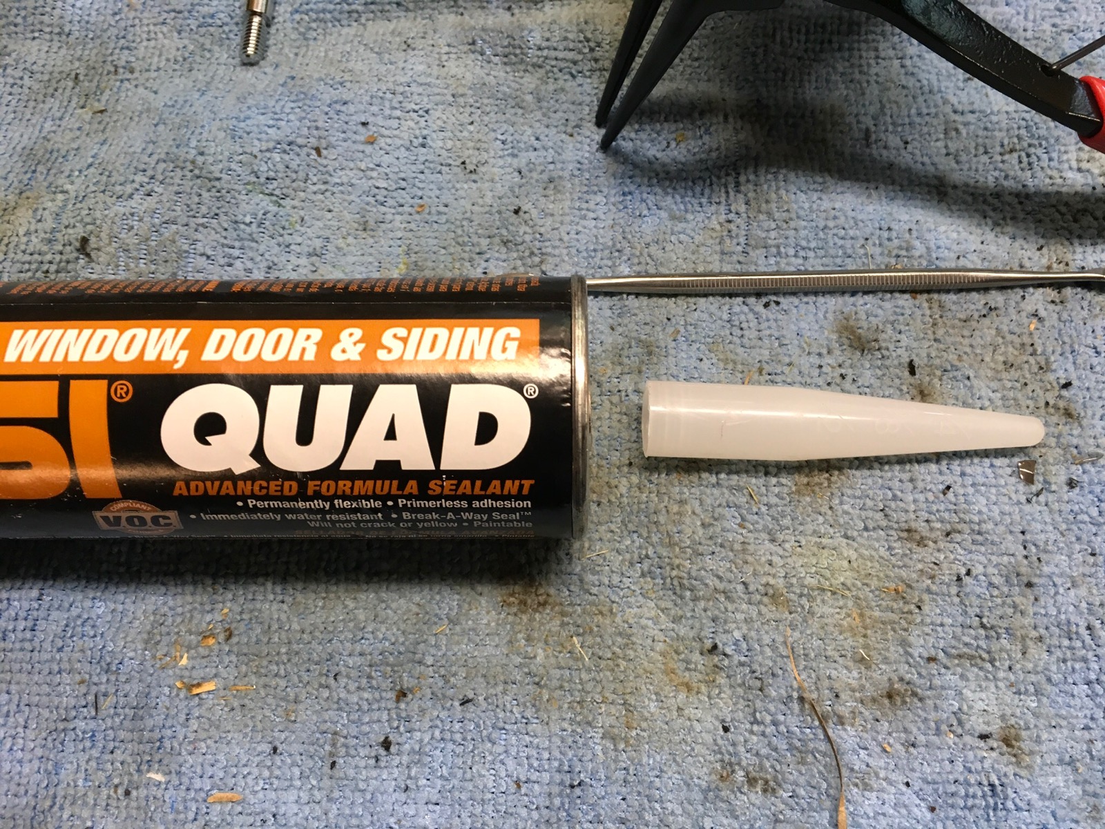

I found a nozzle of a caulk tube that fit over number 3 but inside the mc to push the circlip number 4. Motion pro sells the deep reach internal E-Clip pliers

17 Jun 2021 17:13Mikaw post=850321I found a nozzle of a caulk tube that fit over number 3 but inside the mc to push the circlip number 4. Motion pro sells the deep reach internal E-Clip pliers
Thanks for the tip. I'll see if I can find a tube the right size. I already had to buy the deep reach snap ring pliers to get it apart. The late 70s MC have a similar snap ring, but it's not as reassessed. I also did not realize the boot retaining ring was present until I got the whole thing apart. I think it slipped under the boot when I pulled off the boot, and was up against the snap ring hiding in all the of gunk. Once I got the snap ring off I discovered the other clip, but didn't really understand why it was there. That's why I figured I'd ask before I put it all back together.

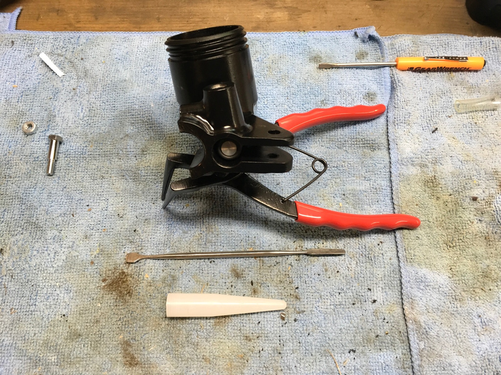

18 Jun 2021 06:40That would never have occurred to me. It certainly was a pain to the get the old piston out, even with the long nose snap ring pliers. However, it wasn't that bad putting it back together. I used those same snap ring pliers, and just pushed the piston in with a dowel to make more room for the pliers.slmjim+Z1BEBE post=850349For future reference, disassembly is much, much easier if the outer end of the piston is snapped off prior to removing the snap ring (circlip).
For the boot retaining ring, I tried to a few things. I tried a wrist pin, but the ID was too small. I tried 1/2" copper pipe, but that wasn't right either. Eventually I just used a rolled up piece of cardboard from a small box that was sitting on my bench. I had to poke it with a screwdriver to get it past the lip where the lever cutout is, but after that I pushed it down some more with the cardboard and it looks to be seated properly.

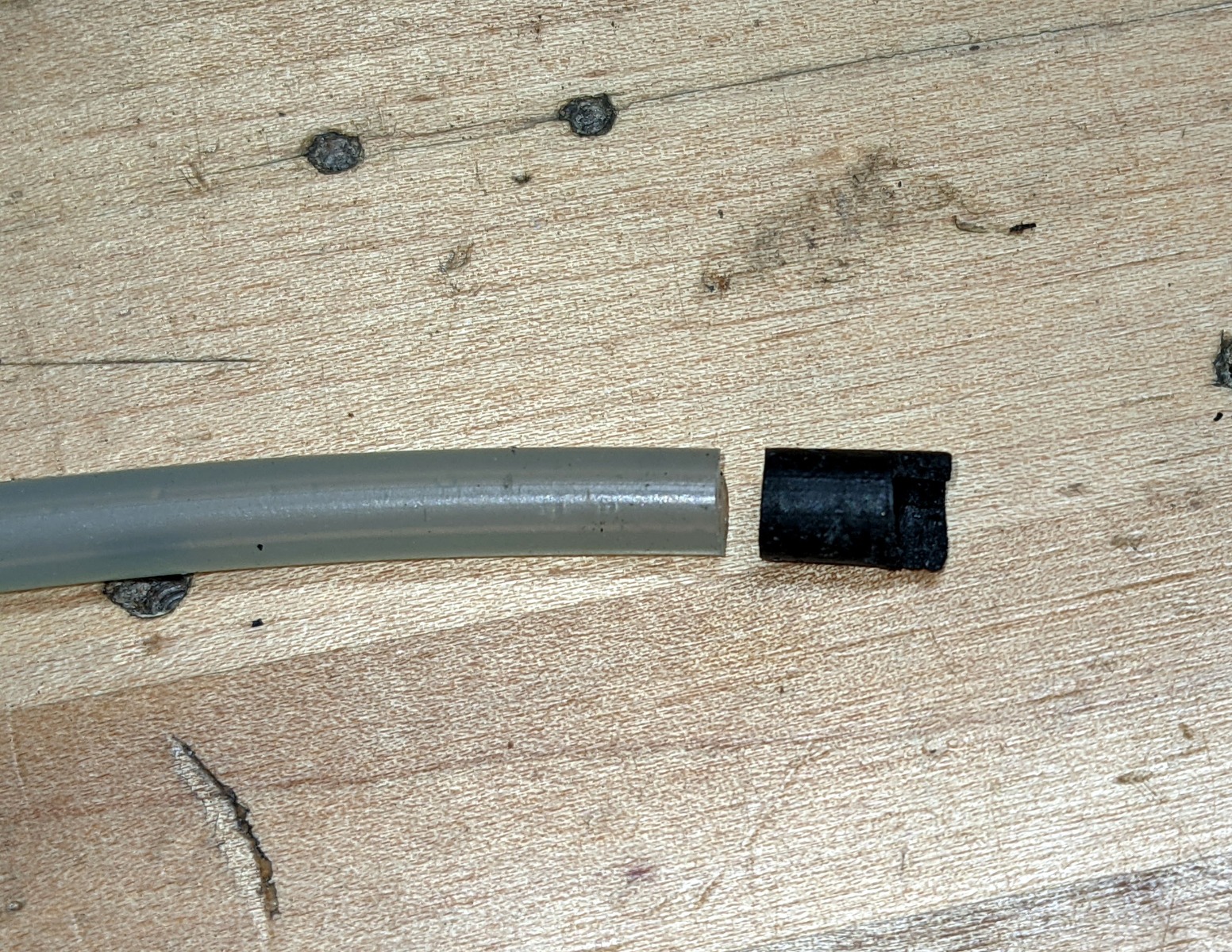

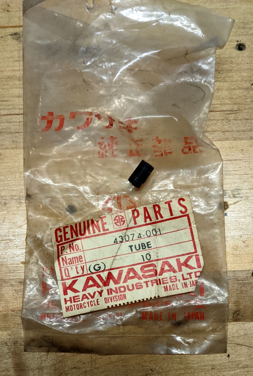

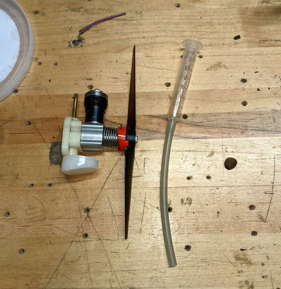

Another issue I had was with the lever stop eccentric adjuster. I bought an aftermarket eccentric bolt, but found an NOS rubber tube. Unfortunately when I tried to install the bolt, my fancy vintage rubber tube tore in halt. Oops. Fortunately I had been toying with an old Cox airplane engine the other day and had some silicone glow fuel line sitting on my bench. Turns out it's pretty much exactly the same size, but more compliant so it survived getting smashed around as I treaded in the eccentric bolt.

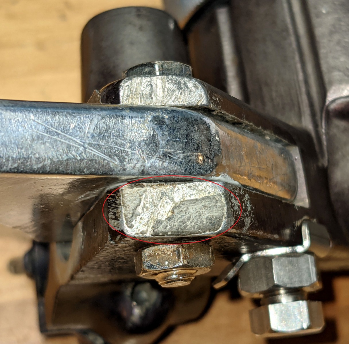

One more random question. When I was cleaning up the master cylinder, I noticed the machined ends of the lever mount ears had some kind of putty covering the surface. I removed some of it before I realized what it was, and then wasn't sure if it was supposed to be there. I left what was remaining. Is there supposed to be some kind of putty covering this surface? Did I remove some factory finishing? I can't think of how it would have come to be on mine. That would be a weird thing to add.
