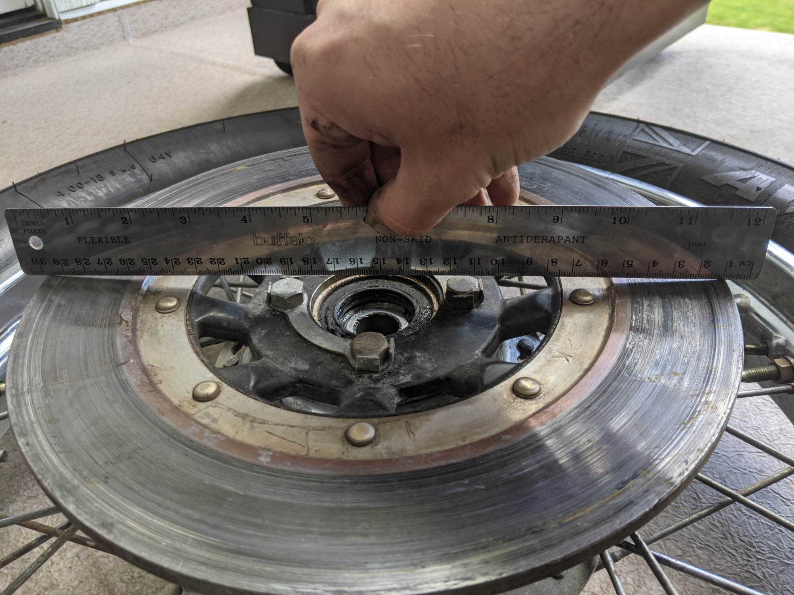

Yup. Rotor is cupped beyond saving. I'm having it machined down a bit anyway so it will at least stop rubbing on the caliper and I can move the bike.
My theory is that the outside piston seized, causing the inside piston to push on it while it heated up, causing the cupping.

If you're going to have the disk resurfaced, I would consider sending it to truedisk.
truedisk.net/
He's all set up for this, his prices are very reasonable, and the quality is excellent.
Also, it might be worth measuring the disk to try to guess if you'll be under the minimum thickness. There isn't a lot of extra, and yours looks pretty bowed.

Had it machined locally already. Says he has to take about 100 thousandths off. Looks like it in spec in the middle, but a little under near the edge. I've already ordered new EBC rotors anyway. I really just wanted to be able to move the bike for now without it running in the caliper.

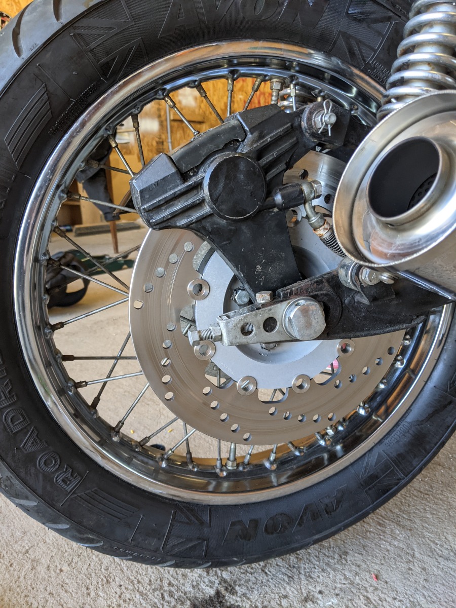

So even with the rotor machined, it was still rubbing on the caliper slightly.
EBC brake rotors arrived and installed today. These fit perfectly centered in the caliper as they should. (No pictures of the clearance, sorry). That leads me to believe that the old rotor must have warped from closer to the hub too.
Interesting that the EBC rotors are so much thinner than factory. 4.5mm min instead of 6mm minimum. I assume this is for heat dissipation? Having a drilled rotor, it will dissipate heat more efficiently and can thus be thinner. It did mean I had to adjust my rear brake pedal a bit.

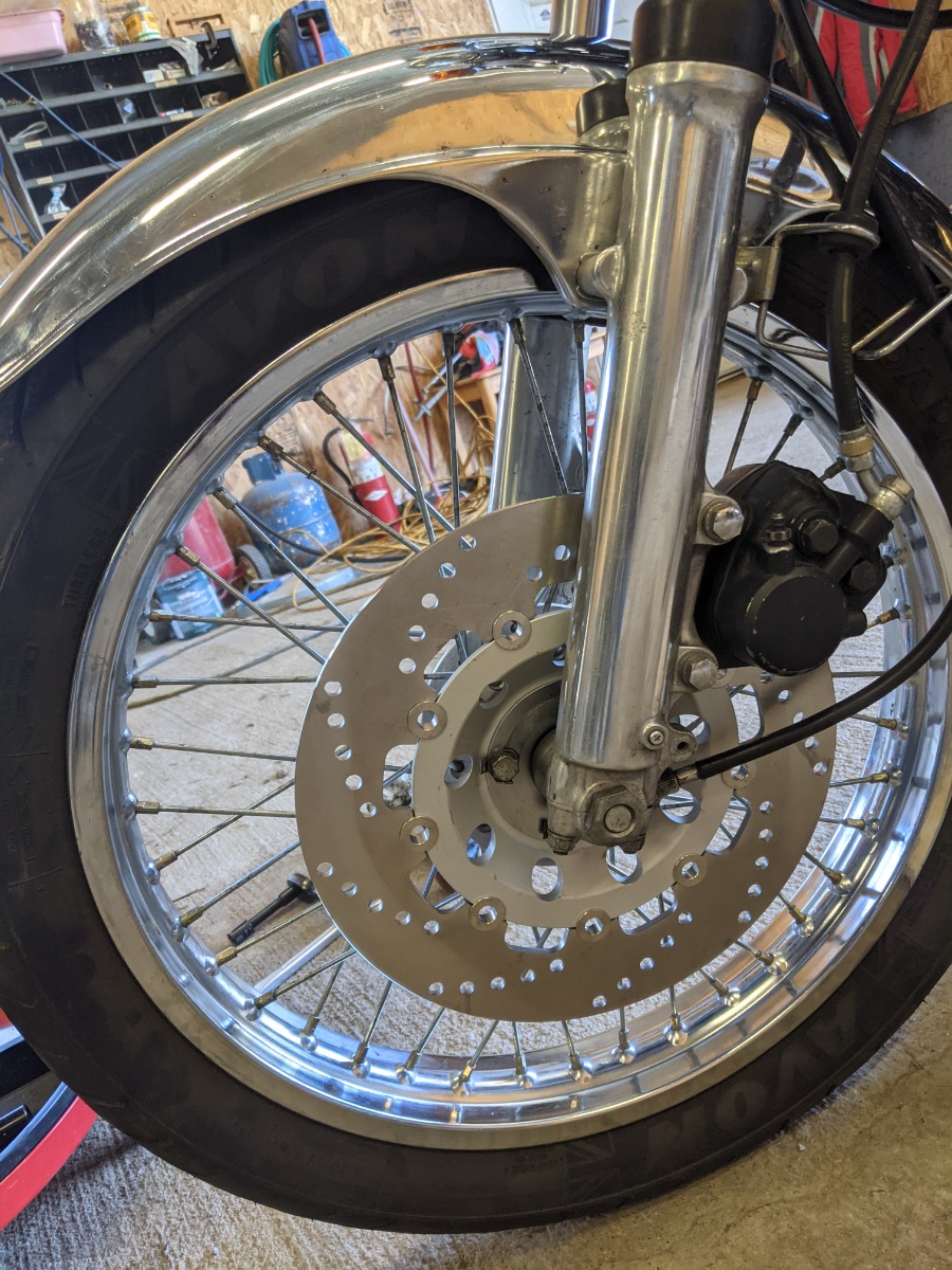

03 Jun 2021 06:09Are both the front and rear EBC rotors 4.5mm, or just the front? I know with the OE rotors, the rotors used on the single-disk front setup are thicker than the rotors used on the dual-disk bikes. Any chance you ordered a front rotor intended for the dual-disk bikes?Interesting that the EBC rotors are so much thinner than factory. 4.5mm min instead of 6mm minimum.

20 Apr 2022 09:44Are both the front and rear EBC rotors 4.5mm, or just the front? I know with the OE rotors, the rotors used on the single-disk front setup are thicker than the rotors used on the dual-disk bikes. Any chance you ordered a front rotor intended for the dual-disk bikes?Interesting that the EBC rotors are so much thinner than factory. 4.5mm min instead of 6mm minimum.
Kaylinator, you never responded to my comment. I still think you're using the skinny dual-disk part in a single-disk application.
