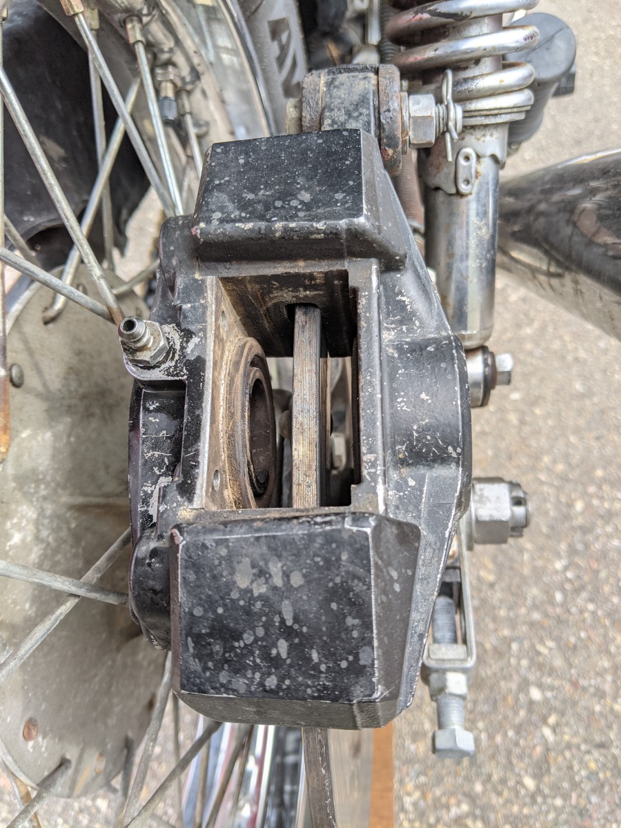

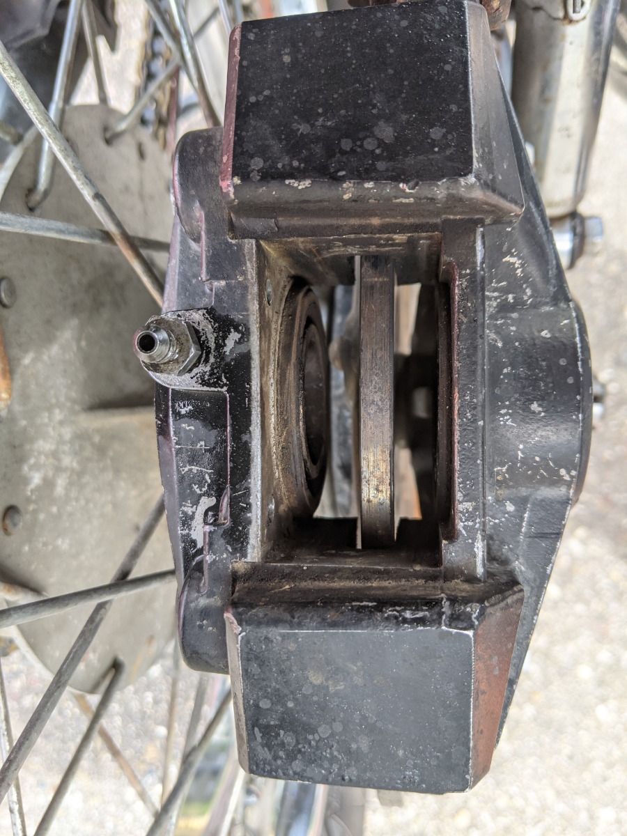

Hey there folks. I'm once again in desperate need of your assistance.
Since rebuilding my '78 KZ1000, I've had issues with the rear brake locking up on me. It happened twice early on. I pulled apart the master cylinder, and the relief port was plugged. I fixed that, and it worked fine for a little over 1000kms, but it happened to me again last night, while on the highway. I got off as quick as I could and cracked the bleeder. The fluid was boiling, and she was smoking enough that a concerned citizen turned around to offer me the fire extinguisher out of his truck.
Today I was pulling apart the rear brake caliper to try to diagnose what happened. I had one heck of a time pulling the codder pins out as the space between the caliper body and the outside pad was nearly non existent. Basically, the outside pad was edged tight between the body of the caliper and the brake rotor.
In order to remove that outside pad, I had to loosen up the axle to make enough room for the pad to slip out.
I then noticed that entire caliper is off center from the rotor, as if I were missing a spacer on the axle between the hub and caliper. I've checked the parts schematic umpteen times, and I'm certain there's no part that I'm missing in the assembly. What could cause this, and how do I fix it?

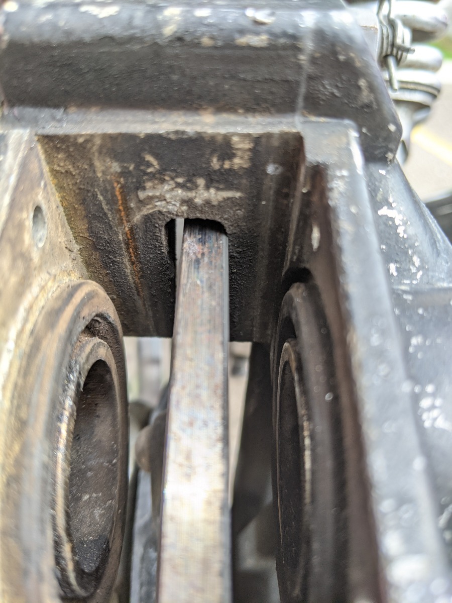

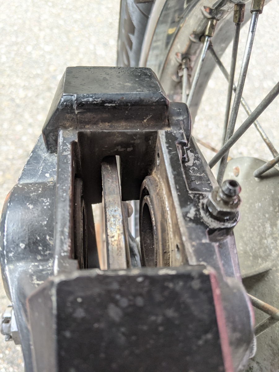

If you look closely at your second pic it seems that the caliper is on an angle, the disc is hard up against the top of the caliper but has some clearance at the bottom, I'd say your caliper mount is bent.... That would have resulted in dragging the right pad and explains the excessive heat....

Yes, Its the same both front and back of the caliper , that's what led me to believe the mount is slightly bent, there's really nothing else it could be.....

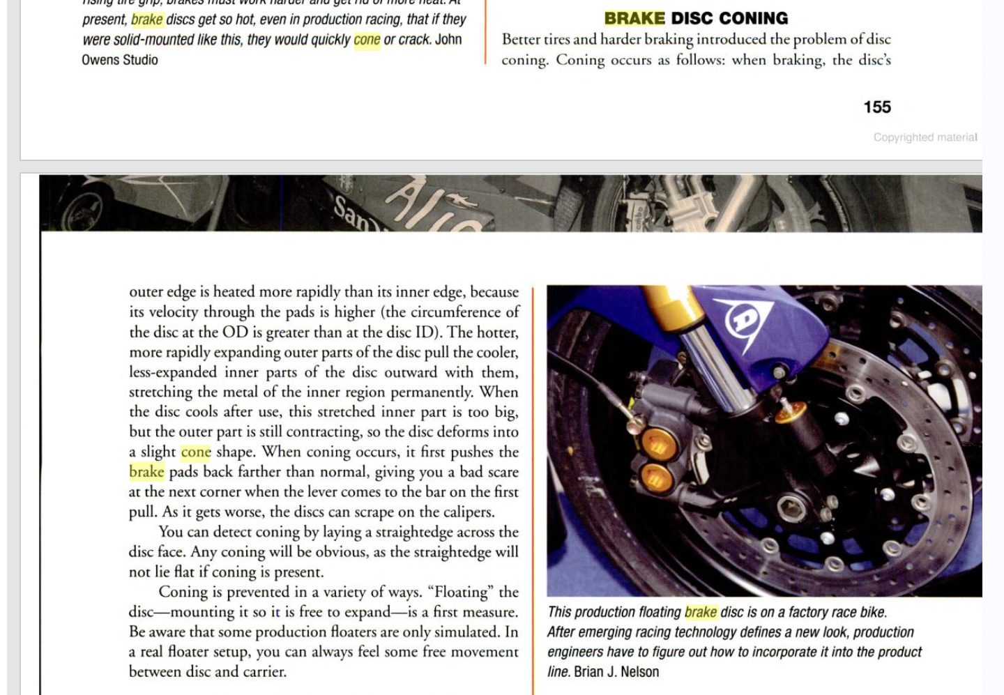

Your rotor could also be cone-shaped from heating of the outer edge.
Place a straight edge across the diameter to check flatness.
You just have to figure out why it happened.

I think 750 R1 is on it... I thought the same looking at the pictures. If it’s not bent the look at the weld mount on the swing arm. Or the stay arm. Ether could be bent. I think the hole in the bracket where the axle passes would be oval.

I did order the kit from brake crafters with the new pistons. Seems like the right thing to do after boiling it regardless, but look back at the photos. The rotor is rubbing on the caliper itself, not the piston.
