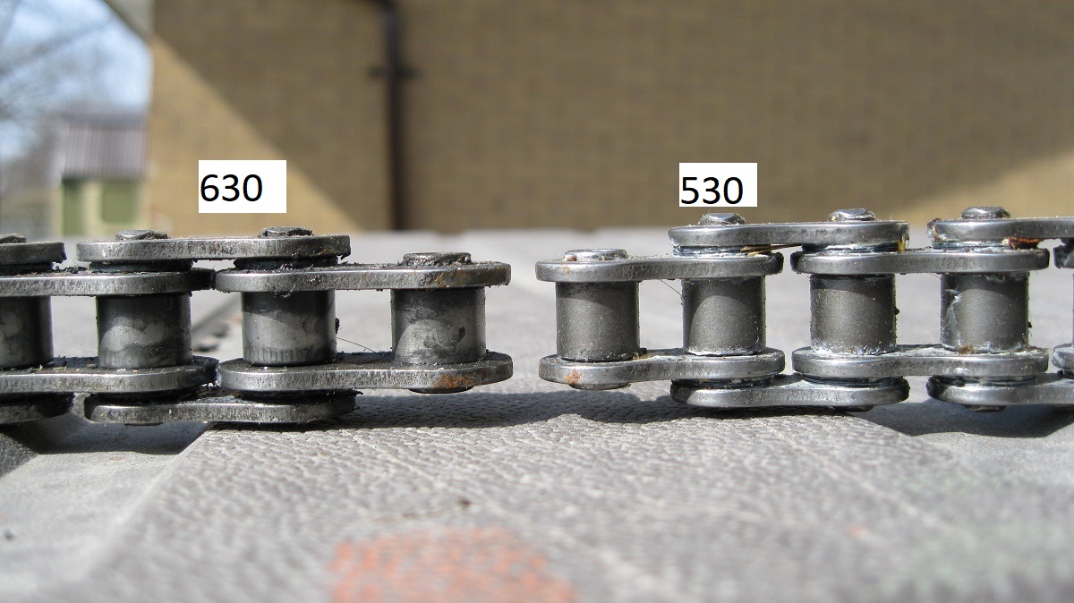

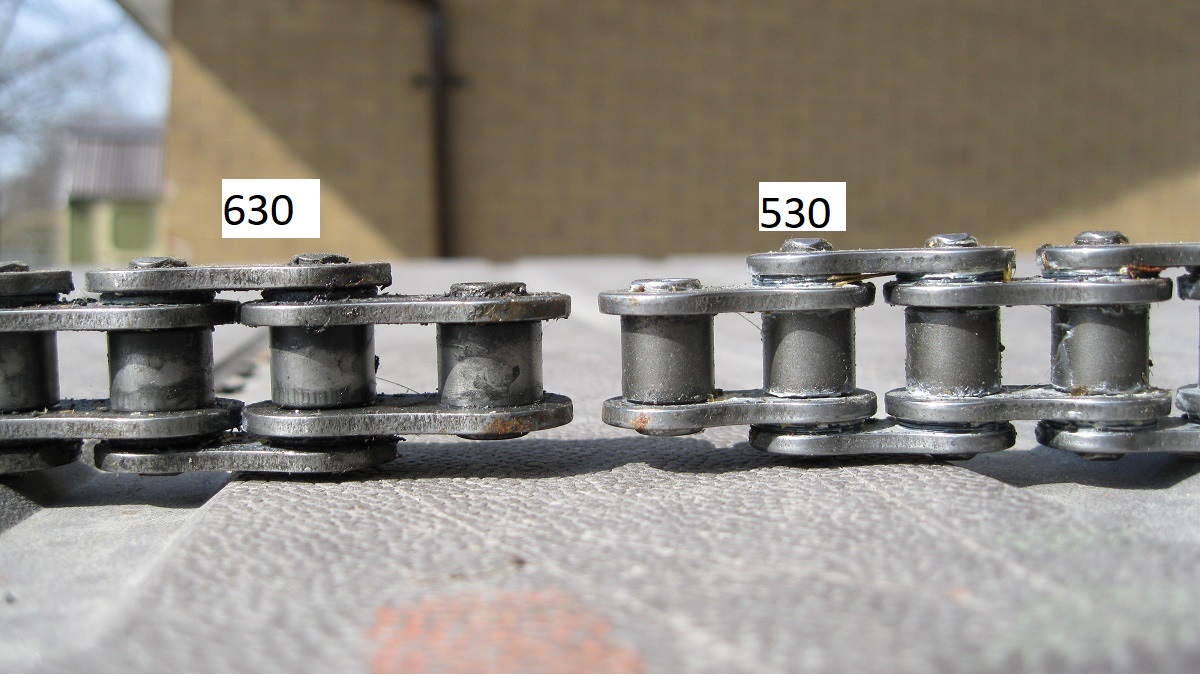

Old 630 and new 530 side by side. The rollers on the 630 are beefier and further apart and the 630 is heavier but the width is the same . - without putting a micrometer on it.
Cant remember where I got the sprockets but think I ended up with one JT and one Sunstar
I made the switch 3 or 4 years ago and I don't believe I have had to adjust the new chain since.
