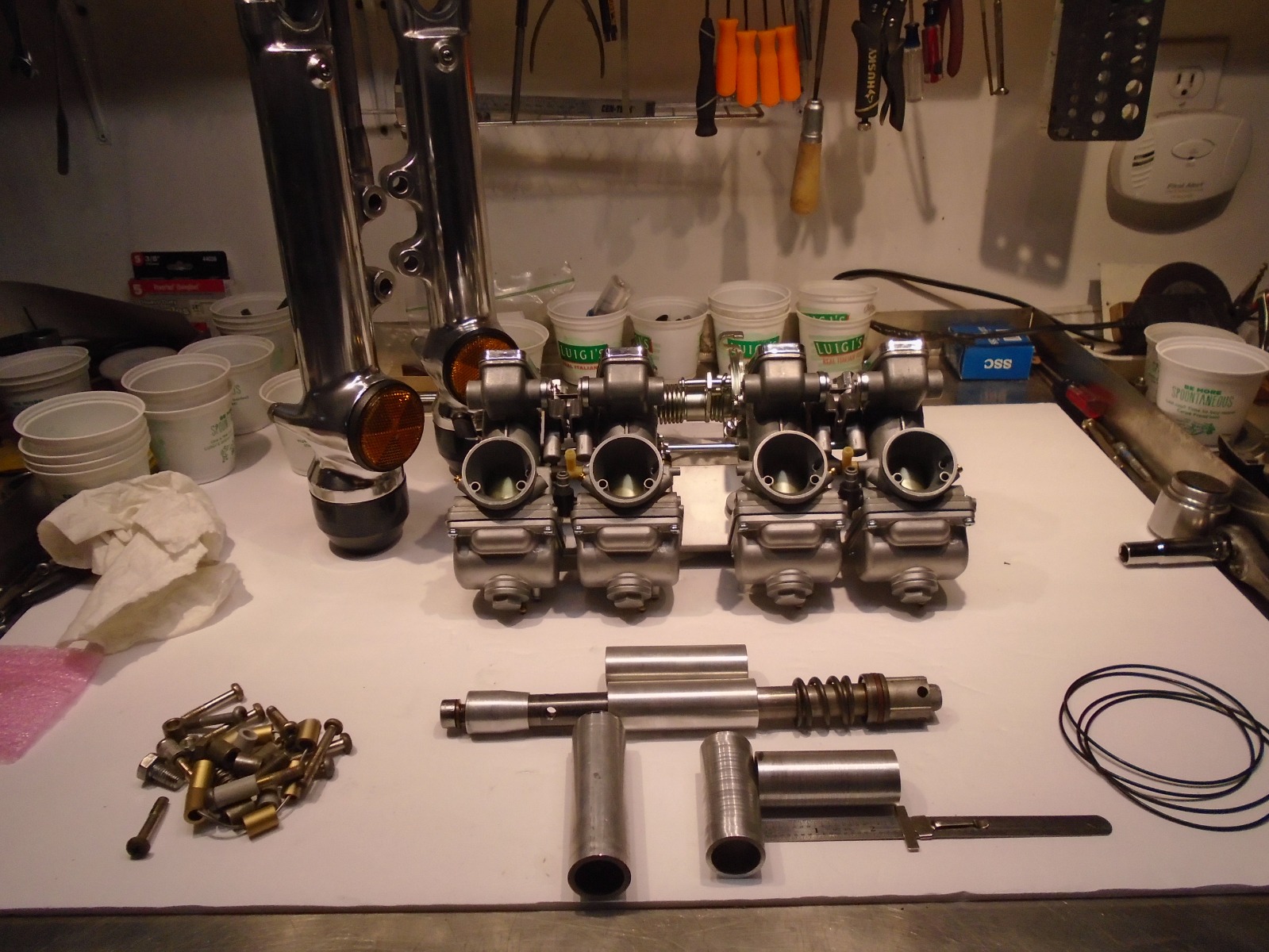

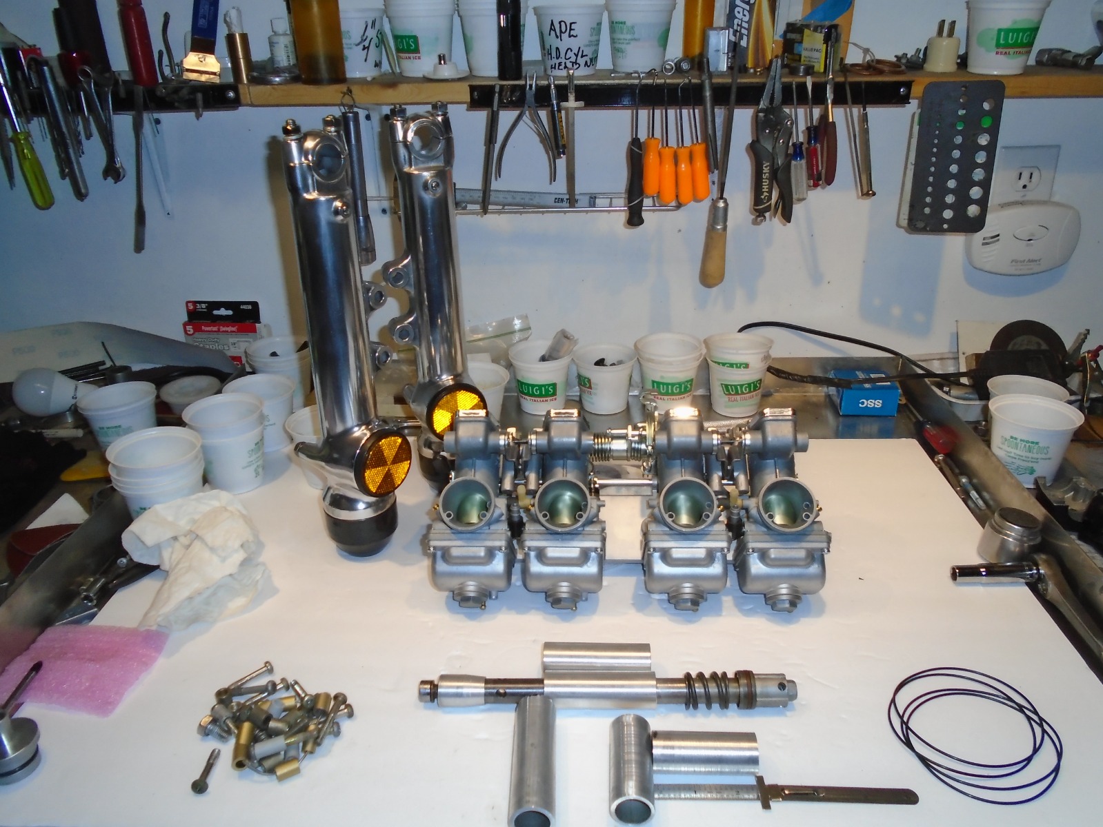

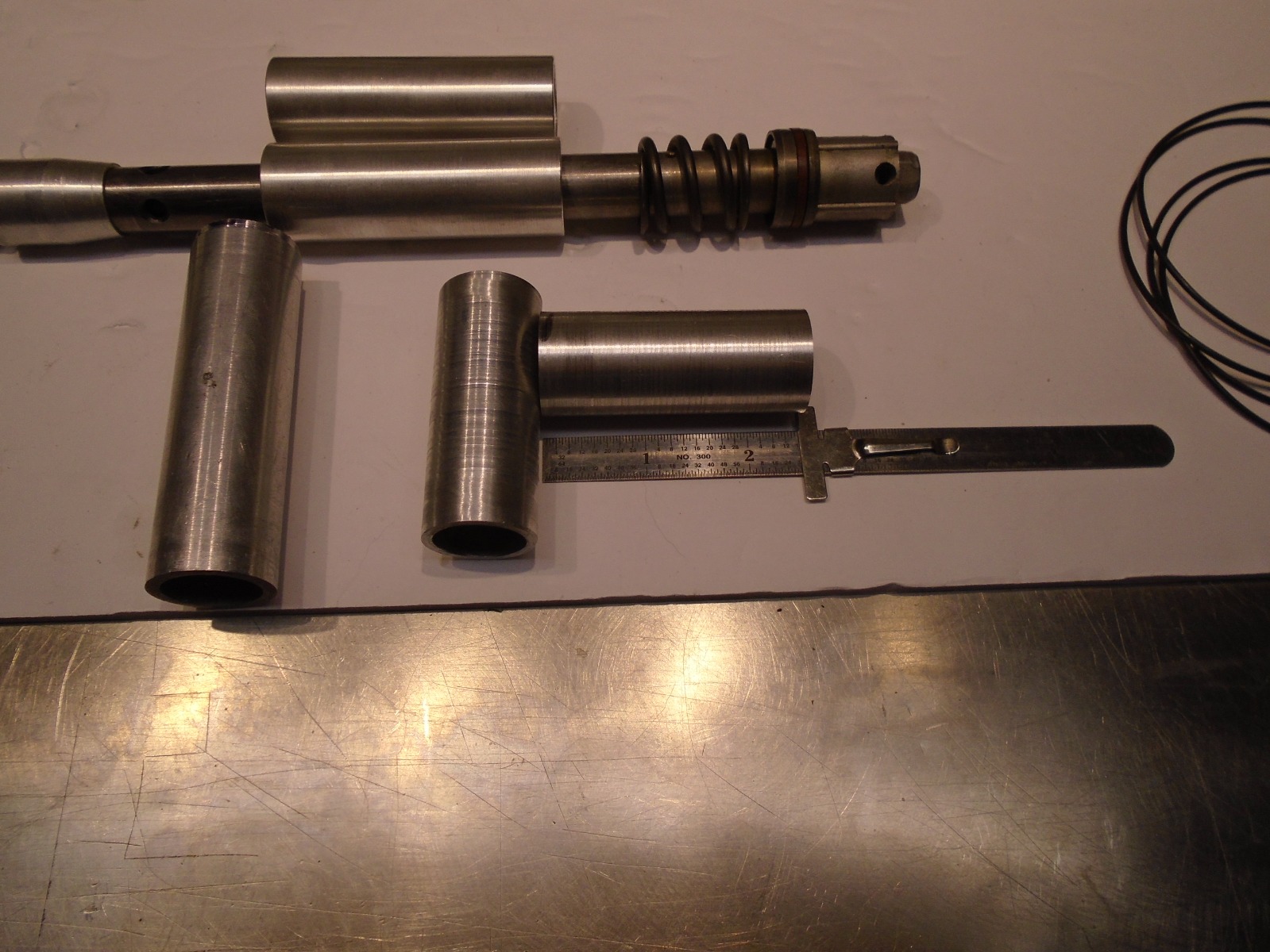

Anyone Lower their front 35mm Z1 / KZ900 / 1000 forks?
With the aluminum spacers they sell 1", 2", 3"? for the drag bike guys.
I made a few. I am using the 3".
I have an extra set of 2-1/2" spacers to put inside for lowering. I will sell them cheap.
