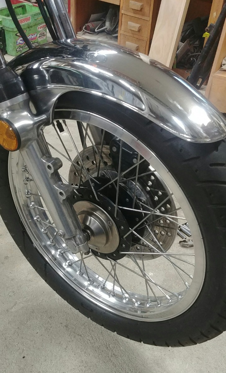

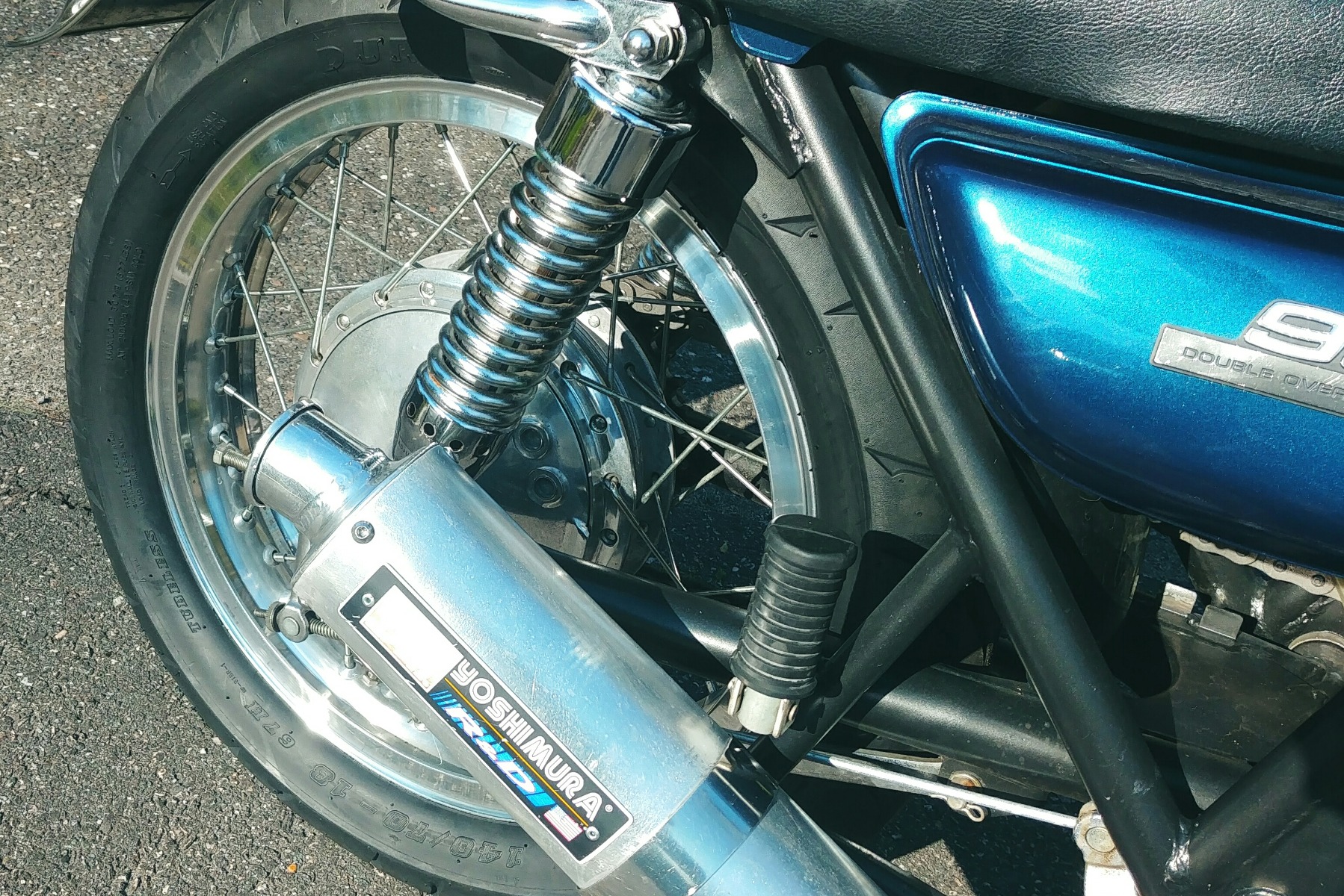

Re: Lacing new rear rim?
03 Feb 2021 18:37 - 03 Feb 2021 18:47Drewgraham89 wrote: I would be fine with 18x3.5 I will probably be going with "sun" wheels. So from what I am gathering is any 40 spoke rim would work? Or does it have to be drilled in a certain fashion to be laced to the hub? Any idea on a spoke length? Tire size for a 18x3.5 on a stock swing arm? This is a cafe build getting an R1 front end assembly with a spoked rim. I have yet to purchase the rim and stem adapter so if someone has a good combination front rear that would be beneficial.
If the hub came from an 18" rim just buy stock spokes. For the rim dont use the Harley type drop center. I used the repro Borrani rims from Italy, search ebay for them. Running a 18x3 and a 140 tire. You'll see when you're lacing the 4 spoke pattern.
