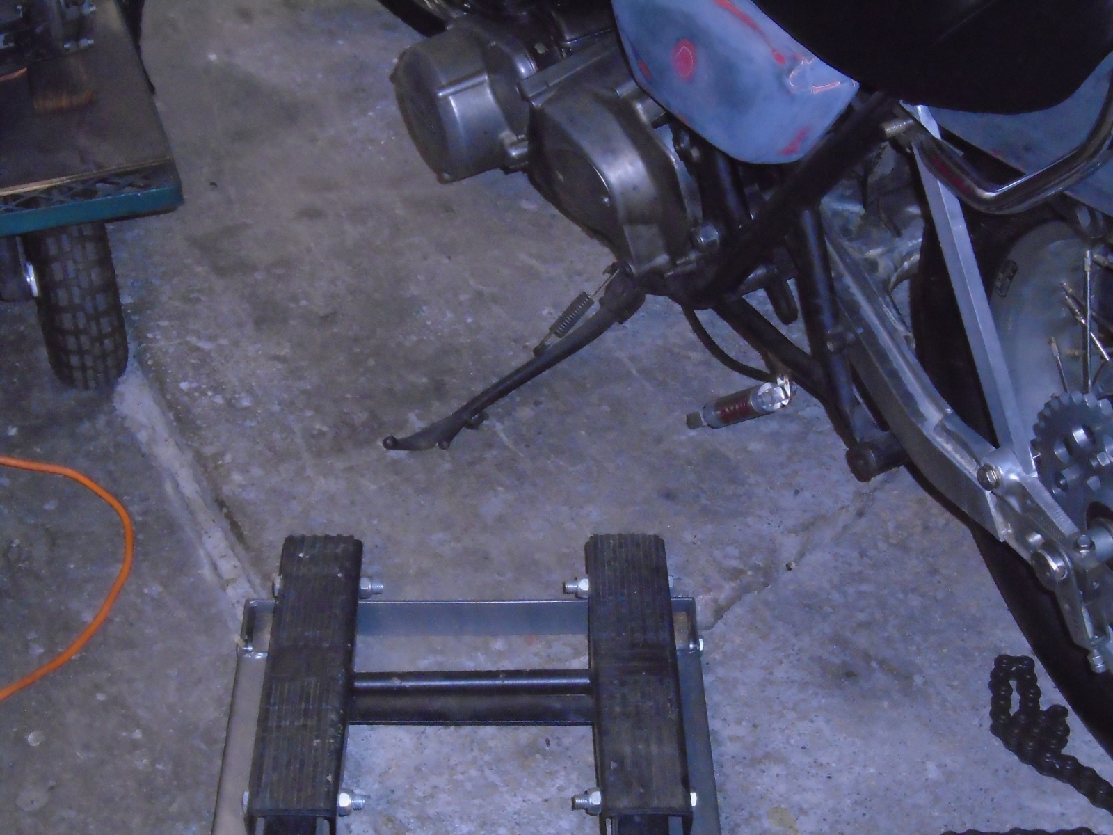

Here's a couple pics of the side stand. So what do you all think?

How long is it?

Pictures are distorted like looking through glasses that are to strong.
My 1978 Ltd 1000 leaned to much, but not as much as your appears to. I swapped in a Kz900 side stand to straighten it up. I’ll measure both and let see what yours measures out at.
EDIT: Added photos.
I made sure the level and the yard stick were parallel and the top of the stand was sitting against the level square. The Kz900 measured 11-5/16” and the Ltd was about 3/4” less at 10-9/16”
EDIT: Added photos.
Last edit: 16 Jan 2021 10:58 by Mikaw.

Again hard to tell but it looks like the side stand might be getting pulled to far forward by the spring, the stop on the frame might have been ground to allow more lean. Looking at the bike from a side view, the side stand should only be about, in clock relationships 6:15 on the big hand. Yours appears to be rotated clockwise too far.

Or a pivot bolt that is to small could cause the same over rotation

It appears my stand is like your stand on the left. About 10.25 to the heel. I think I'll try straightening out the bend and see what that does. After heating red hot, how hard would this be to bend? And should it be allowed to cool slowly or quenched?

I never looked at this one I've had for a year, until I seen your post. This one has a 1970's Detroit, Electra 225, Gangster Lean! :laugh:
