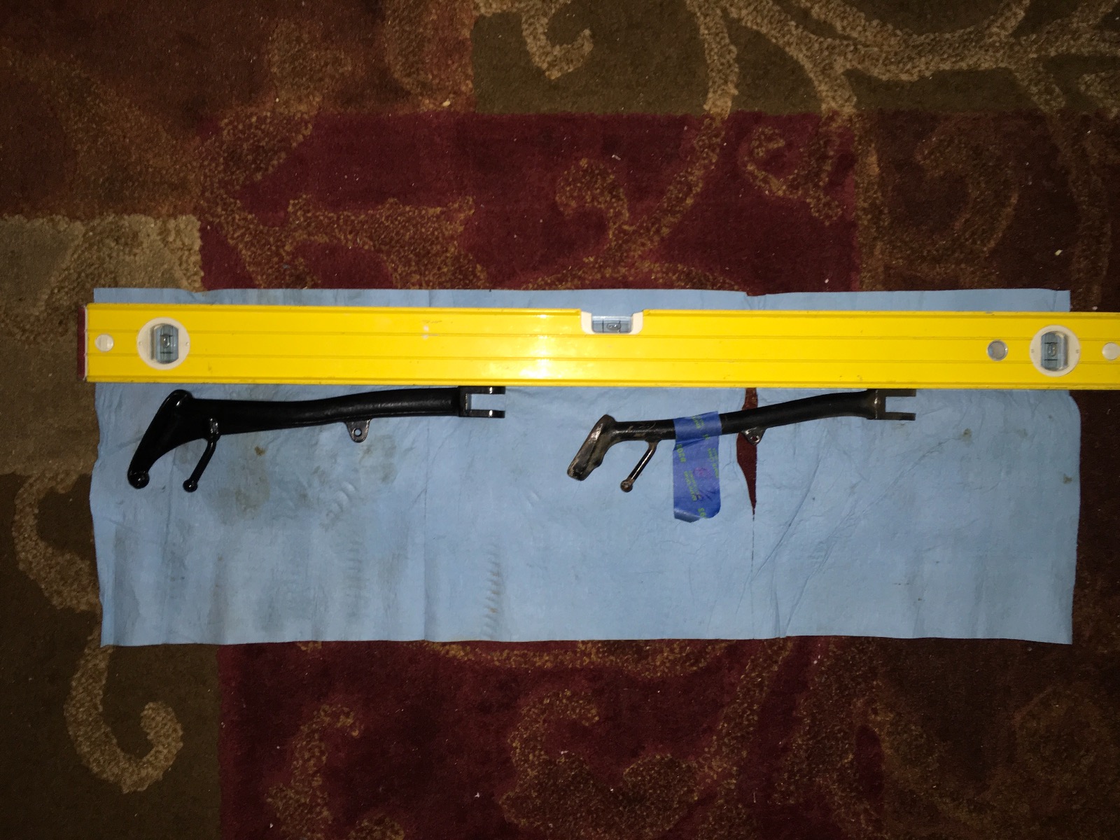

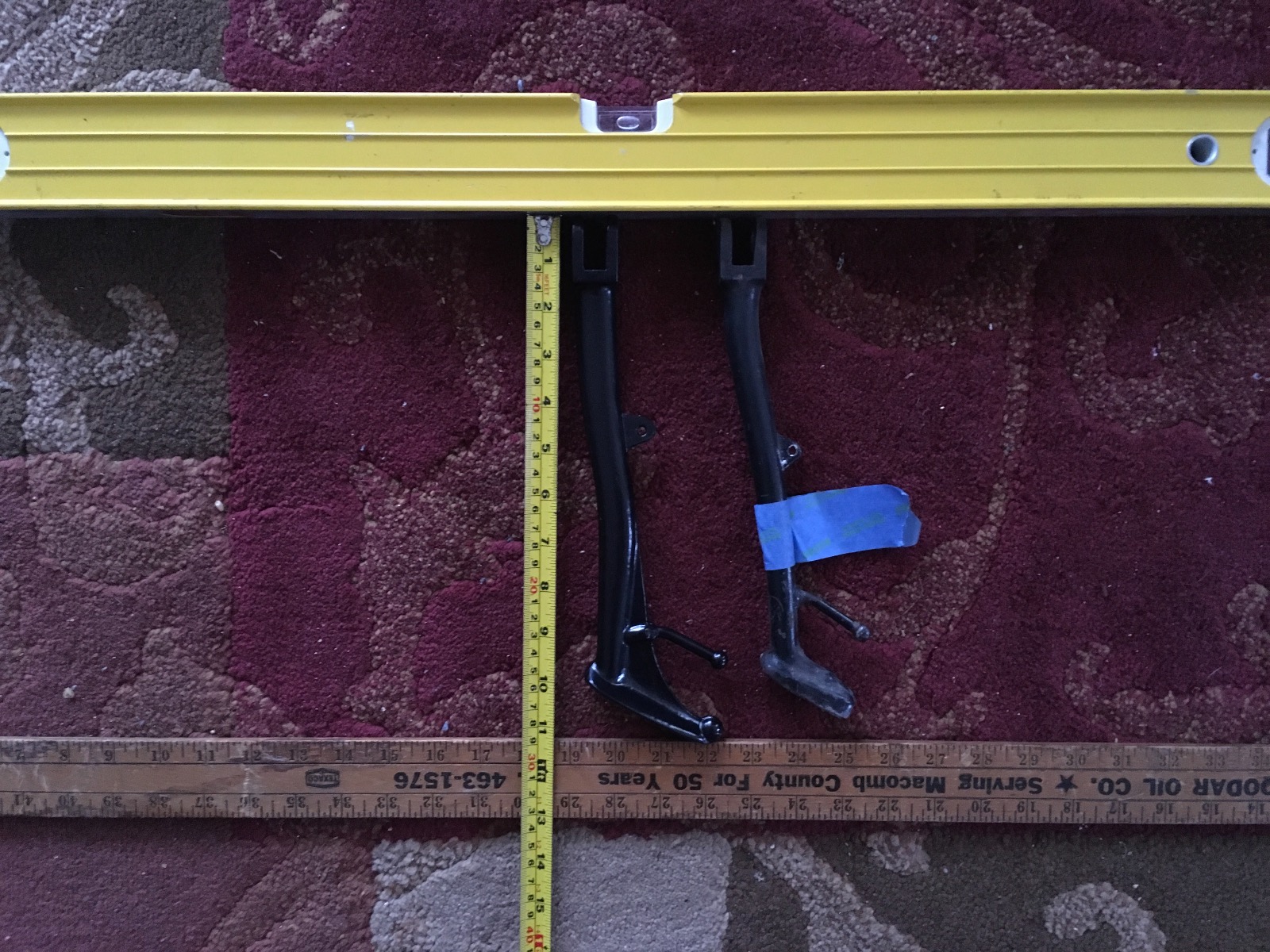

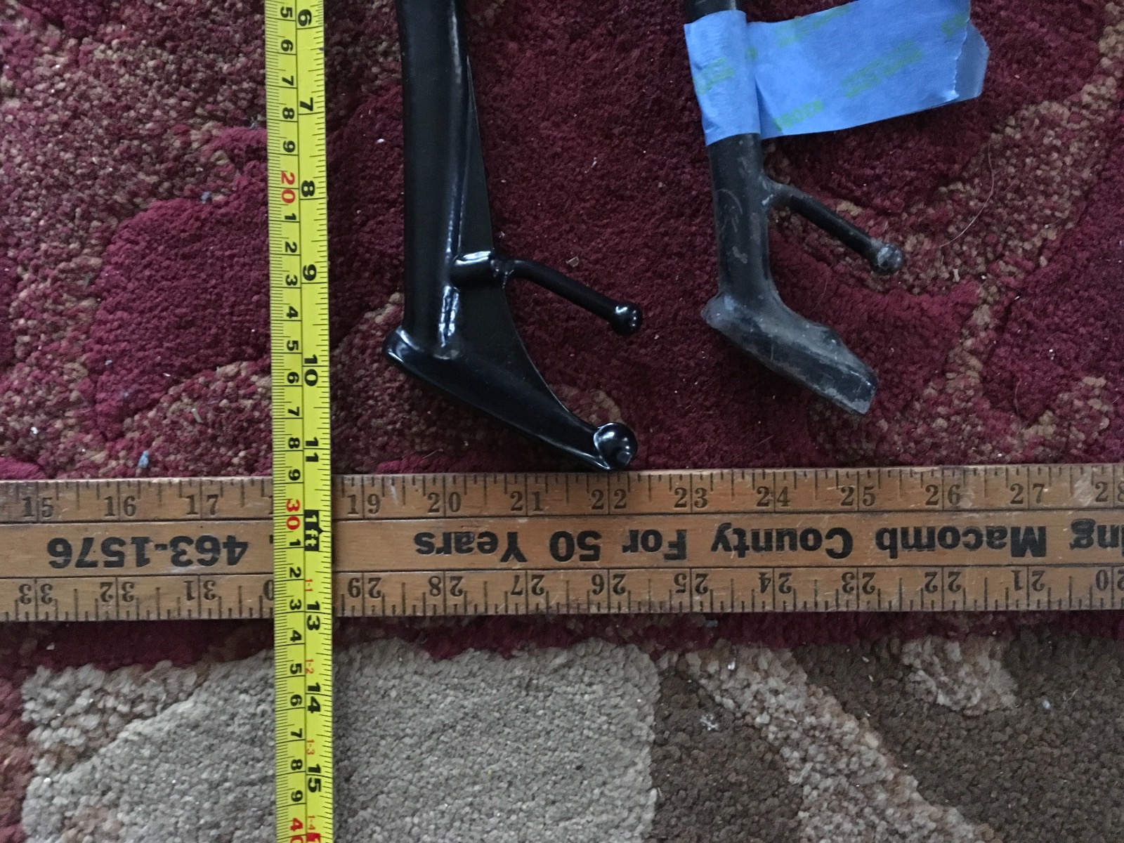

17 Jan 2021 06:44 - 17 Jan 2021 07:27Those are both short ones, I have just measured my thou A series stand and from bolt centre to heel of stand which are the critical measurements it is 10 1/2 inches, a fair bit longer than my ltd stand which is the same as the one on the right, putting those two at around 9 1/2 and 9 inches at the important measuring pointsMikaw wrote: Pictures are distorted like looking through glasses that are to strong.
My 1978 Ltd 1000 leaned to much, but not as much as your appears to. I swapped in a Kz900 side stand to straighten it up. I’ll measure both and let see what yours measures out at.
EDIT: Added photos.
I made sure the level and the yard stick were parallel and the top of the stand was sitting against the level square. The Kz900 measured 11-5/16” and the Ltd was about 3/4” less at 10-9/16”
Last edit: 17 Jan 2021 07:27 by kevski.

17 Jan 2021 10:15 - 17 Jan 2021 10:18kevski wrote:Those are both short ones, I have just measured my thou A series stand and from bolt centre to heel of stand which are the critical measurements it is 10 1/2 inches, a fair bit longer than my ltd stand which is the same as the one on the right, putting those two at around 9 1/2 and 9 inches at the important measuring pointsMikaw wrote: Pictures are distorted like looking through glasses that are to strong.
EDIT: Added photos.
I can agree that is a more accurate why to measure, but look at this. My level it magnetic. sticking the top of the stand to the mag represents 90deg to the povit. The offset will have an effect on lean also what kind of offset is there in the 1000A stand. If it’s more like the LTD than the 900A4 then the extra length has less impact for vertical
Last edit: 17 Jan 2021 10:18 by Mikaw.
