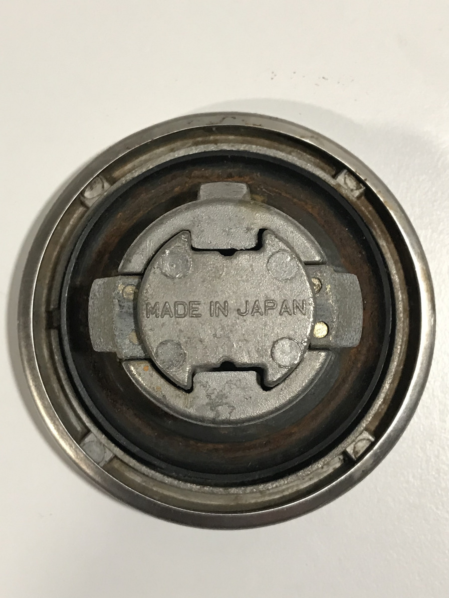

Right, so I was able to find the key *and* the calipers to take some measurements, so here we go.
overall diameter = 71mm
the black O-ring and the metal bit under it = 55mm
the round piece that goes into the tank - the outcropping at the 12:00 position = 34.5mm
the round piece that goes into the tank + the outcropping = 38mm
the two locking pieces when they're out = 41.5mm
the central piece stamped 'Made in Japan' = 26mm
Hope that helps
