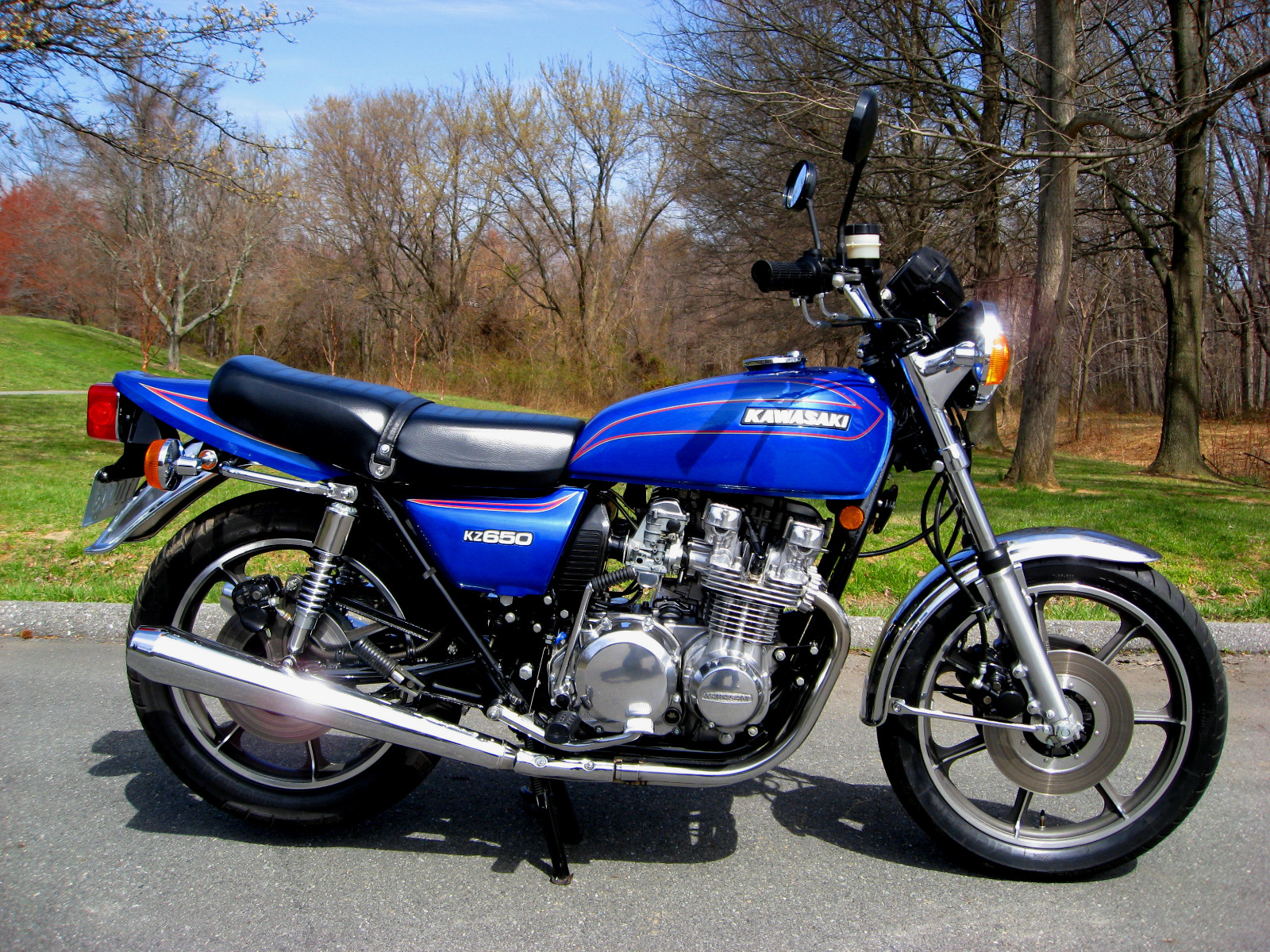

I've put more than 61,000 miles on my 1977 KZ650-C1 and highly recommend the following:
First, the KZ650 original rear shocks were toast after about 10,000 (or less) miles. If your bike has original shocks replace them with quality units. I have been using Hagon shocks for more than 13 years and they still work like new. Prior to those I used S&W shocks which also worked great but did not look similar to stock units.
Second, be sure to buy quality tires. I use Pirelli Sport Demons and they work extremely well. I'm on my 3rd set; they last about 7,000 miles per set.
One other thing - take some time and perform ALL the maintenance listed in the Kawasaki Service Manual. At that point you will have eliminated many small but important issues that may have been neglected. Things like fork oil, brake fluid, etc. can help make a bike perform great or poorly, and if those things have been neglected (and assume they have been) the bike will not perform nearly as well as it should and won't be much fun to ride. The Kawasaki Service Manual has a chart of all the maintenance items and describes how to perform them. Also, assuming your bike has all the original parts, such as airbox, exhaust system, etc., keep those parts on it! The KZ650 was engineered by true professionals and has everything it needs for highly spirited, or even mature, street riding. Also, forget making any changes to the swingarm, frame, forks, etc. especially for street riding! Unlike some earlier KZ models, such as the KZ900, the frame, swingarm, forks, etc. are easily more than sufficient for highly spirited street ringing. These bikes are engineered extremely well.
Below is a picture of my 1977 KZ650-C1. Ed
