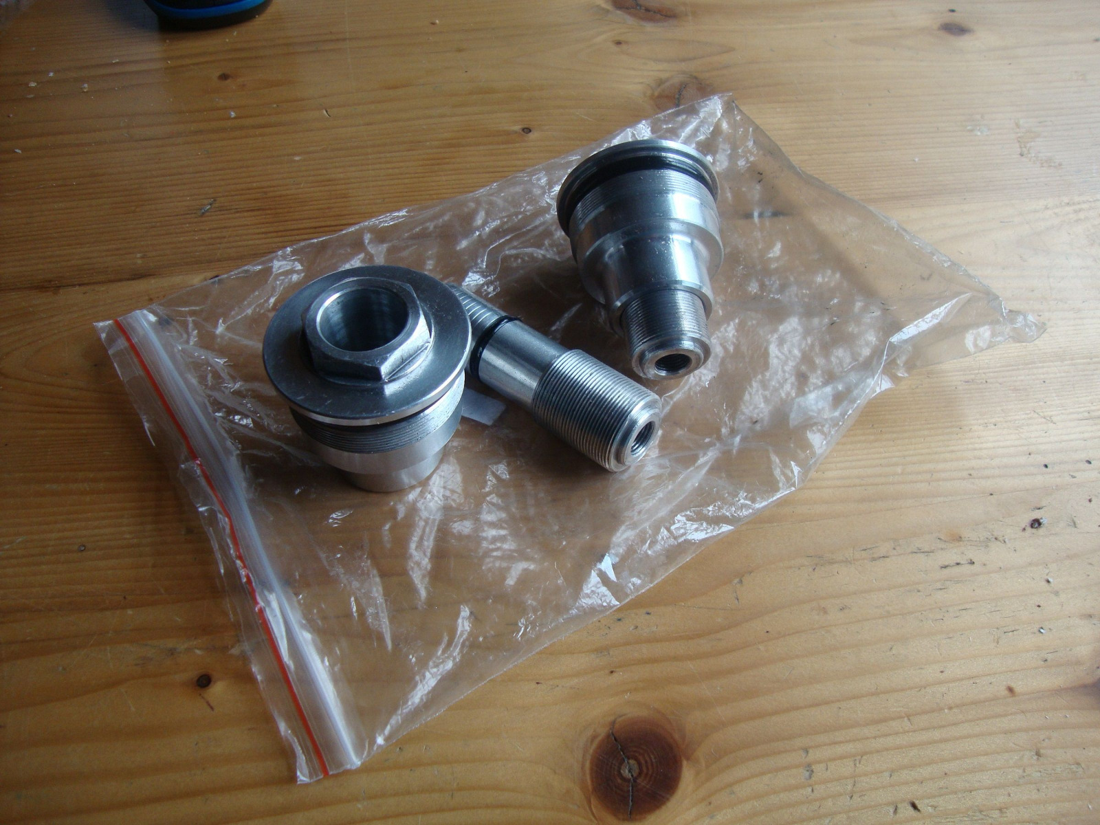

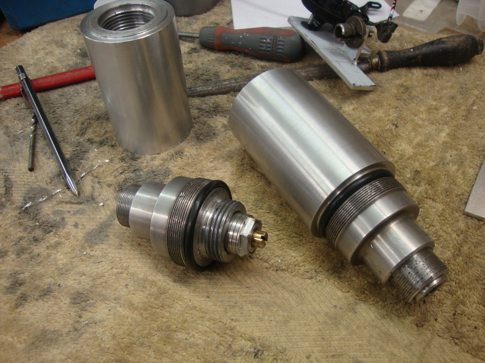

07 Oct 2020 00:27Mikaw wrote: Why wouldn't the fabricated ones work. the smaller pieces screws onto the bottom of the damper extending it and the large diameter piece extends the USD top tube.
Looks just like the one Zed1015 made up.
Sorry my bad, I read that he was going to extend the lower tubes and not the cartridge but Steve if you are going to lay out a few hundred bucks on lower tubes anyway take a look at the web site for the above mentioned extension kit, 270 usd and little or no fabrication time, not saying one method is better than the other but the upper extensions are less hassle.

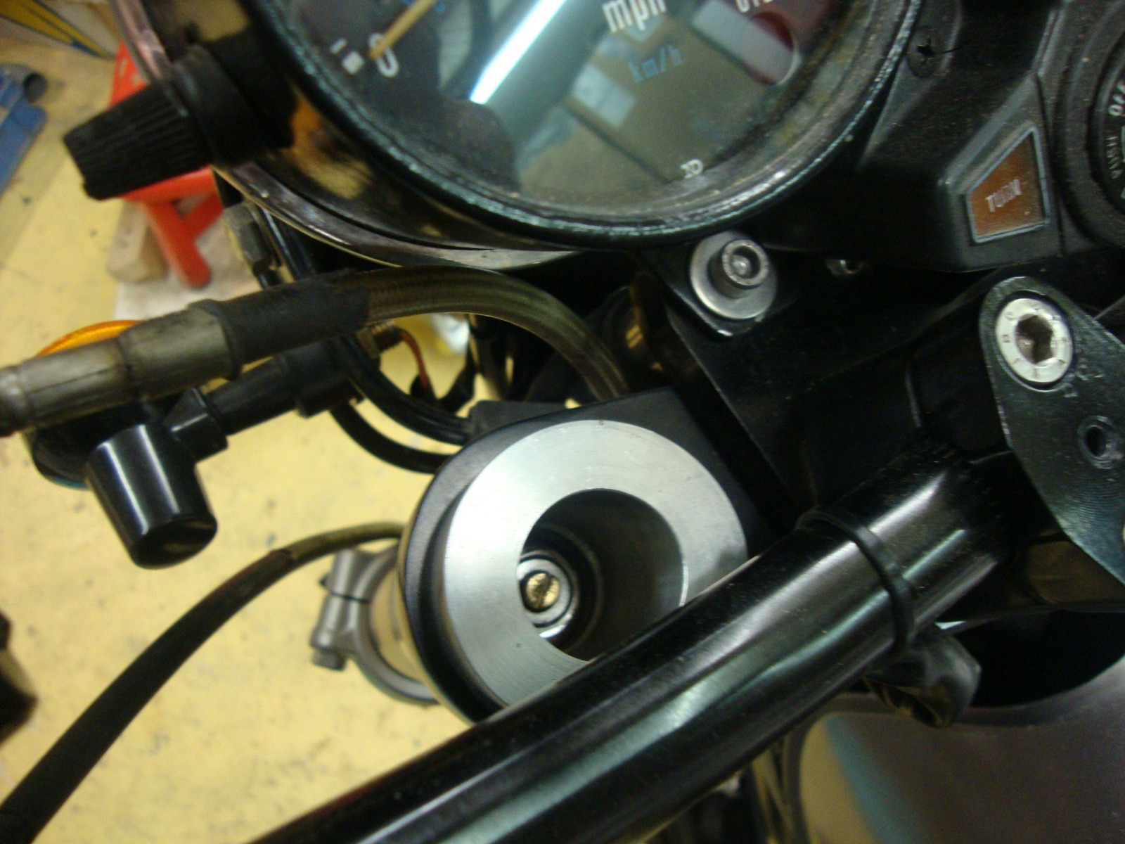

07 Oct 2020 00:30davido wrote: Here are my ZX9R extensions. A Local bike builder machined the original tops down and threaded the extensions,outside and in, so that the internal length stayed the same and the original adjusters could still be used. (A bit awkward to get to but how often do you want to adjust them?). I got them a couple of cm over length to give the possibility to raise /lower them.
That’s neat work Davido, do you mind if I ask the price tag on these were, I am heading to my machinist mate later this week and just seeing if he would be interested in making my exactly what you have post there.
