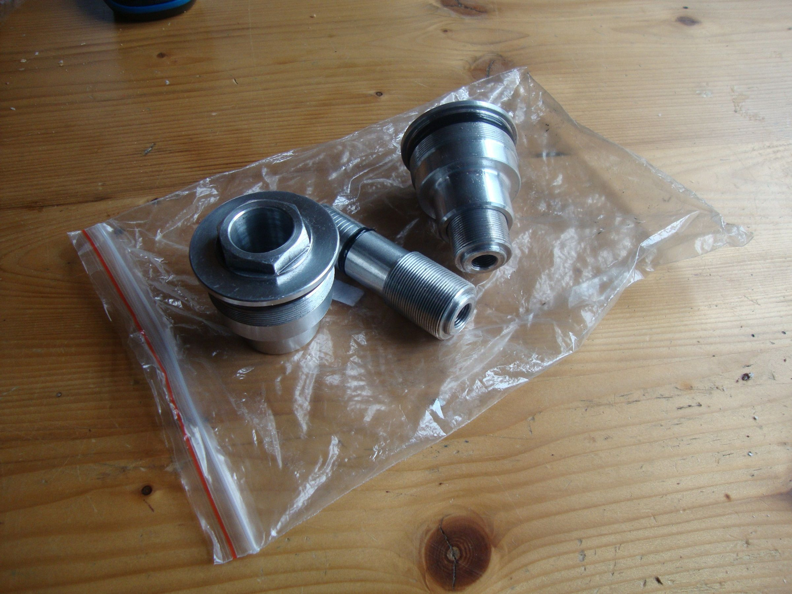

You can internally extend most USD by a maximum of 32mm with a simple damper rod extension and no other mods - see pic's
Any more and you need extensions to the stanctions and longer ones for the damper rod as in the above post. or slugs for the top tubes but you then have to watch out for the fork tapers dropping out of the bottom yoke.
The following user(s) said Thank You: stevefarris6

Why wouldn't the fabricated ones work. the smaller pieces screws onto the bottom of the damper extending it and the large diameter piece extends the USD top tube.
Looks just like the one Zed1015 made up.

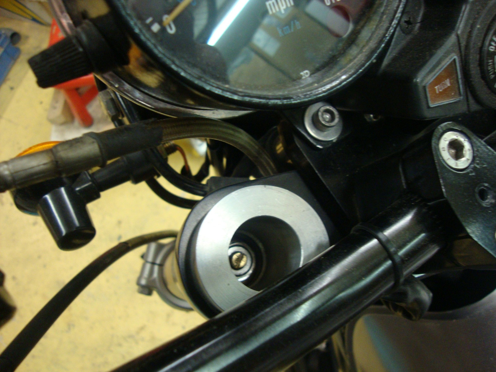

Here are my ZX9R extensions. A Local bike builder machined the original tops down and threaded the extensions,outside and in, so that the internal length stayed the same and the original adjusters could still be used. (A bit awkward to get to but how often do you want to adjust them?). I got them a couple of cm over length to give the possibility to raise /lower them.
