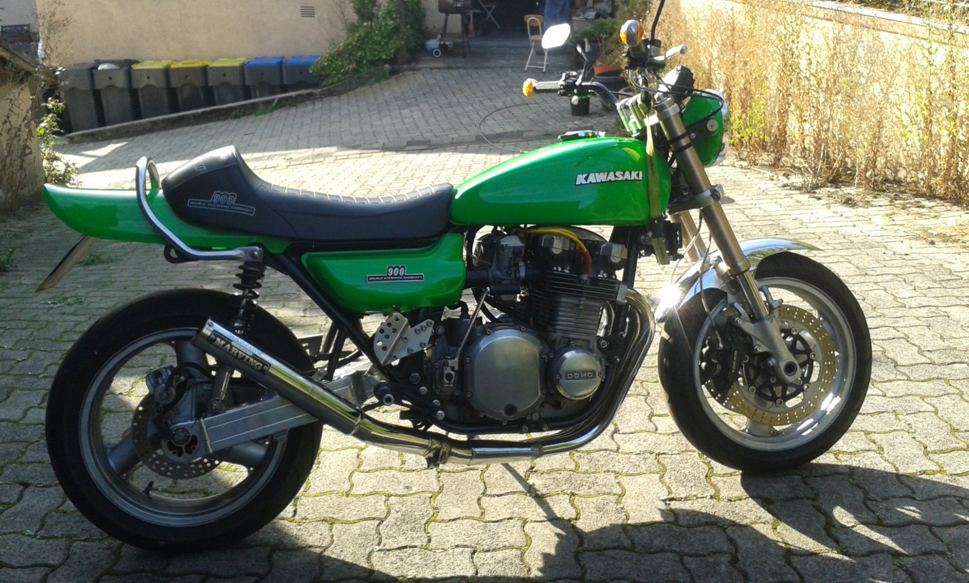

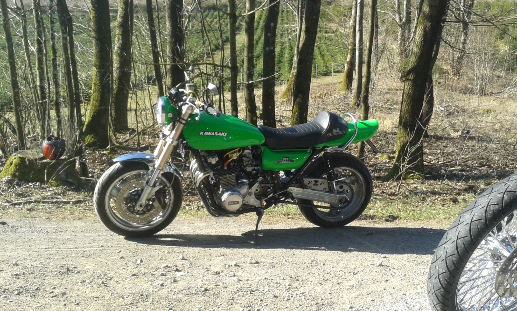

I still have a couple of options for the forks ( zx7r, zx6r, 636, zx9r, zx10r or gsxr1000).
I have a ZX9-R fork and 17 inch wheels and i do riding my bike sometimes really fast on bumby roads. I never had any groung clearance probs.
The bike handling and cornering is perfect and it stears like a train on the track. The only issue is, i wish it had sometimes some more extra power......:whistle: :whistle: :whistle:

A 5.2 inch lowering of the front end only, will dramatically reduce trail. Are you sure that 35 inch measurement is correct, I have a 1982 GPZ750 R1 and the freestanding fork length is 800mm, or 31.49 inches, 35 seems a bit long ...
I did a calculation using reduced fork length on my bike and the trail reduced from 4.04 inches to 3.68, 3.68 is not enough trail, it would be very nervous and prone to tank slappers, in my opinion.. Using your numbers for fork length with my bike , which should be similar to yours the trail went down to 2.92, which would be dangerous, I think something may be wrong with your numbers. Most modern sport bikes are close to 4 inches of trail, that's a number I try and stay as close as possible to when doing these conversions.. The ZX9-R fork Sirocco has used looks longer than the the forks you've quoted. Make sure that when lowering one end of a bike, you do similar things to the rear, I read somewhere that raising the rear suspension 10mm reduces rake by 1 degree, someone please correct me if this is wrong, I tried to find the reference but couldn't, lowering the front has a similar effect, reducing rake. Remember to take into consideration changes to front wheel diameter as well as triple clamp offset, this has its own effect, reducing offset adds trail and visa versa. As I said, to do this properly can be a bit of a mission. Sirocco's bike looks pretty balanced, maybe emulate what he's done. I'm about as anal retentive as it gets when it comes to motorcycle suspension, I try to get things as close to what I consider perfect as I can get, you don't need to be as strict, but there are definitely things you need to get right...
