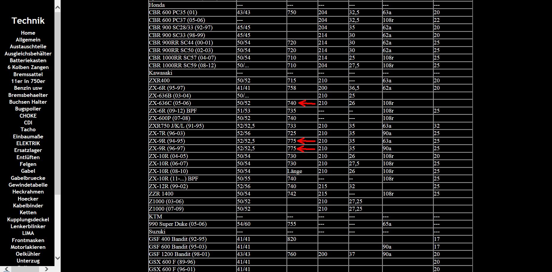

I read somewhere that the ZX 636 has the longest forks of the Ninja family. This may eliminate the need for custom clamps and fork extensions. The mid-90s GPz 1100 also had pretty long forks, but they may be hard to find.

Sorry TexsasKZ but the ZX9-R (94-95 four piston caliper) and the ZX-9R (96-97 six piston caliper) are the longest forks of the Ninja family.

Oops, early 6R at 758 and ZZR 14 at a whopping 742 beat it as well.

How is the measurement taken. Center Line of axle to to top of upper tube?

19 Sep 2020 11:22yes.Mikaw wrote: Sciricco
and zx9 forks can be extended. kzrider.com/forum/5-chassis/611307-lengt...ks-for-zx-to-kz-swap i will have stock ride height on my 78 650 project with zx9 forks.
